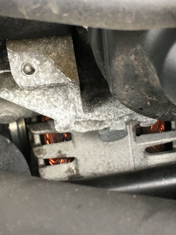

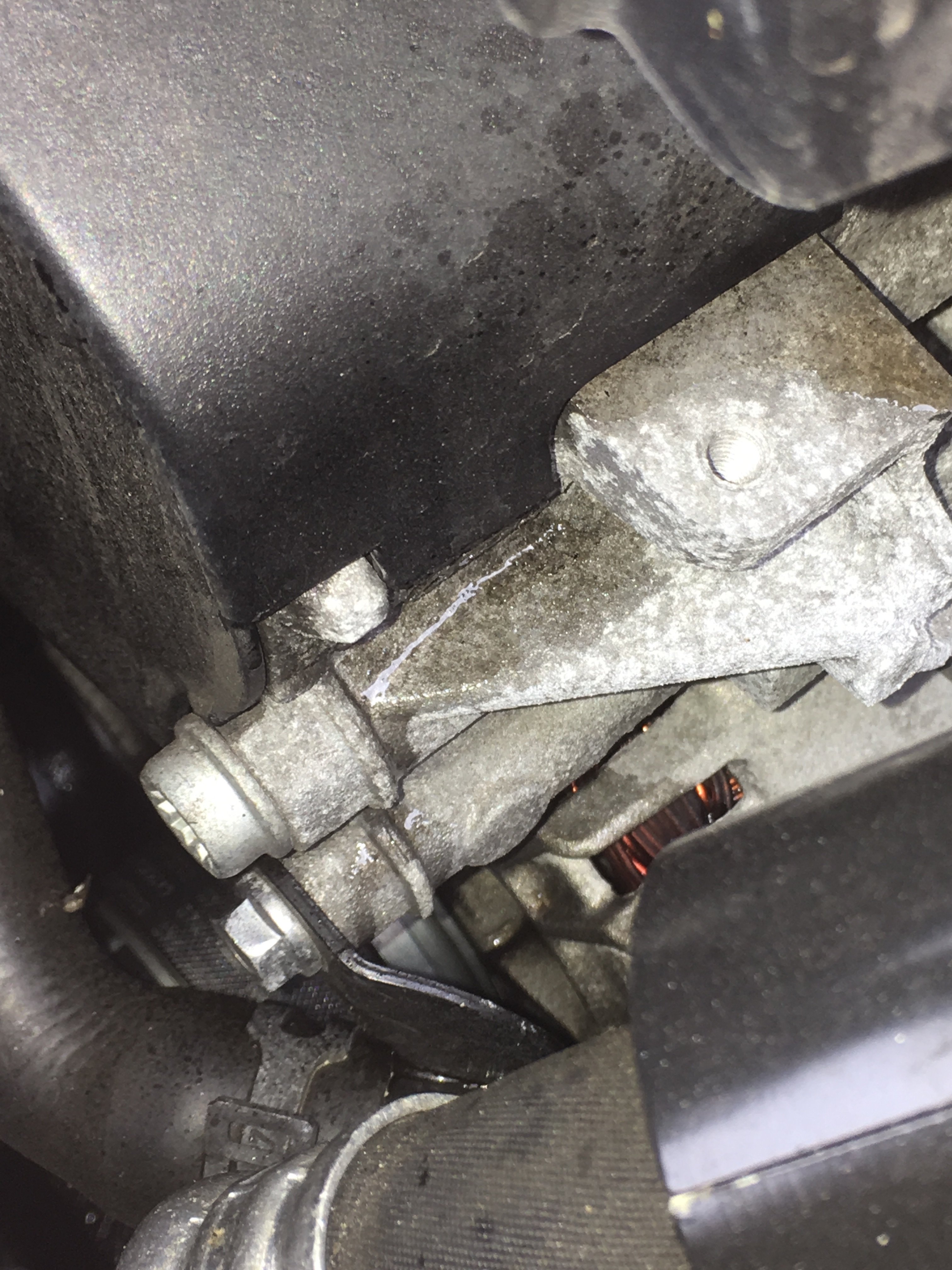

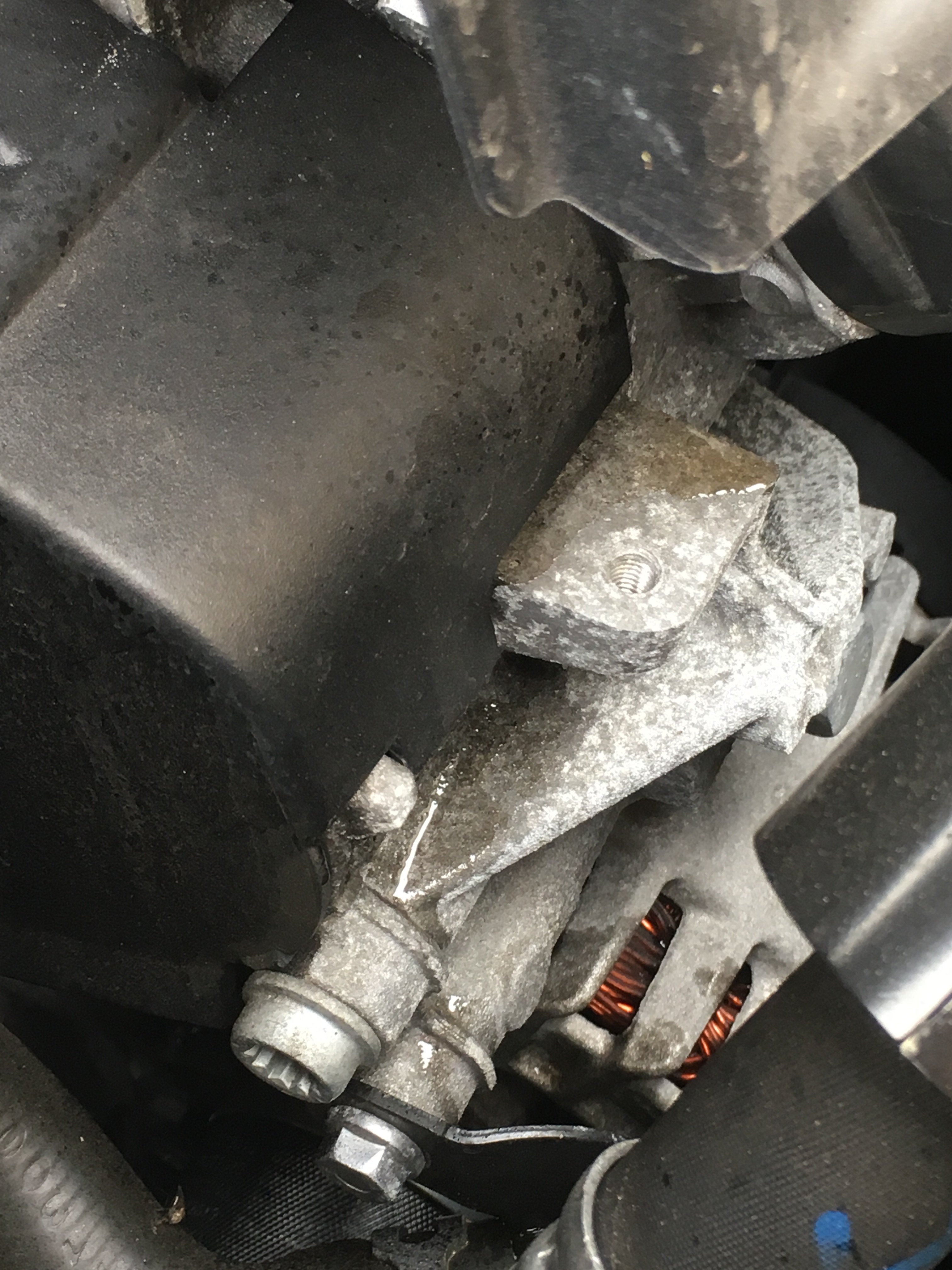

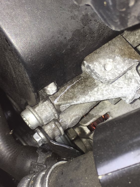

Having looked on here I reckon this is the infamous coolant leak/water pump problem but wanted to get some advice before contacting the dealer in the morning. 2013 Oct 3 1.6tdi, had it since November 2016. Still under warranty. We'd had a previous coolant level low warning 3 months ago after a long drive to Wales (4 hours), not had any problem since until today. Short trip into Cambridge (6 miles), get back into car to come home and coolant level warning light flashes on. Notice wet patch under car but not sure if us as it's a multi-storey car park....on getting home lifted the bonnet and can see coolant all over left hand side of engine and under the engine. The coolant was burning off for a while. I've seen plenty of people on here have the coolant level fall but no leak - this is obviously a leak but question is where's it coming from? Picture two shows a puddle on the engine mount and think it's coming from under the plastic cover. I'm mechanically inept so any suggestions I can put to the dealer based on the images would be greatly appreciated. The dealer is 19 miles away and I don't fancy driving it all that way with this amount of coolant leaking. Many thanks, J.
Isn't the water pump quite a bit lower on the engine than where this water is?
Is it definitely coolant?  How low is the level in the expansion tank? The fact a warning's come up in the last six miles doesn't necessarily mean it's just happened - you could simply have a very steady loss over the last three months.

Does sound like you might have a hose or joint giving out.  Is there any evidence of coolant around the header tank?
Has your temperature gauge sky rocketed?
It's probably worth topping the header tank back up, going for a run around the block and then having a good look (not saying you haven't) as soon as you get home.  If it's spraying the wheel arch, it shouldn't be too hard to track where the spray is coming from - the coolant system will remain under pressure for some time after you've turned the engine off.

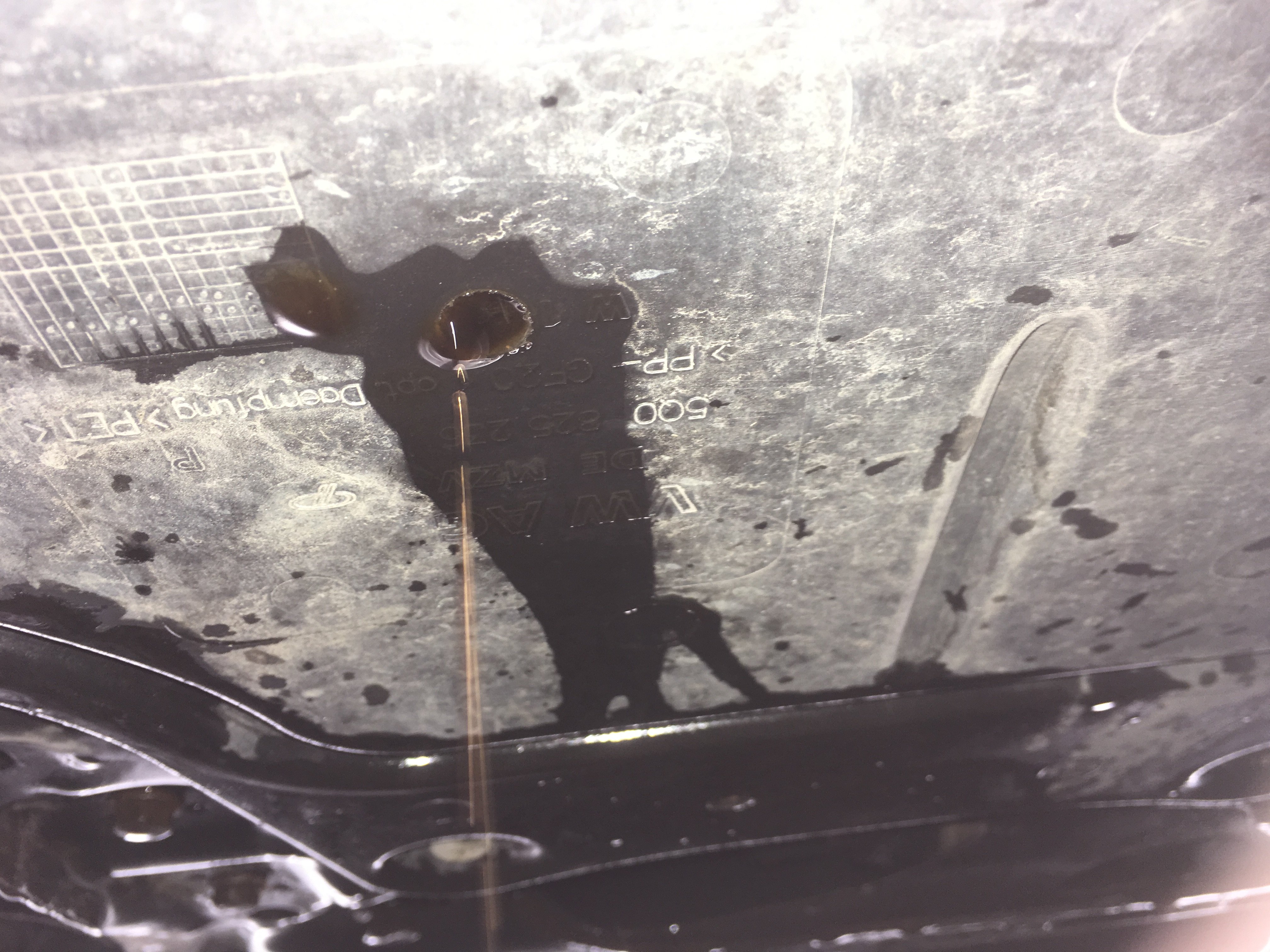

Filled the header tank, went for 5 min drive, header tank now empty and what I assume is coolant (changed from green to brown colour?) is now flowing steadily out the bottom of the engine through a drainage hole in the plastic under protection......no idea where exactly it is coming from. Definitely need the dealer to pick the car up for me!
Yep, that's definitely a don't drive it any more type of leak!! :o
