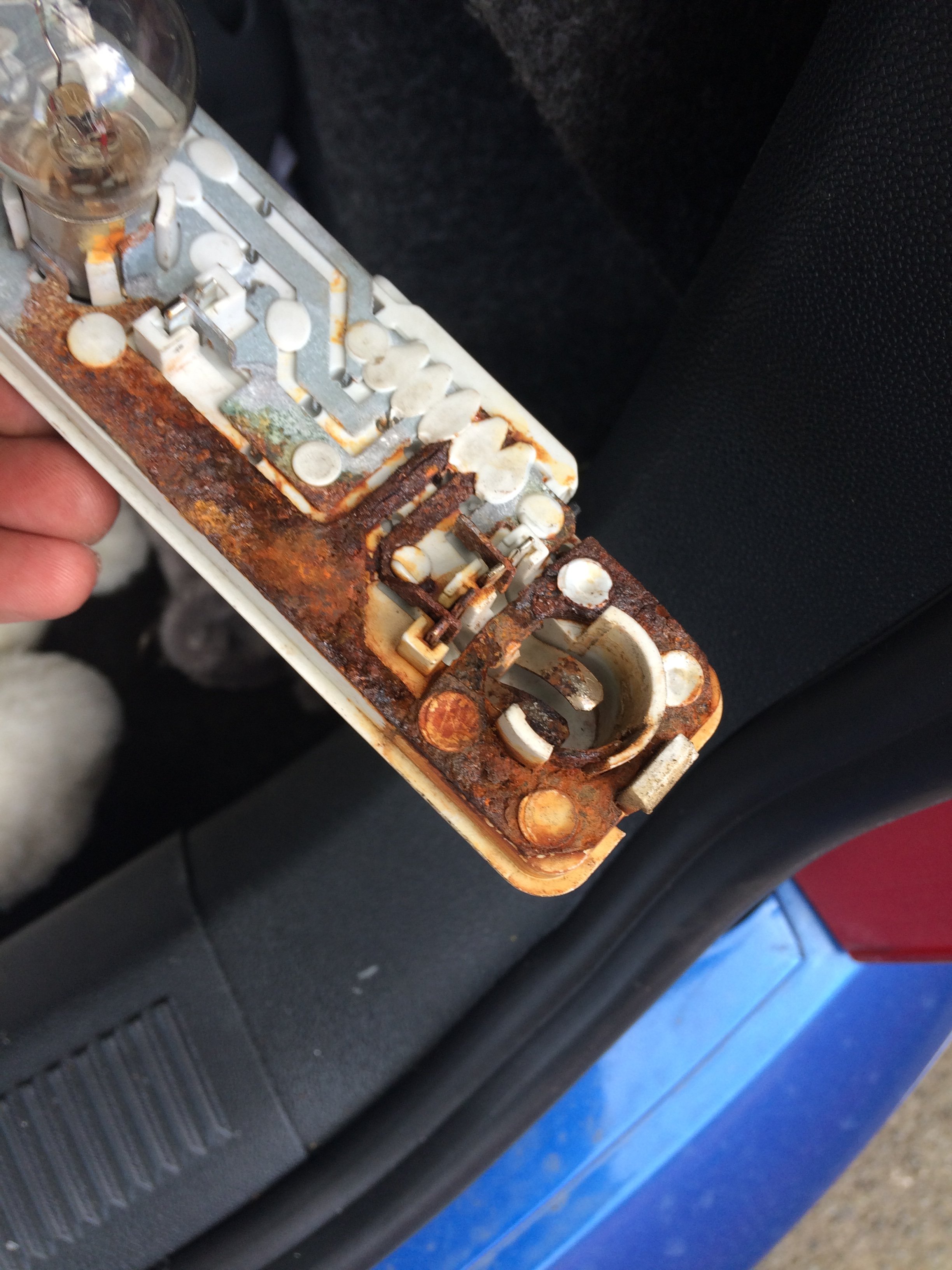

So, with regards to the bulb warning light which should come on when a bulb is blown. Here is my findings..... Every time when braking, I would get the audible ping and the orange bulb with cross light coming on which done my head in. I checked the lights more times than I can remember and never found any issues. Until I had some spare time to look further!! I had in my head that the switch was faulty but thought I would check all bulbs first, as seen in the pic, I found this at the o/s/r cluster. One of the bulb connections crumbled away when I touched it. This drain on the lights was causing the warning light to illuminate. Tbh I'm just happy I found something.....trip to scrappies for me. Oh and I would be thinking about covering this electrical connection with some plastic film to prevent water getting to it. The joys.

That would explain it...
Need to find where that water is getting in and stop it, rather than just shielding the connector, I think.
Wow that has really turned to crap! Seeing as the brake light is the lowest one in the light cluster it looks like it's been holding water.
Yeah your right wino, I will be getting a new holder then looking into this as it does look as though it's been sat in water as opposed to getting dripped on. TMB your spot on, it was a surprise how crap it looked.....but hey I sometimes like actually finding something obvious..... I will report back any further findings, cheers guys

Guys, had a look again today and not getting bulb holder until tomoz but inside the cluster there is signs of (greenery) defo some kind of water ingress. MOT tomorrow and left till last minute as usual for me. Will get it working then look at future prevention of water. Great fun. Burst cv boot also aaaaggghhh

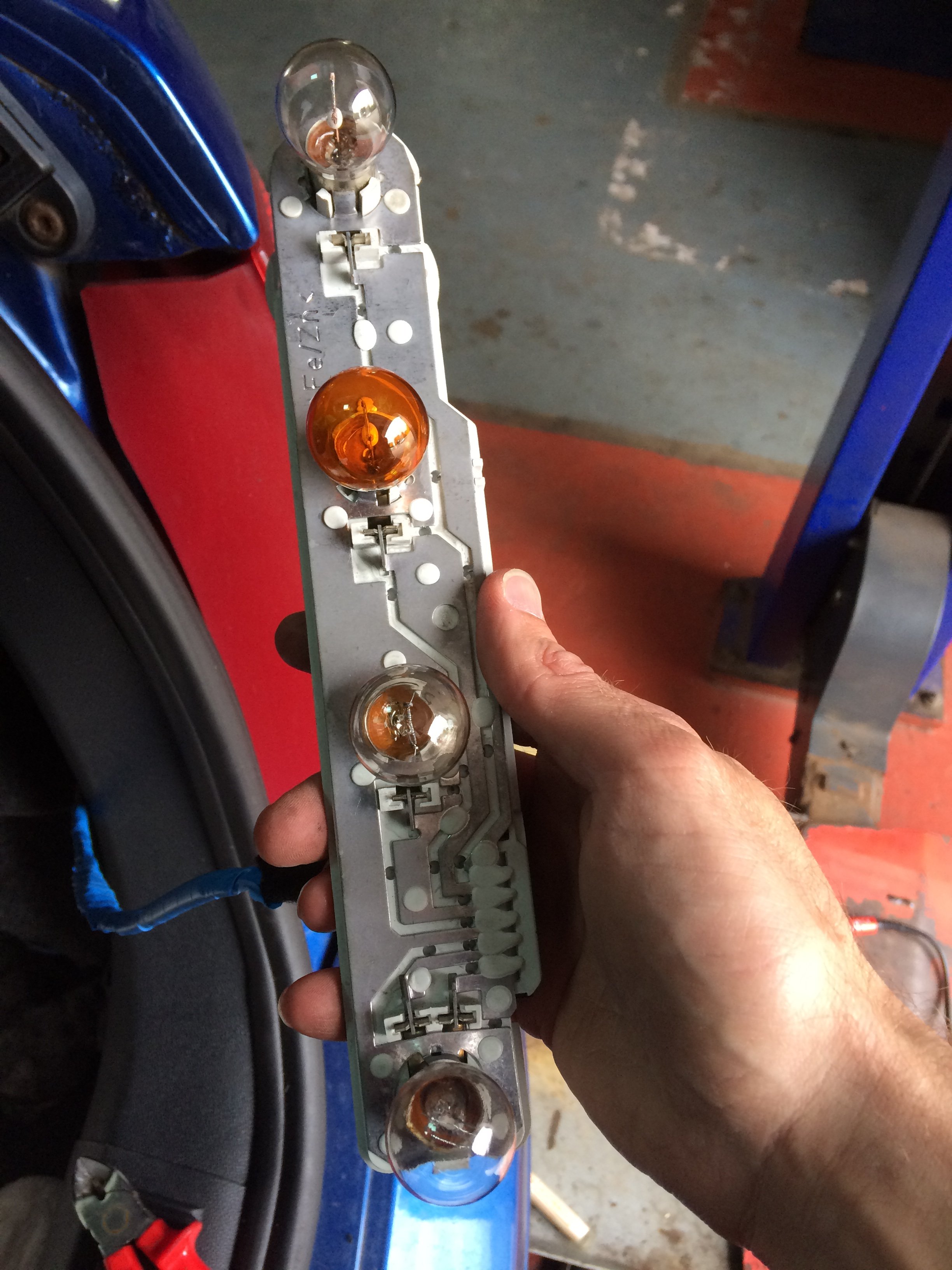

Not that I'm aware of mate, I replaced the bulb holder and wiring today(5 quid at scrappies....bonus!) and noticed one of the bolts securing the cluster to body is missing so I will remove it over the weekend and re-seal and secure. Passed MOT so all good. I will post here any further findings. Cheers ladsimage.thumb.jpeg.4f149c38dbf211c03fc9b37ef6954c7c.jpeg
