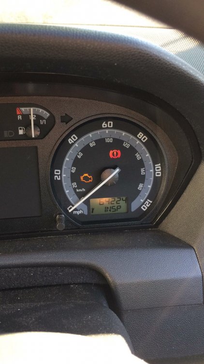

Evening all. Junior is driving in Ireland in his 1.2 htp fabia estate. He has just reported earlier today that the service reminder symbol has come on, then a few miles later the engine management warning light came on. Car seems to be running fine.
I would rather wait until he comes back next weekend to get the fault codes read, but did hear of a case where it is claimed this sequence of symbols was eventually traced to a faulty brake light switch. Any ideas, urban myth or should I be concerned?

If the yellow warning light which says "EPC" is the one that came on, that often is due to a failed brake light switch, if it is the one that is a picture of an engine it won't be.
Service reminder is completely unrelated.

Folks, photo added

1 minute ago, ARWP said:
Folks, photo added
tks
A
As I said...

@ARWP - Is this a good place to point out that the "INSP" warning doesn't randomly "just come on"? It will have been showing "Insp in N00 miles" (where N is range 1..9) for the last 30 days or 1_000 miles, whichever is the shorter time period!

A quick update, we drove the car back from Ireland yesterday, after about a hours running at 60 mph the yellow warning light went out and has not reappeared. The car is running fine, 48mpg on the run and no apparent loss of performance throughout this episode - I figure with only 64 BHP to start with any power loss would be immediately noticeable. I guess the ecu has stored the fault code so I'll get this checked in due course.
