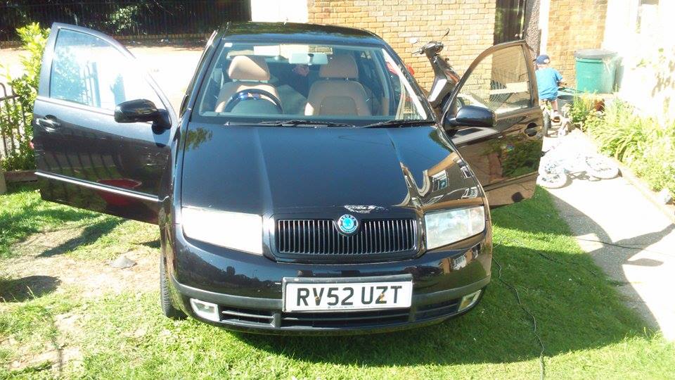

hi im new here i wanna no if there is a turbo that will fit mk1 fabia 100bhp 1.4 16v i no people will slate me for it but i love my car and love that its petrol and vrs isnt my cup of tea being a diesel however they do look great

thanks for all your replys glad can get good advice mabey turbo this little car is a bit to much money i only paid a 10er for the car but she dose me fine fabdavrav think i may go the way you suggested dose anyone no why when it hits red line between gears it bogs down and can  i change this in anyway i am new to all this not how to do certin bit on cars but not everything yet lol
