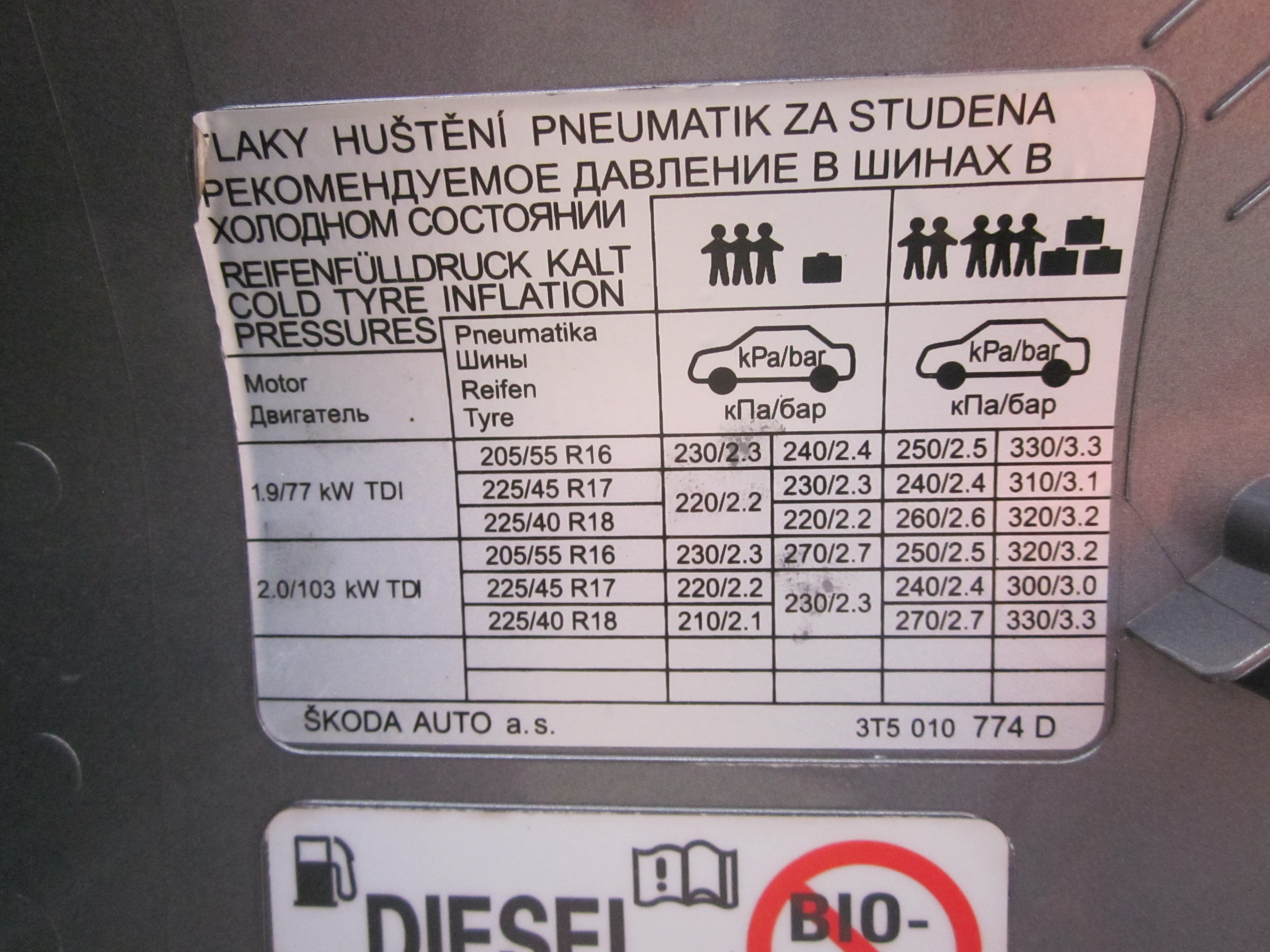

Thanks a lot! Maybe i am looking at a wrong place. Can you tell me where you checked that so I don't ask stupid questions for future. :)
That information is taken from Skoda's service manual which I purchased from erWin.

Yeah I see that lable on the fuel cap, but it doesn't say what is the load index and the speed one. :)
