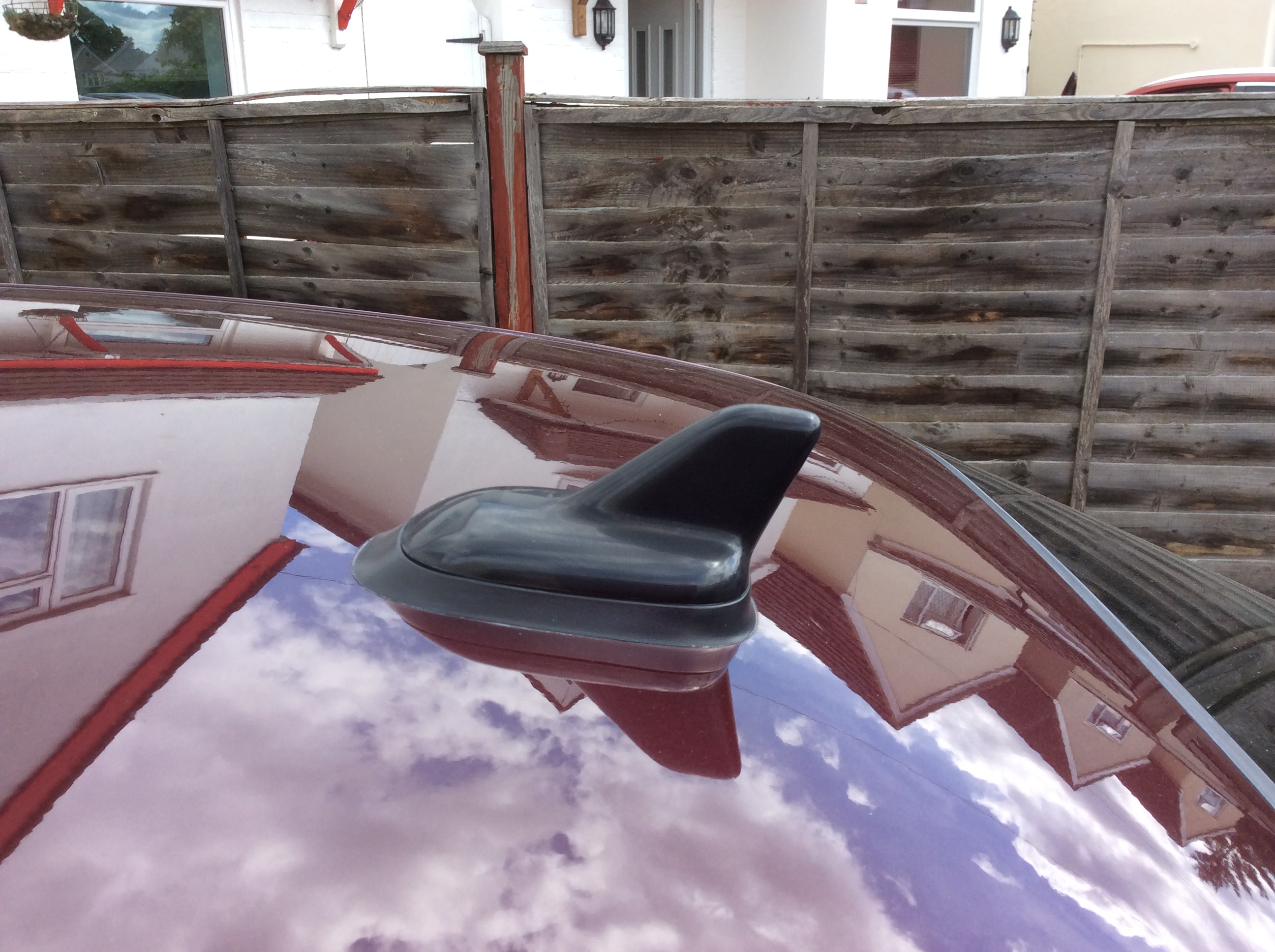

What aerial do you use at the moment?
The factory fitted (shark fin) one.
Kevin
Got a pic of the actual one on your car please.
Here you go.
kevin
I don't think you have a DAB aerial in the shark fin. I think the aerial is either in the side window or the rear screen.
I too have a DAB, an upgrade supplied by Rustynuts, clever man and a great piece of kit, this uses an additional Aerial at the rear of the shark fin and I can confirm that DAB is patchy, indeed it is always poor in built up area's and even certain open field areas along the West Oxford A40 there are a few spots that are dead due to the overgrown foliage. Although DAB has more stations with greater choice the whole digital experience is not as good as FM but hey that's progress.

I upgraded his non DAB Columbus to a DAB unit in a part exchange. I also supplied a new roof antenna as his car didn't have DAB originally, that's all.
