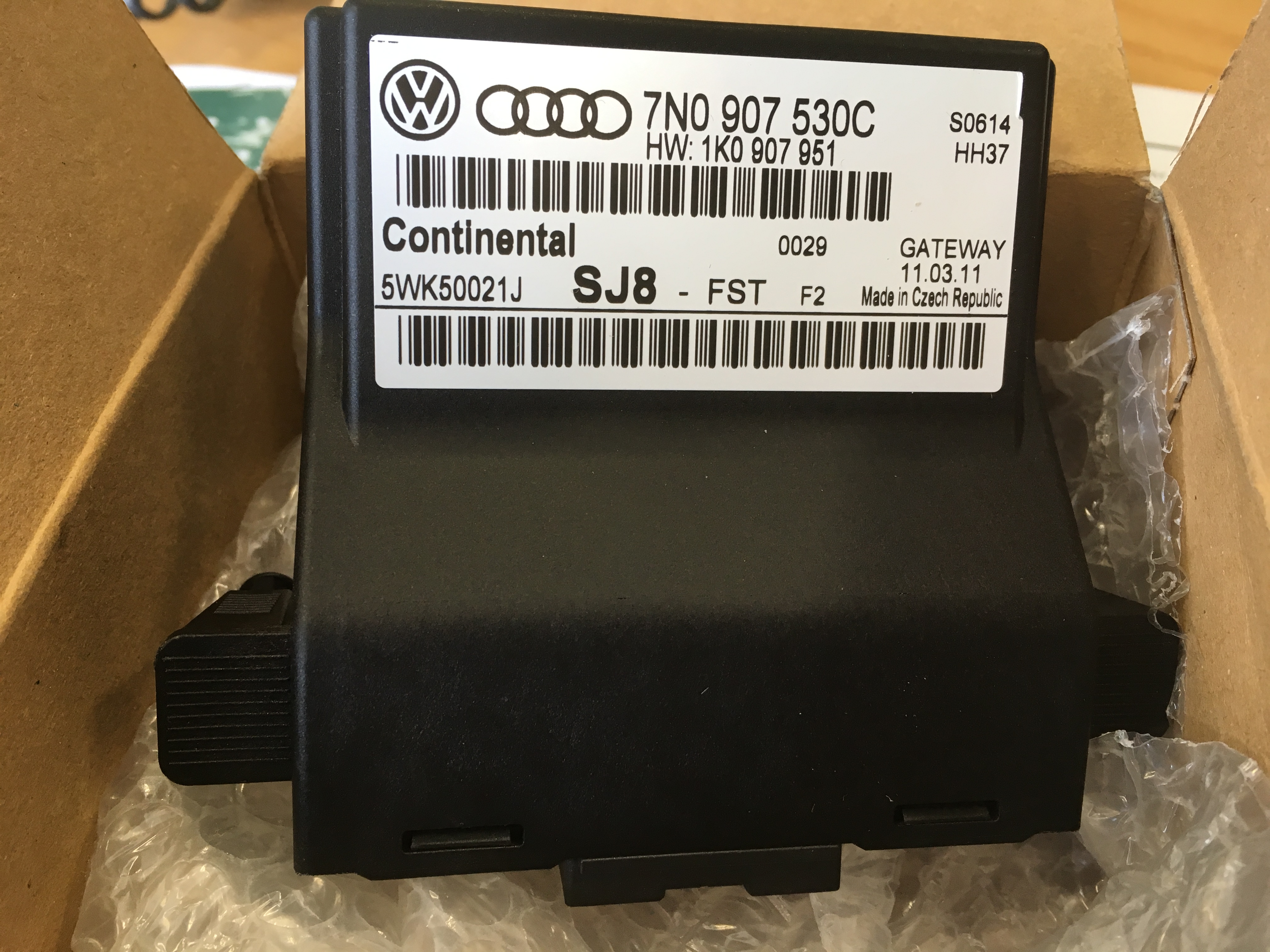

A big thank you to grumpygreg3269 who did a sterling job scanning the car. It threw up some unclearable fault codes with the Bluetooth, Infotainment, radio and navigation systems.
It went to Unit 20 in Neston for a service last week, the eBay module was coded in and worked fine and then the faults started again. The diagnosis was a faulty Can Bus Interface Module, when Unit 20 spoke to their supplier it turns out that there have been numerous revisions to this part, so it may have been troublesome in the past.
It is back at Unit 20 today for the fitment of the replacement module...........
Picked it up last night, all fixed and back to full working order - here's a picture of the culprit!
