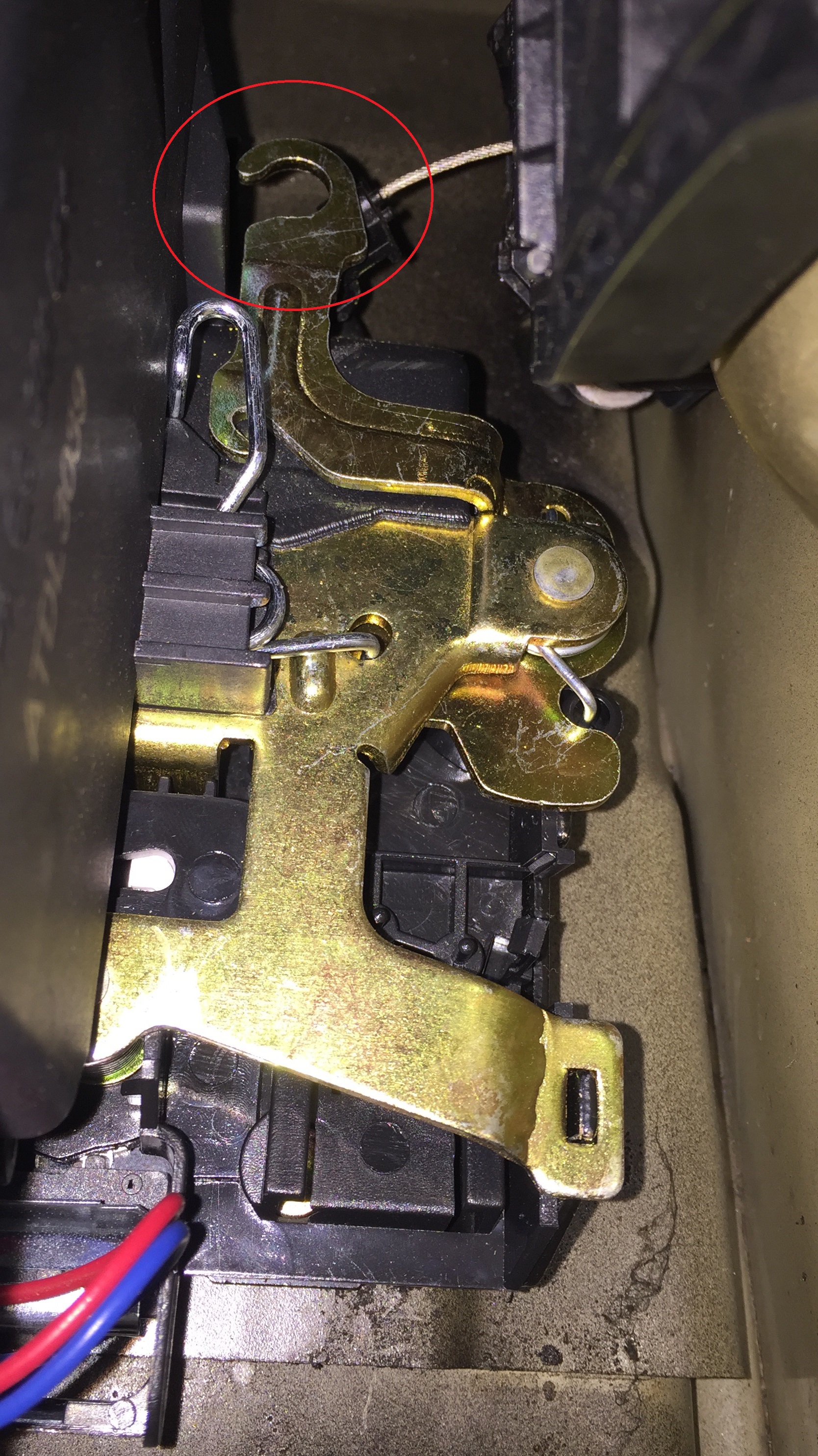

@w.t100 @valvedoctor46 you cracked it. Thanks for your help!
I hadn't located the lug at the end of the cable correctly which caused the lever to be slightly open. The lever moved back a fraction as soon as I removed the lug/bowden cable and the lock operates as normal.
Now next job is how to get the lug in the hole correctly. Any tips?

I need to get the cable fitted into this hole :-
The lug is half-moon shaped so it needs a quarter-turn to engage properly. There is not a lot of room in there - do I need to take the door handle off?
Yes, looks like you will have to take out the lock barrel. Once the cable is attached you will need to adjust the tension at the handle on refitting.
