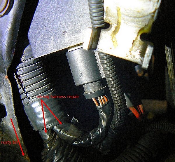

i found a local proper AUTO ELECTRICIAN...most of the other ones that came up but really were domestic ones which google (auto electrician near me) picked up

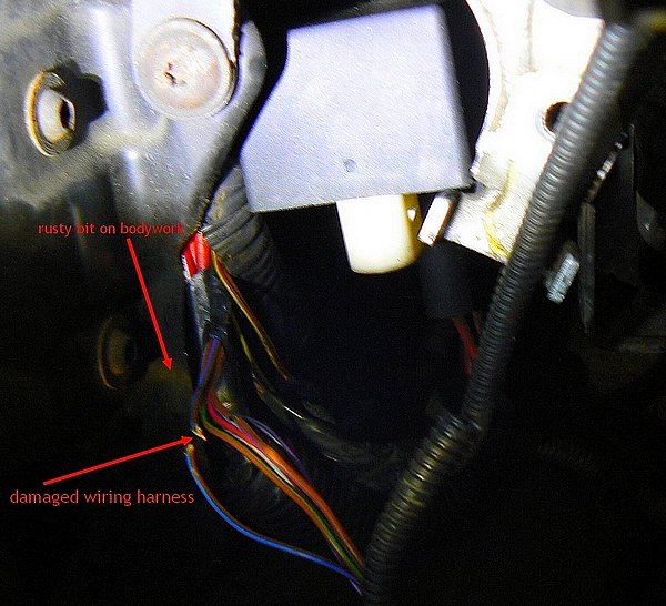

the chap is a mobile engineer so he was working in my garage nice and dry....he gave me a run through what he would do...i left him to it for a bit then he called me back and showed me the results....all clear except for a closed ciruit/earth on the fan controller which he would investigate...soon he called me out to the garage again and had located a damaged wire bundle near part of the bodywork showing rubbing/corrosion/and verdigris on the area where the bundle insulation had been rubbed off over time and vibrations.  it was behind the left hand fog light,  just below the fan controller....how he knew beats me...experience and deduction??
later he called me out again after doing a harness repair and ran the diagnostics again for me and got all clear for the whole car..
he took two and a half hours to do the whole job and took £45 per hour...which is the local rate...he just lives round the corner would you believe!!

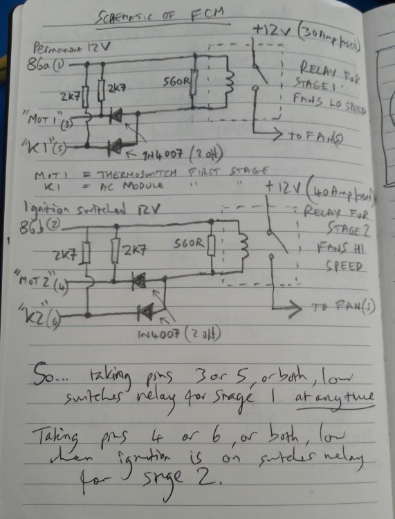

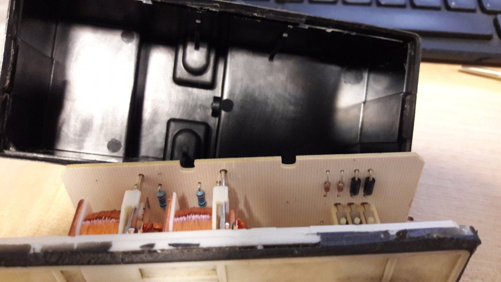

    Two actually. One for low speed operation, another for full speed. Both reside in the fan control module. If the problem isn't water ingress shorting stuff, welded contacts is probably the most l
