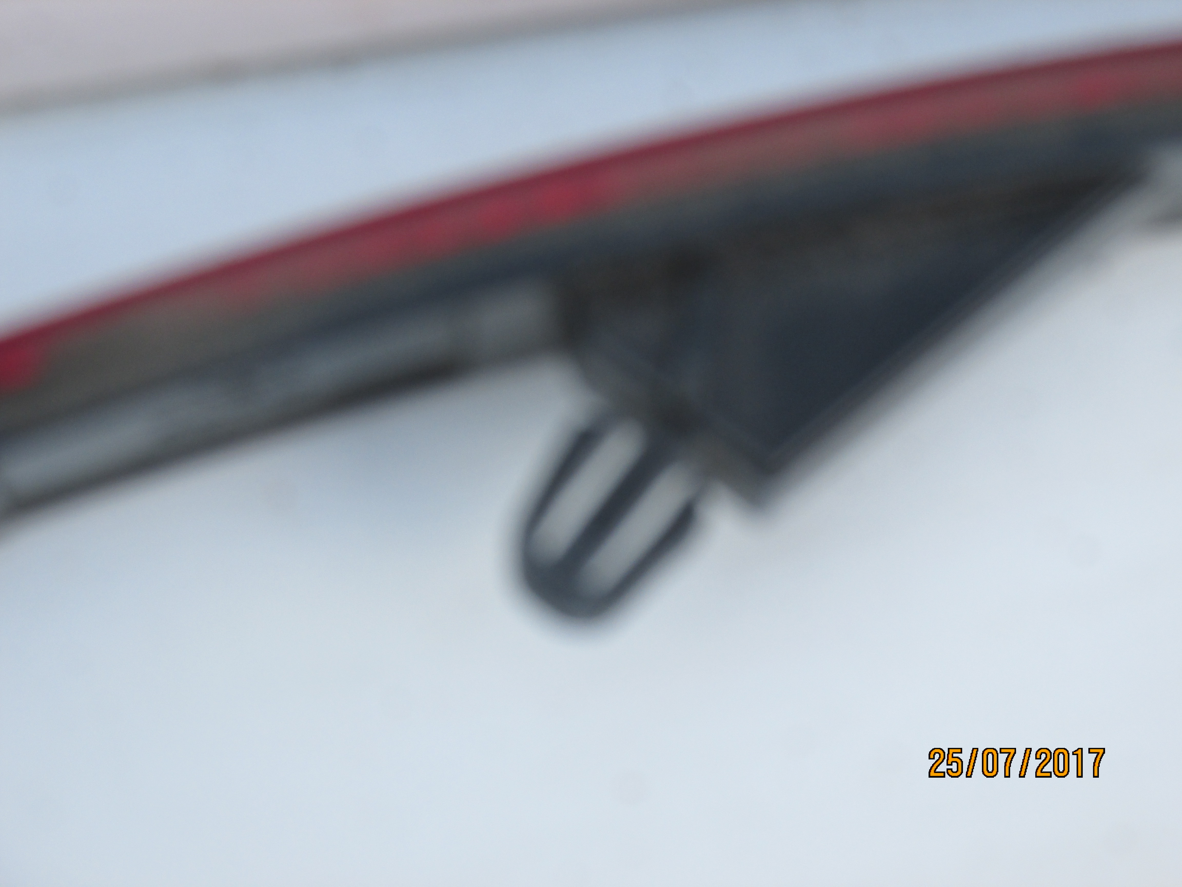

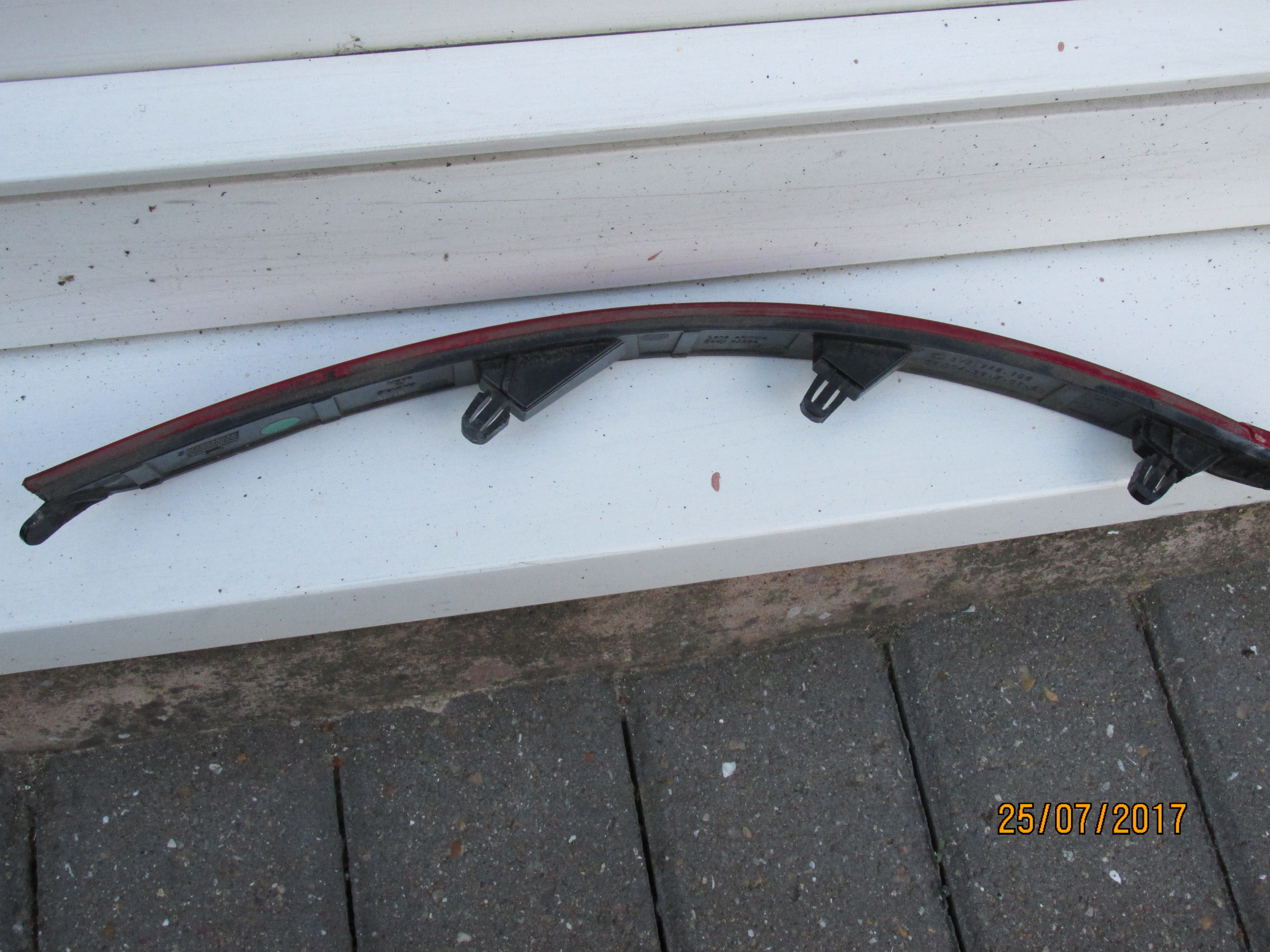

Hi Nermaloids, Had to lie down on the ground to get to the reflector, you will need a torch and a pair of pliers to squeeze the two prongs together and push outwards, once its loose the rest should come away quite easily. couple of pictures below so can see what I mean about the prongs, one of the pictures isn't great but it gives you an idea what your looking for.
Your best bet would be to try for the prong nearest to the boot or middle of the car then get your fingernails under the reflector and hey presto job done, the new one just snaps into place.
