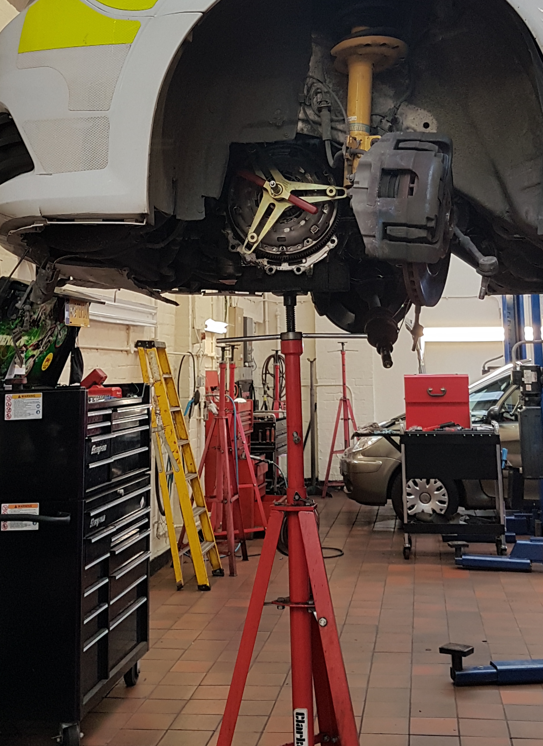

Make sure if its a self adjusting clutch being fitted that they use the correct tool to fit the clutch

The 2.0 diesel 6 speed can be fitted with a concentric clutch slave cylinder (inside gerbox around input shaft) . If so change this at the same time whilst the gearbox is out as these can/do fail (especially when disturbed) and it's another gearbox out job to replace. If you are doing as part of a clutch replacement it won't cost much more ( I think it may come with some kits anyway)
Personally - I wouldn't use a Sachs clutch kit as in other cars (Superb II) there have been numerouse reports of the original Sachs pressure plate failing and machining through the gearbox casing

Special tools are required for the clutch /DMF fitment
Well, are special tools required or not? Everyone else seems to tell me it's a straight job...
Can some one give the difinitive answer so he can get on with fixing his car please. Specialist Tools or not.
Luk clutches have a red warning sticker on the box warning you that you need the sac tool,  Sachs dont. I always check the inside of the clutch cover and you will see a spring and a part of the mechanism. It may be worth asking the supplier if its self adjusting. There could be a good chance it isnt. Thats what the tool looks like to compress and line up the clutch while you tighten the bolts.
So the tool is necessary if the clutch is not self adjusting, correct?
What about the CSC - does that require any special tool to be replaced?
