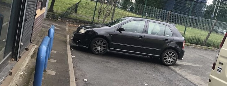

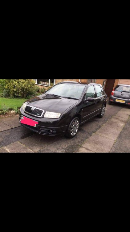

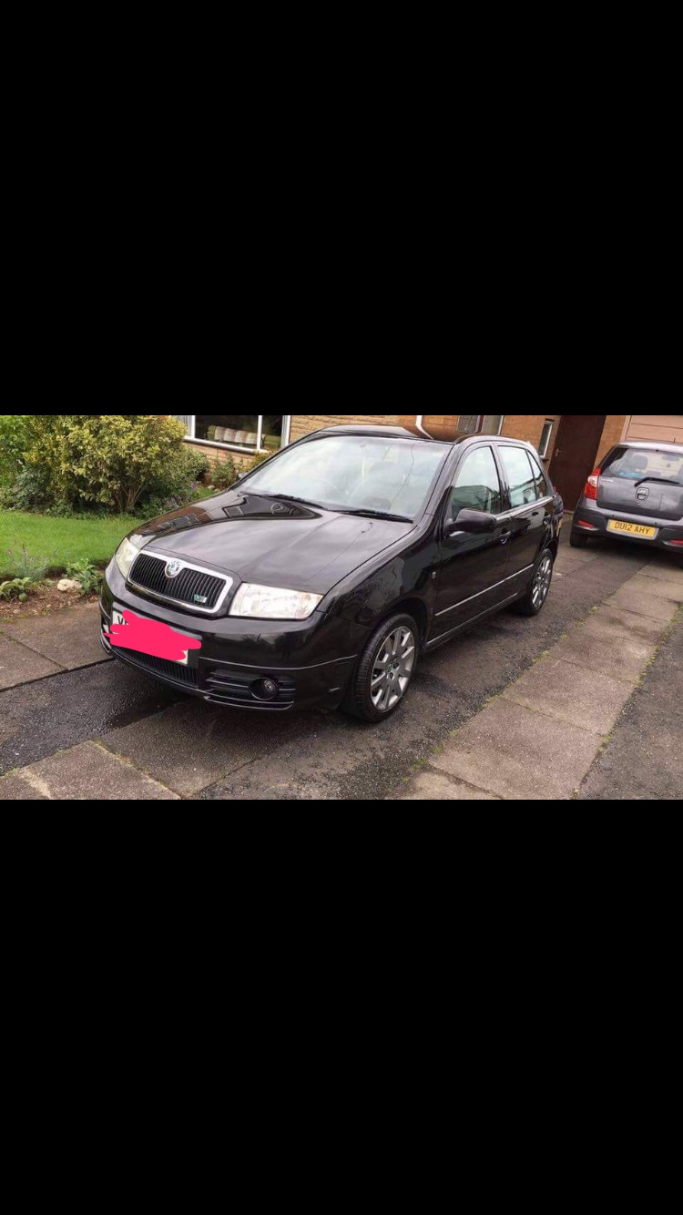

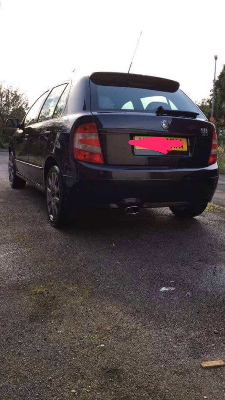

I have just purchased a 2004 Skoda Fabia VRS in Black and wanted to start a thread detailing the mods i'll be doing.
it has already been remapped by the previous owner so I'm getting around 170bhp and 230nm torque (need to get it on a rolling road to get the exact figures). But plans for the future are as follows. (If anyone has any suggestions please post them and i'll see what I can do )
Mechanical / Performance mods
- coilovers (don't like the size of the wheel gap so that needs changing!!)
- full cat back exhaust system
- air filter
-  stage 2
aesthetic / visual mods
- tint rear windows
- rewrap spoiler
- respray brake calipers green
- debage rear
- smooth bumper
- stickerssssssssss (only a few with taste though)
- respray wheels (not sure what colour yet)
- detachable steering wheel
andddddd thats about it for now, if anyone has any suggestions or things that have worked well for them please let me know! But for now, enjoy some photos of it in its current glory!!
