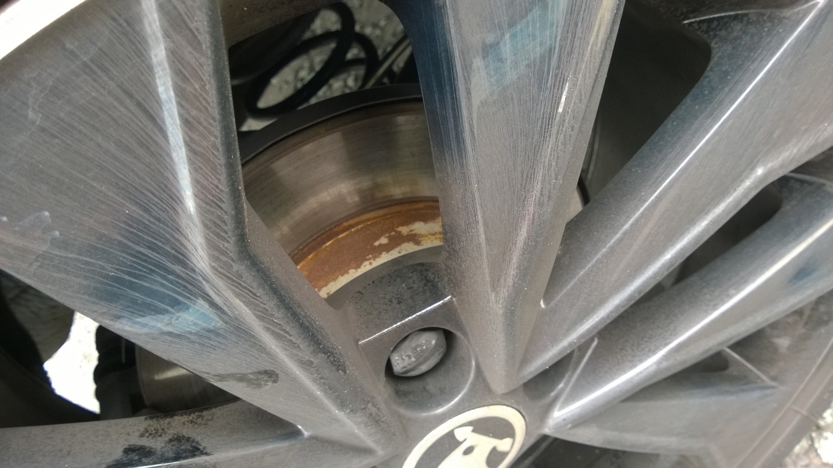

So the wife has kindly pointed out that her 16 plate is beginning to rust on the section before where the wheels attach (not sure what its called), any idea''s how to get rid of the rust.
She has a good point if these bits are rusting what else is?
That's the front disc
Never seen a car that has  not rust there
Only time they don't rust is in the showroom
Edited by malcster
Yep - as @malcster says.
Cast iron/steel parts will just show a layer of oxidation (which is what rust is).
You'll see it there, and on some suspension parts. Castings are just like that. They don't rust through unless you have a hundred years or so to spare. It's not like sheet metal rusting. That will rust through OK.
If you leave the car idle for a couple of days, you'll usually see a light rust/oxidation layer on the brake discs too.
Nothing to worry about. It's a feature !

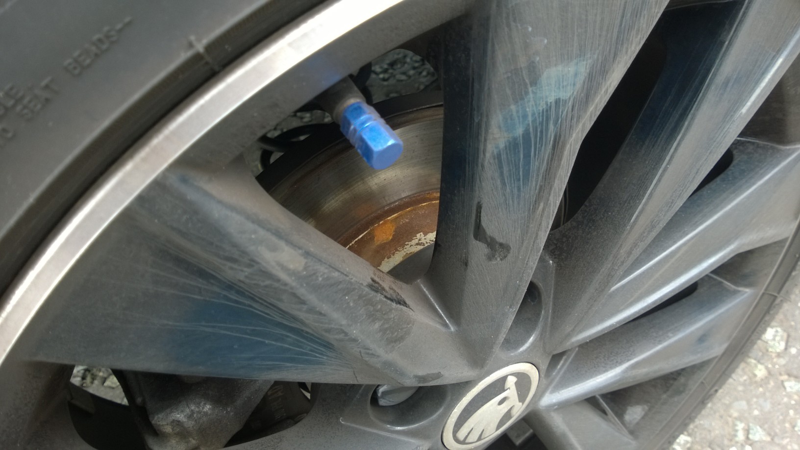

Mmmmm...............Race Blue Valve Caps.
You mean "hope that some anti seize grease has but put on there"  - as in if not, and if that car gets its tyre pressure checked as is "normal" (once every 6 months), then in a few years time, these valves will be stuck on.

yeah matches the rallye green one on mine, have squirted all the caps with some T Sil found at work https://www.randjbuildershardware.co.uk/buy/t-sil-release-agent_1066.htm
my green ones were solid after 2 weeks!

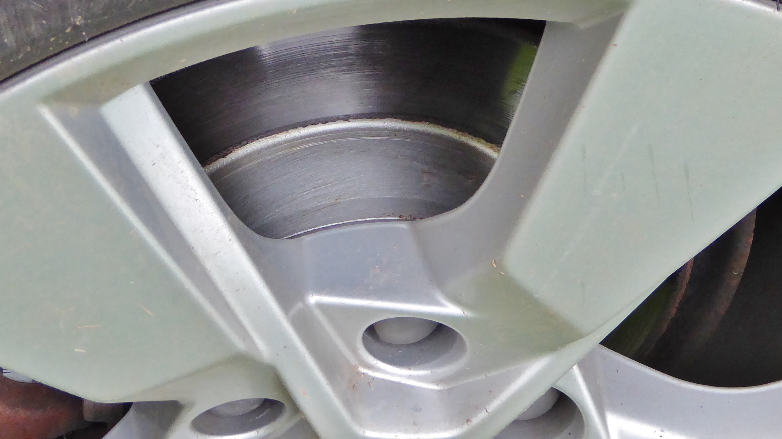

I repainted mine with silver Hammerite (smooth), after a rub down with a wire brush. Didn't bother with a rust treatment, given the parts are finished/cast quite roughly in the first place.
My efforts below:
