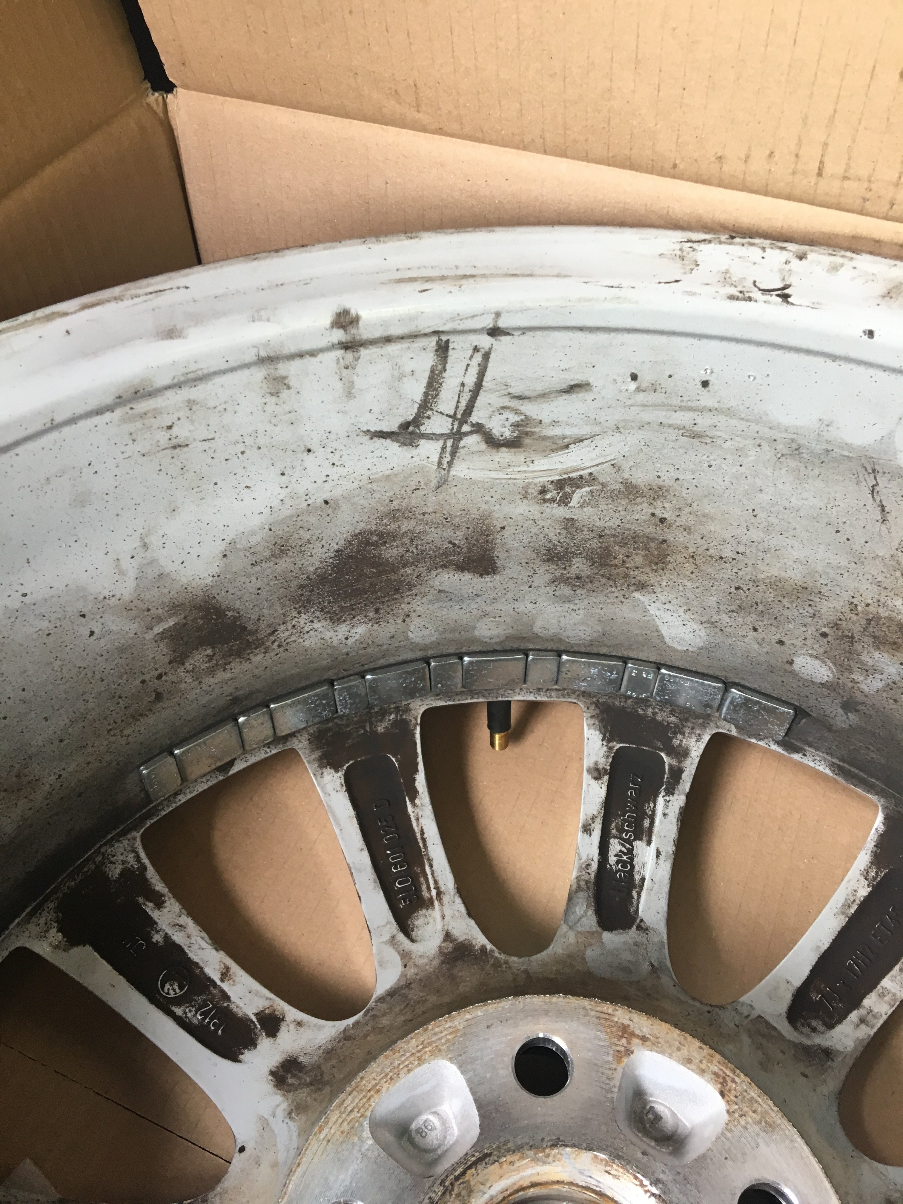

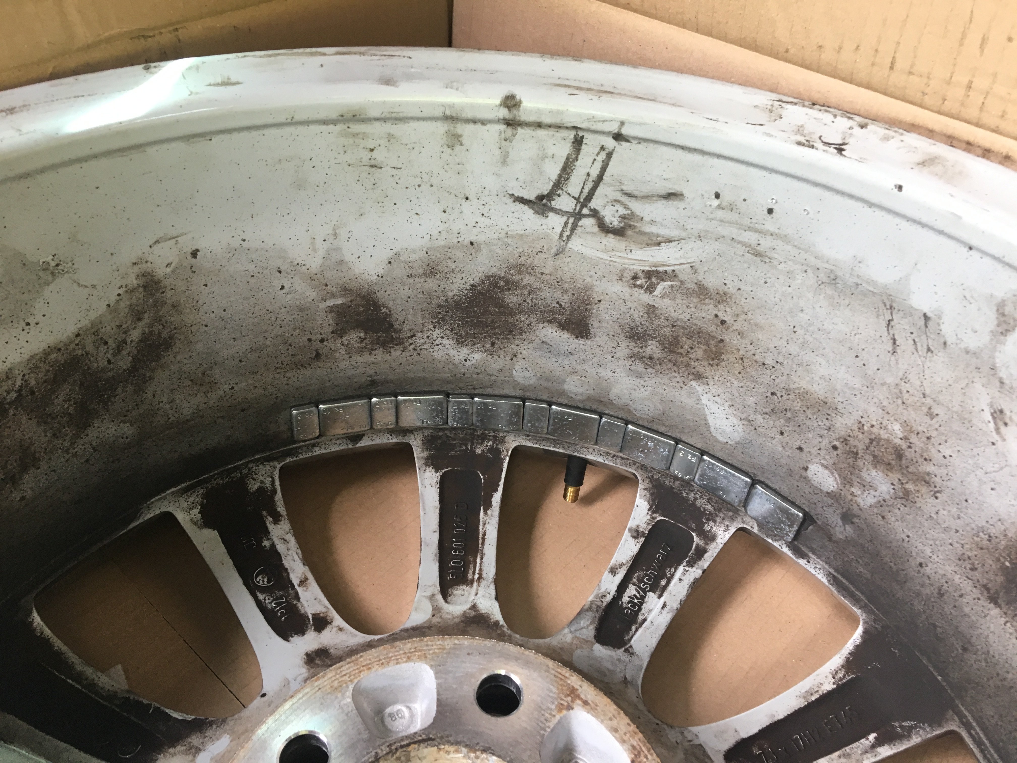

The wheel that was replaced. How many weights to balance a wheel before you conclude it's knackered? Two tyre dealers thought this was acceptable!

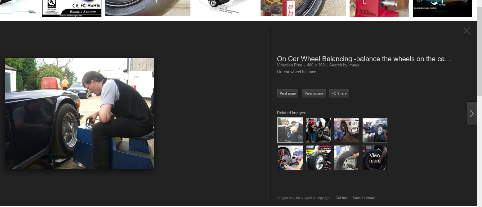

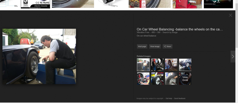

zarniwoop..........havnt seen one for a long time but I always had my wheels balanced on my old cars with the car jacked up and a mobile balancer pushed up to the wheel and rotated it,check the balance and weighted.was always a better job.......proberly stopped due to H AND S
Agree 100%. It was a side on view, with the guard up (no doubt breaking H&S rules in several places) that revealed just how deformed the new Avon was.
