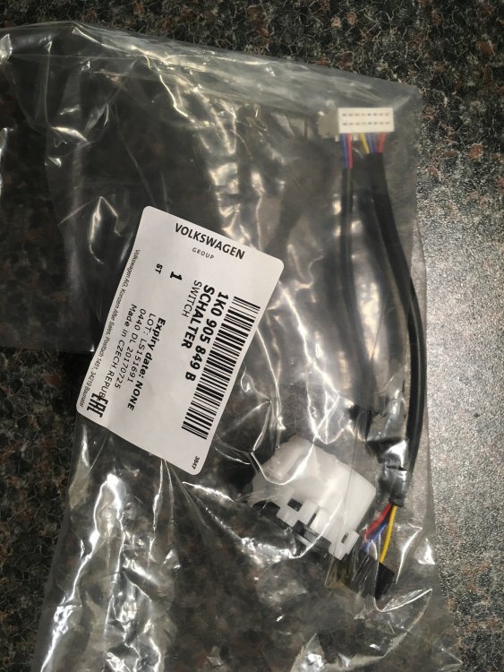

I have this problem bought a 1K0 905 849 B today.

Thanks, you just saved me replacing the radio!
