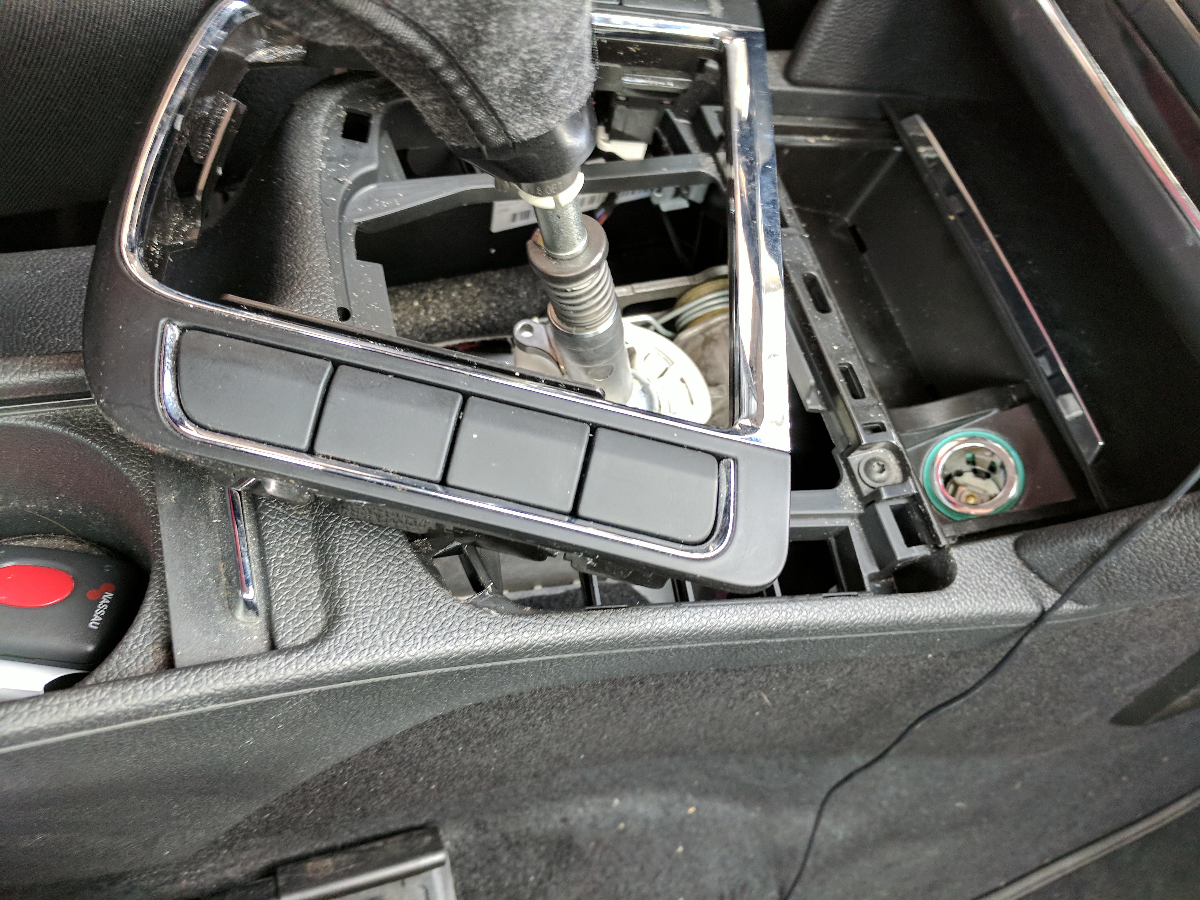

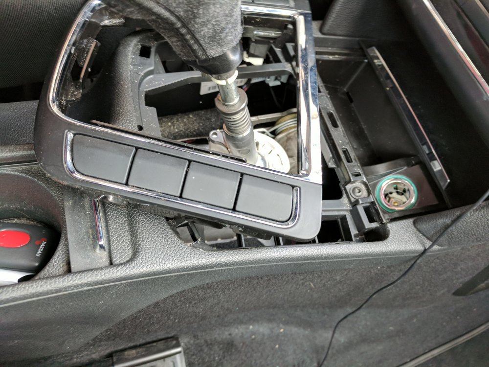

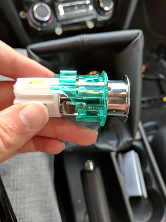

I remove the trim, starting with the shift lever gaiter, then the buttons + frame around the lever. Then you get to 2 screws and you can remove the ashtray ( removed most of the trim using old credit cards ). Removed the ashray and removed the lighter socket ( not that easy, but it slides apart and I didn't care if it's damaged. )
I did have to cut away a tiny standoff in the socket hole to fit the USB socket, but it fitted nicely.
The lighter connector  has, 3 cables, (neg, pos, and light for the ring ). I don't want to cut off the connector so I'm gonna get 2 female clip sockets that plug in the existing conenctor and connect the USB socket that way.

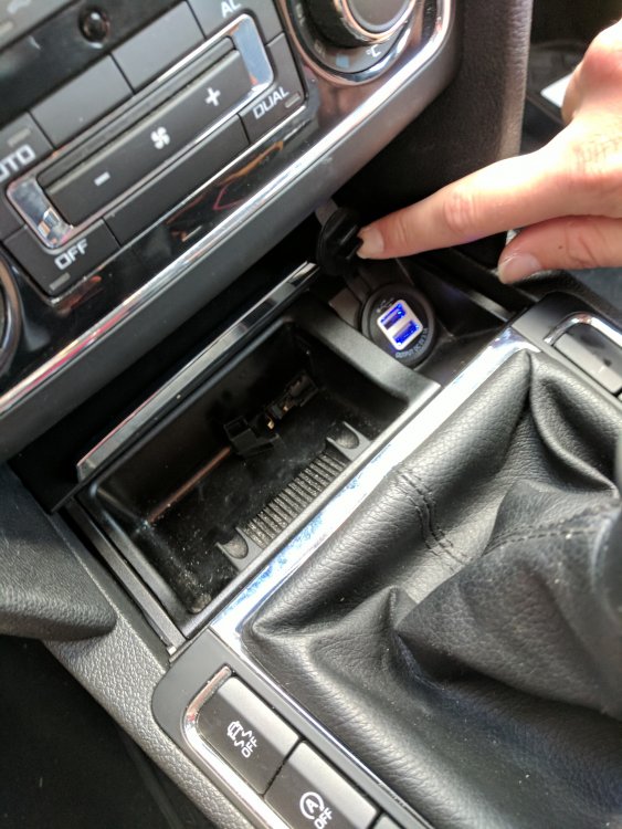

Done ...

Did you buy the USB port without the wiring loom/fuse, and if so did it just plug straight into the existing wiring?
