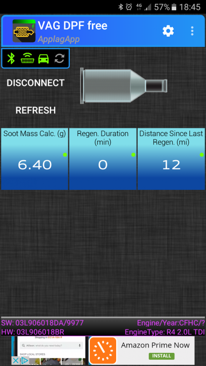

Got a free DPF app and it said last night 10grams of soot, started smoking on the way to work today, and finished on the way home tonight (see video)

Is it normal for it to regen as often as it does- 30 odd miles between, if the DPF is on its last legs would it do this, I have had no fault codes, no warning lights, nothing, just  sometimes increased fuel consumption (39-41 mpg per tank) circa 420 miles to the light.
