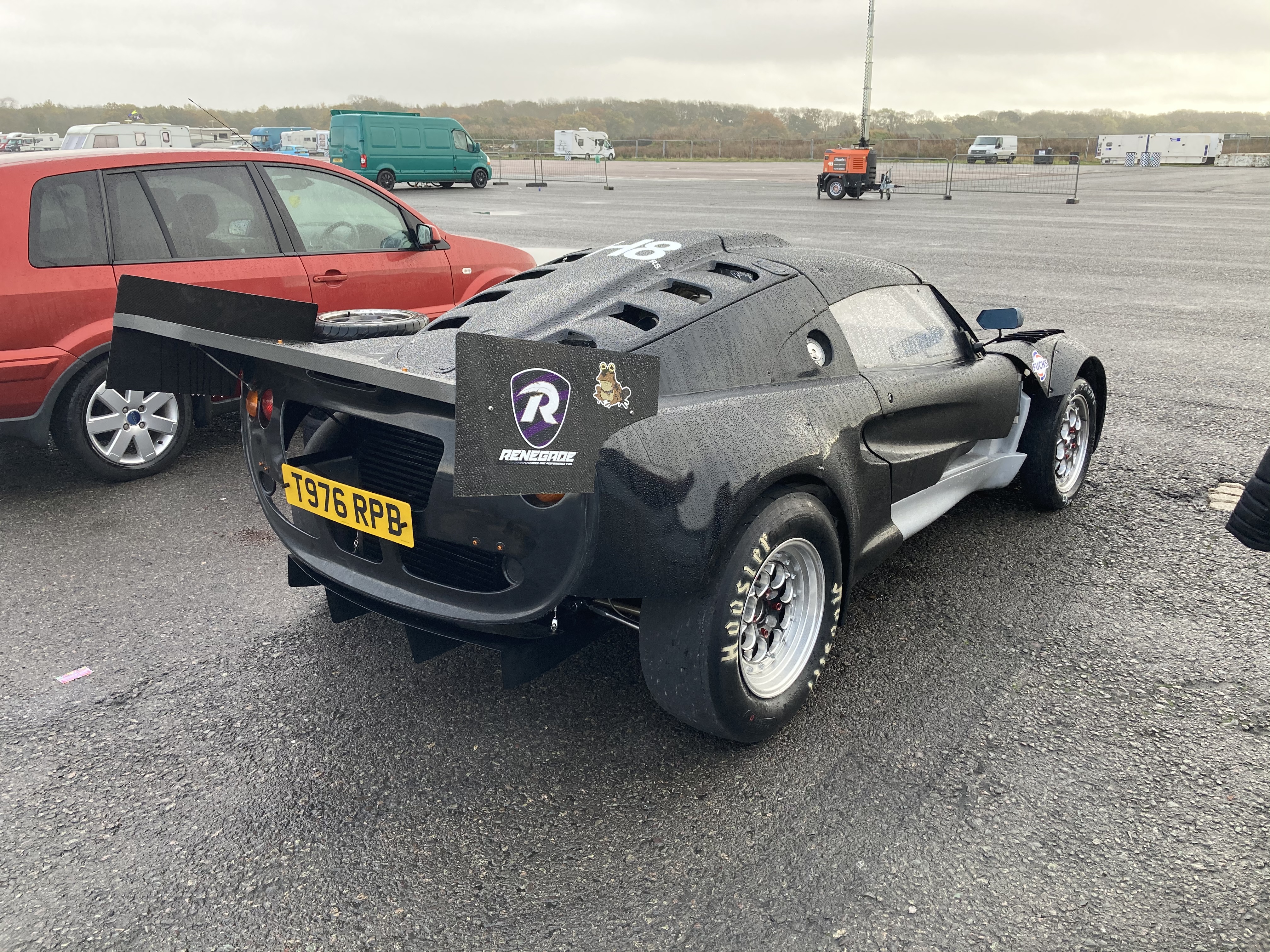

Lol what was the car that bailed out backwards
Exige
