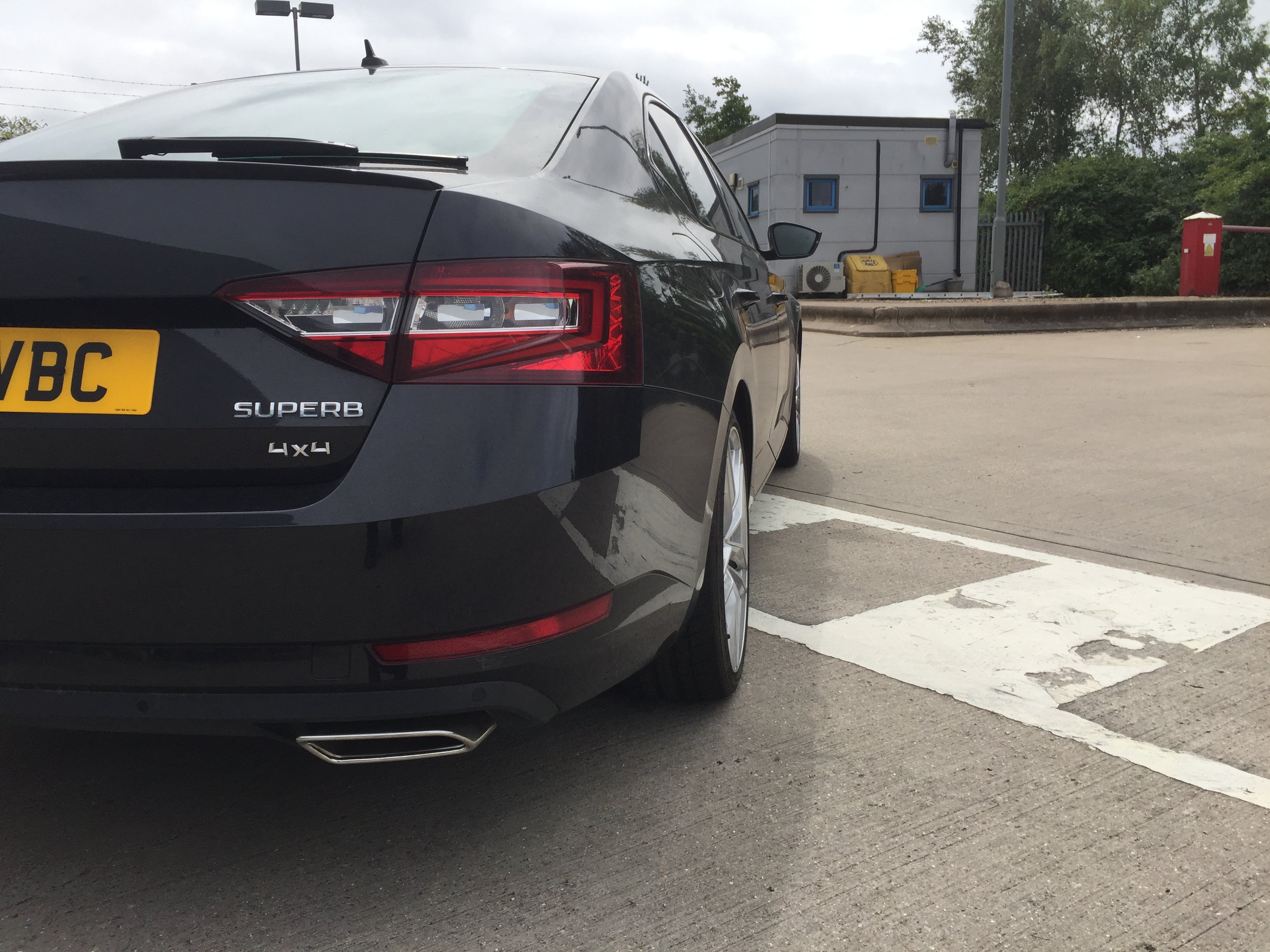

Love to but working 06:00 until 18:00 next Saturday and Sunday and the following weekend in Cumbria on holiday. The 1 mile straight line event would suit the 4WD and 360bhp and would reach 160mph for sure in 6th gear because the factory limiter has not been removed I discovered twice recently. 12 Mpg at max velocity BTW.
Change the limiter in vcds
