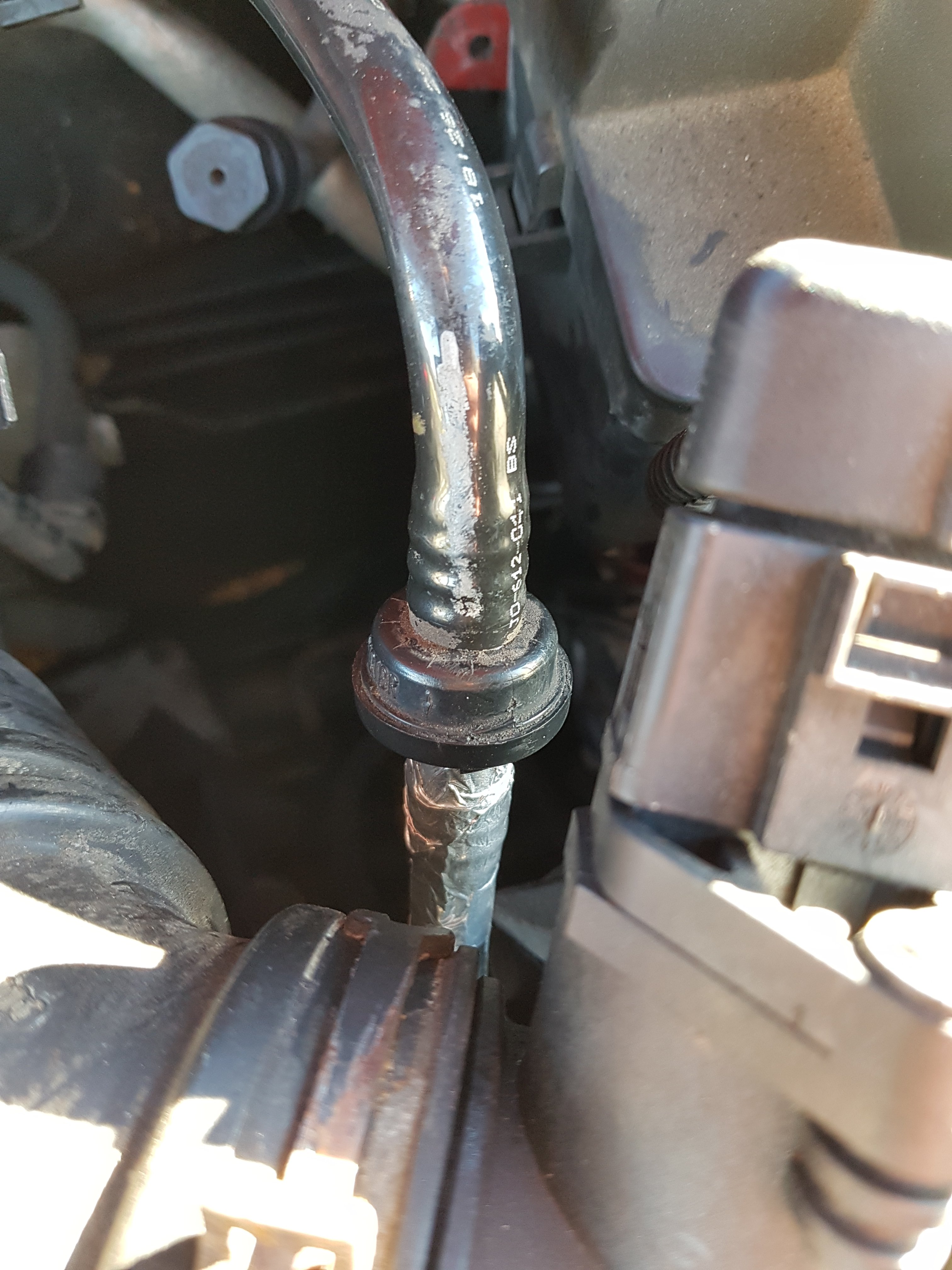

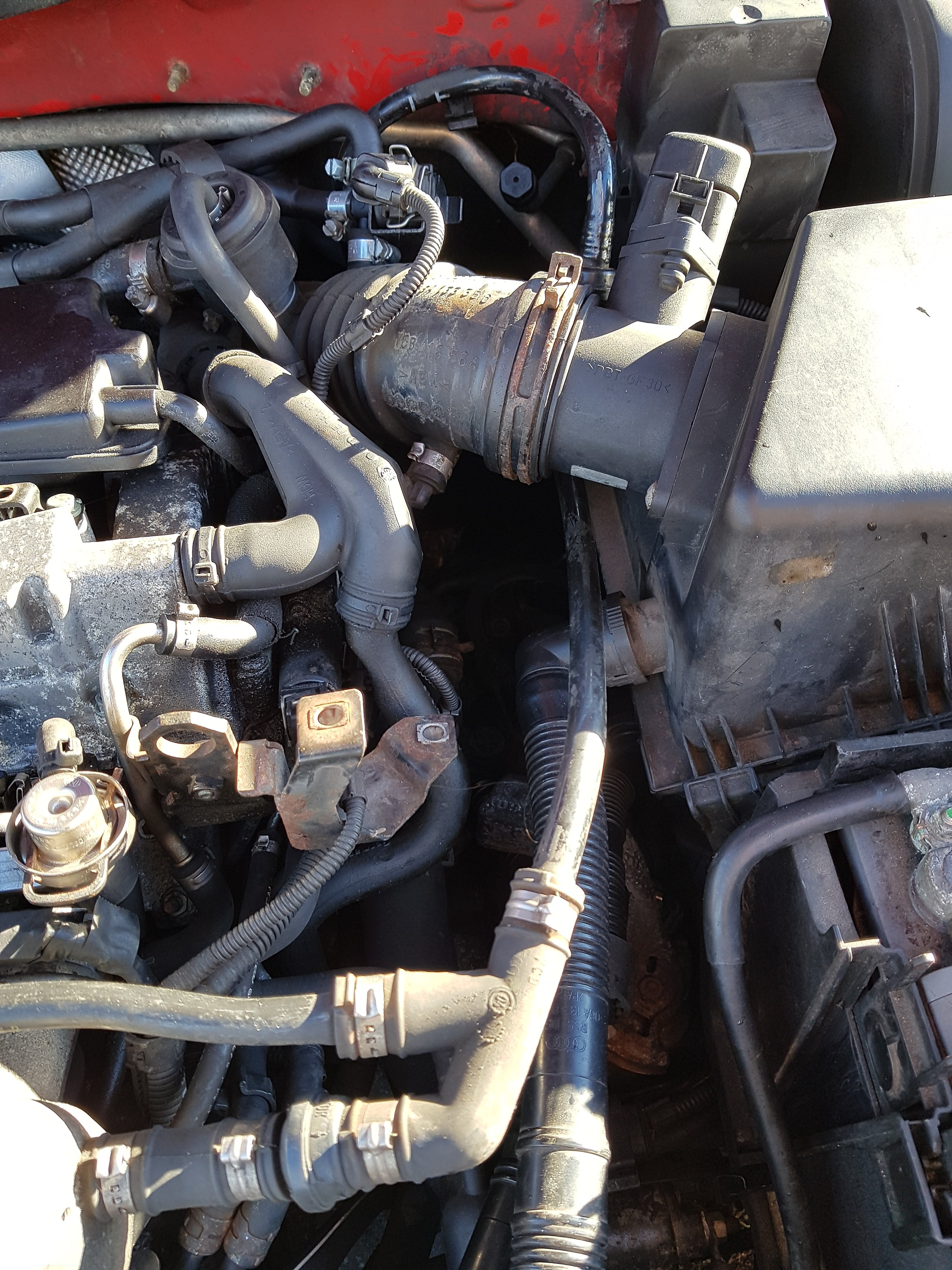

I’ve just changed the brake vacuum pipes on my VRS, one pipe on the check valve was completely split and a few of the other joints were pretty rotten so ive replaced them all
7-A01-FFE2-CBBF-48-D9-A63-B-A1-BAF9003-F
Good call. Did you have the pre 4k issue I had (in this thread) or just noticed them/heard them leaking?
I was chasing a 17705 fault and found it then
Edited by AndrewRoberts
Ah ok. I never had a code on mine...on 3 different scanners inc vag com. I guess yours is running ok now?
Edited by JMvRS
It is now, I also had to change all the crankcase breather pipework and clean the throttle body

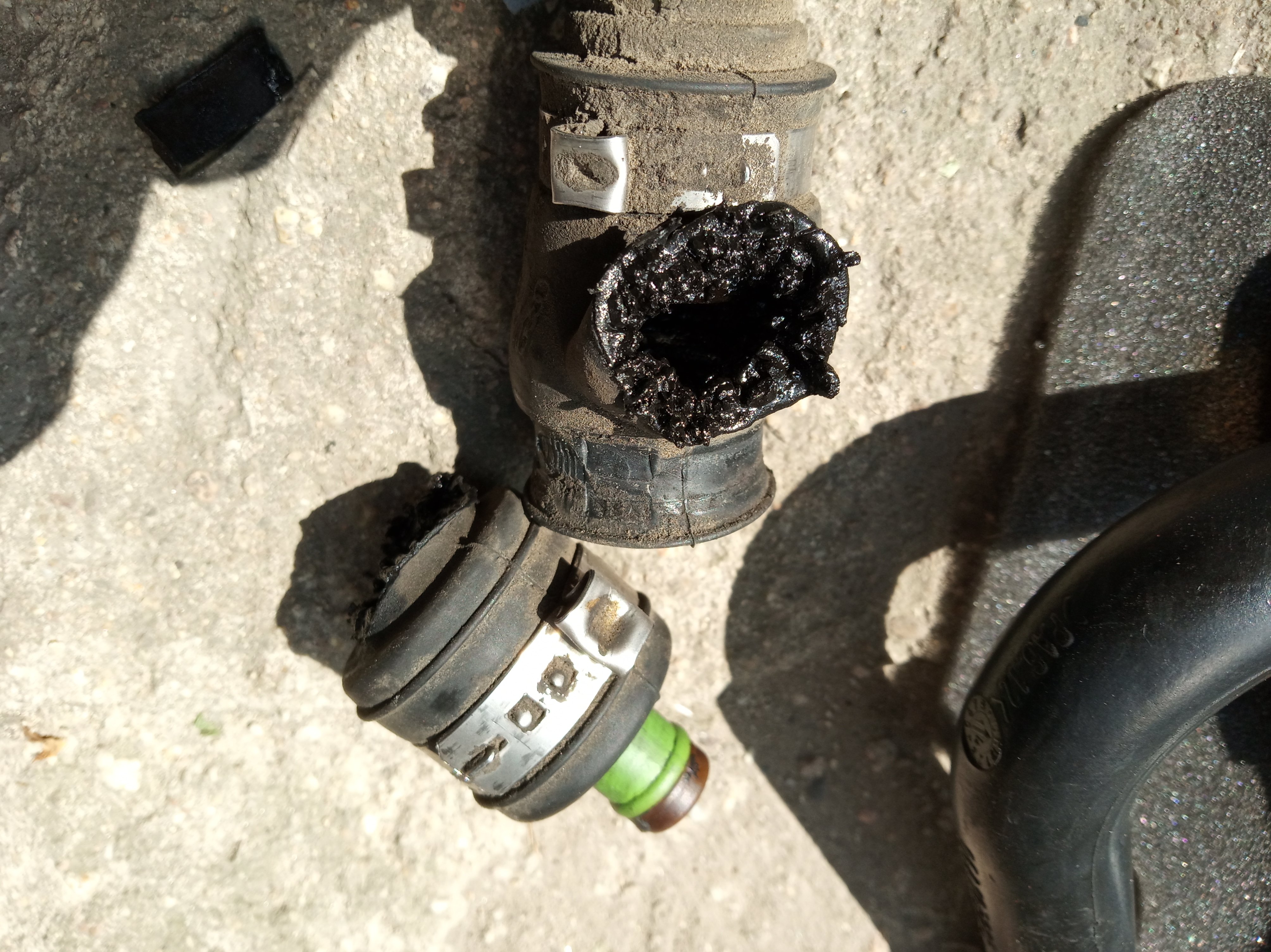

This is the mess the previous owner owner left for me
DEFEA33-E-83-F9-46-EB-9-CE2-830-BB398-B0

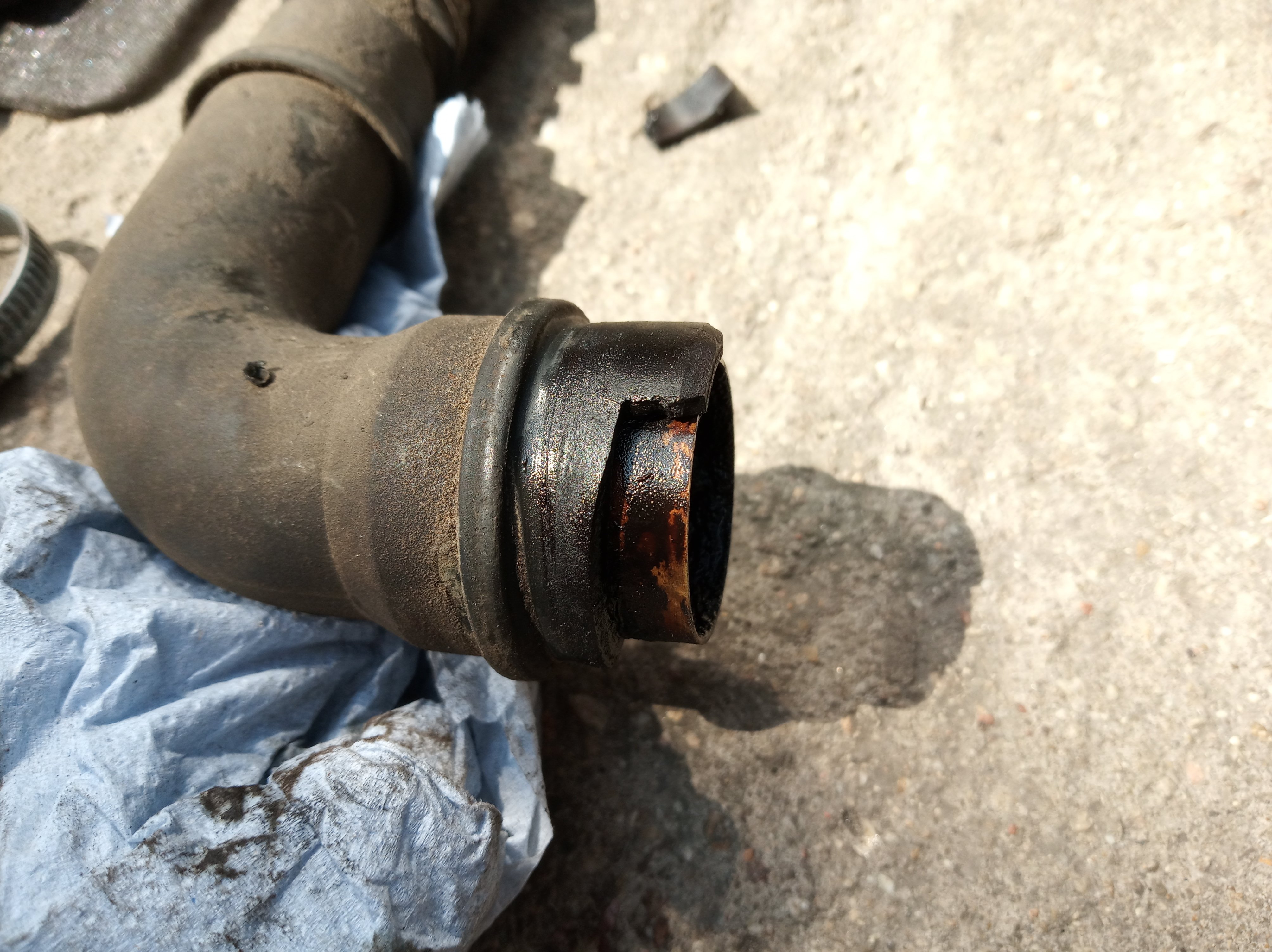

PCV + hoses after 300k km.
Changing the PCV is strongly recommended every 60k km..
Yea they rot out pretty quick really. At least your elbow came out in one piece, mine snapped off in the oil filter housing and was a complete pig to remove
