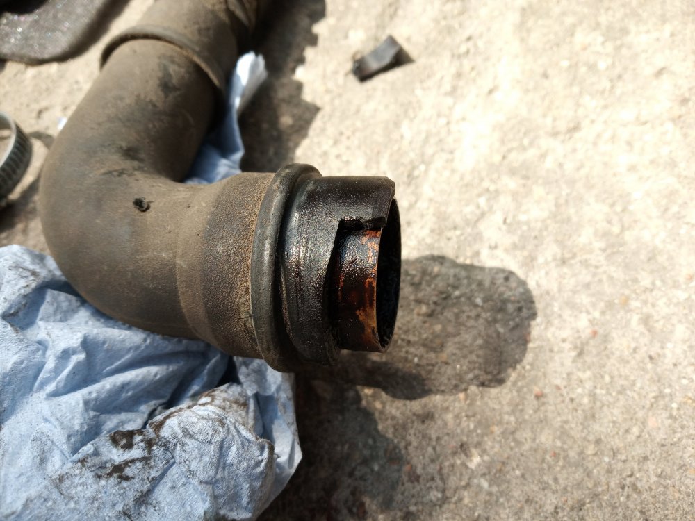

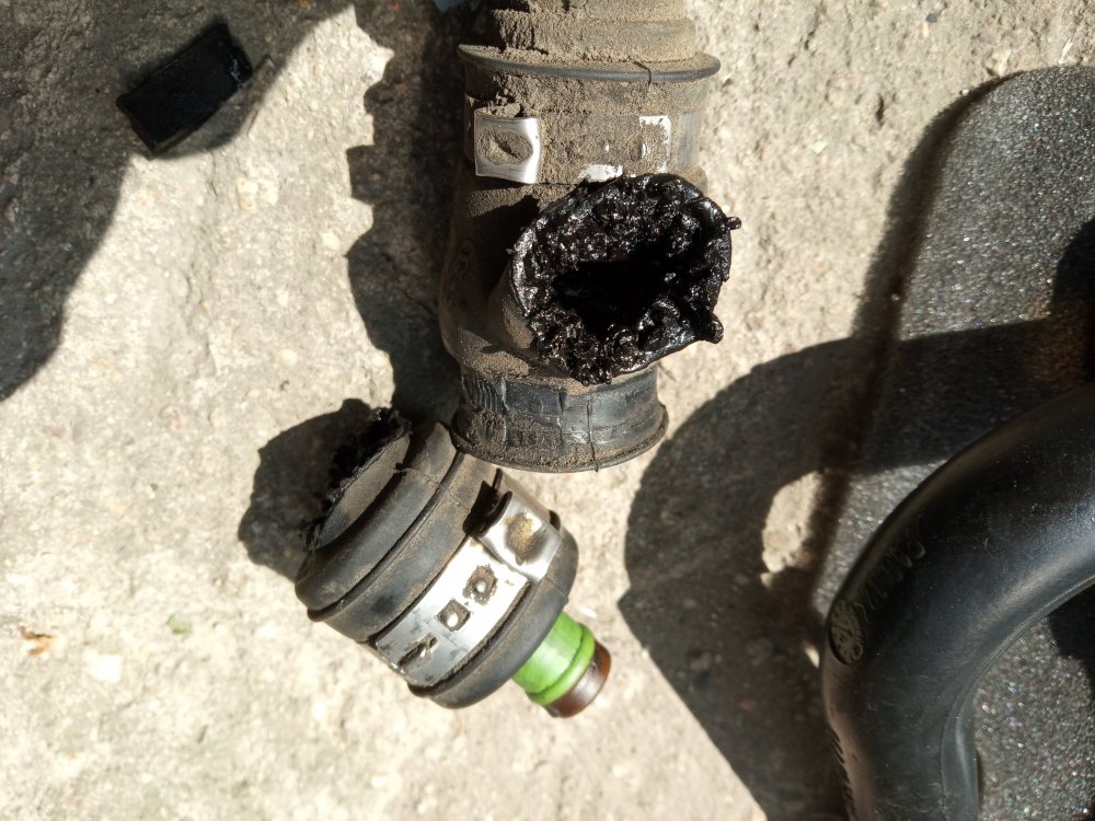

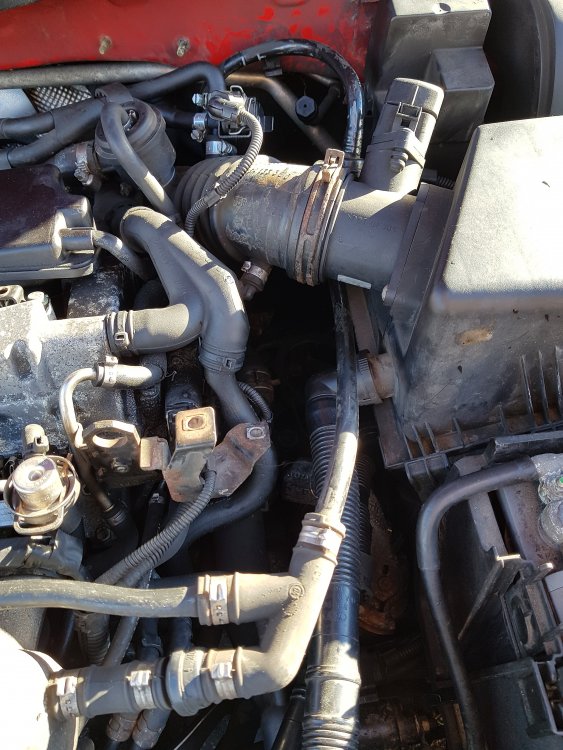

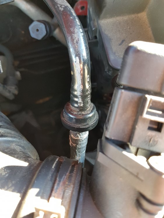

  • Nope....   Servo hose....just where it goes into the none return valve (near where it passes under the maf) there's the smallest of cracks in the plastic pipe.   My mot man found i
