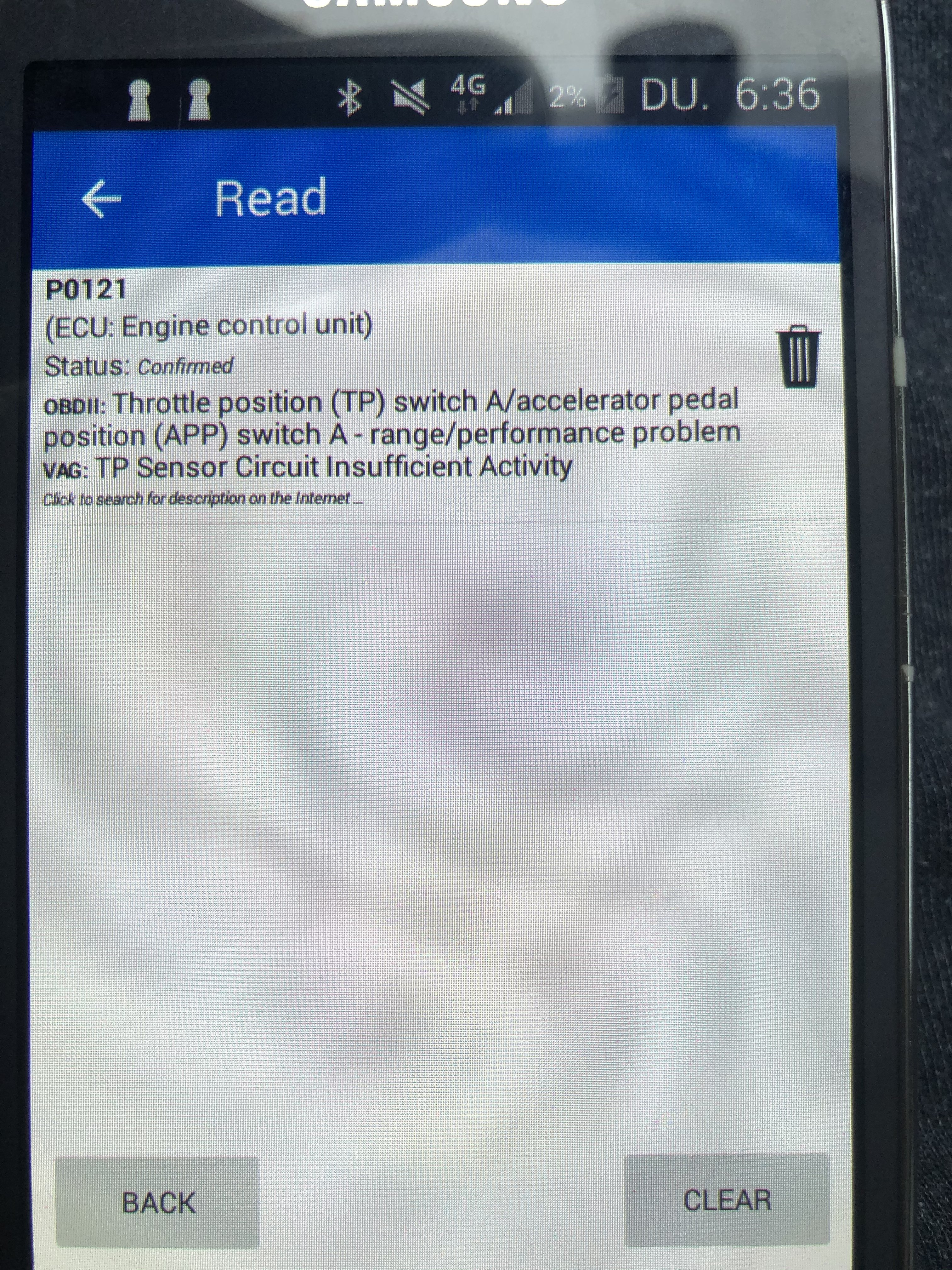

Hello Guys,
so do i understand correctly that i need to replace the throttle pedal? This is what came some days ago....
@Juhagpl
Can also be throttle body needing cleaned
Ecu thinks bad signal from pedal due to throttle not opening correctly
They carbon up and dont go to full open
read the thread above its got all the info on the modification to it as well😎
