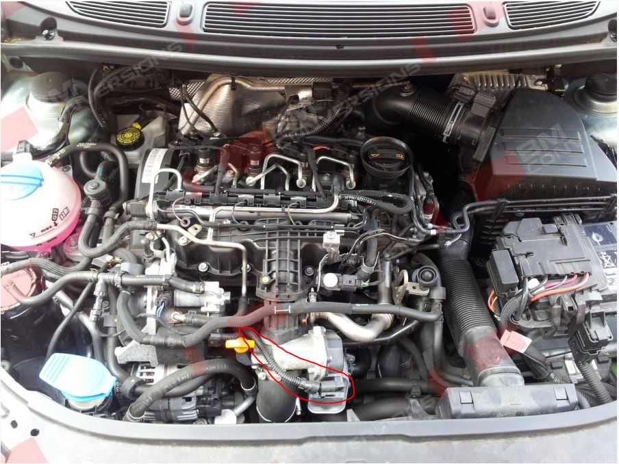

Does this engine have an anti judder valve fitted? I had a VW Caddy with the ALH 1.9 TDi engine which developed a big judder on shut down, the wire in the plug to the valve had broken. Fixed that and it fixed the judder.
I appreciate that they are different engines, but they are made by the same folks.
@MrVillage - No idea about the "correct answer", but my first thought was of the anti-shudder (aka anti-diesel) valve too.

I will check that. Do you know how to change it?

do you know if is this the issue by any chance?
Edited by Bertie90
better picture

turns out it is the ignition. If i press the key a bit harder in the ignition when turning off it doesn't do it at all. You live and learn
