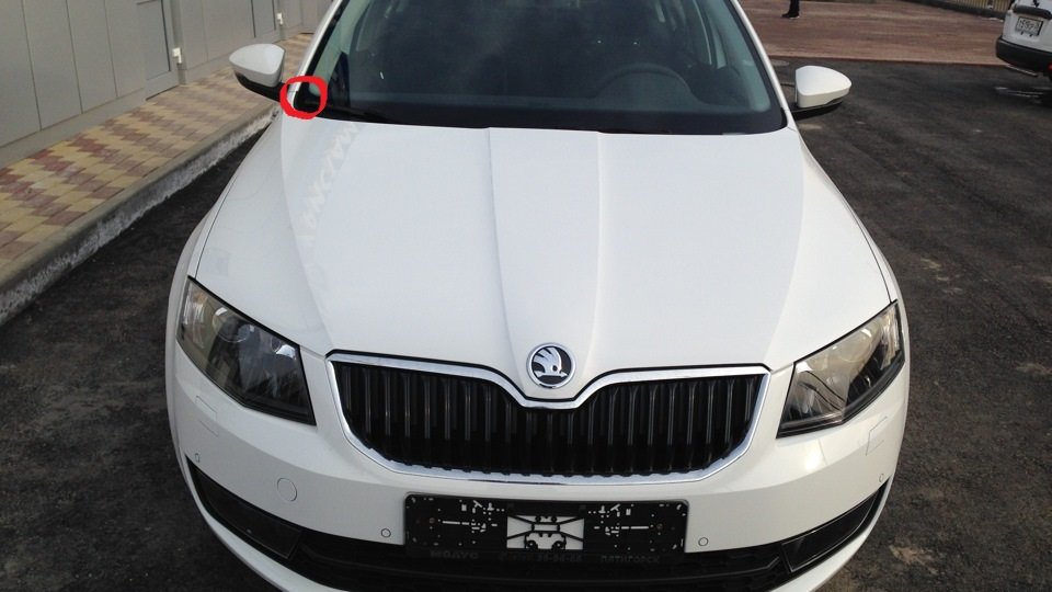

To be clear , the noise i was hearing was coming from outside the windshield. It is a small piece of plastic outside the windshield bottom left position. I just push it toward the window and the noise is gone. Just bend the piece of plastic so it can't move from the wind.
Watch the photo , the plastic is at the red circle.

I’ve had a look and the plastics could move about, so will test at the weekend with it taped down.
Holefully that sorts it, as it is very annoying - mine usually starts around 70 - 85mph.
