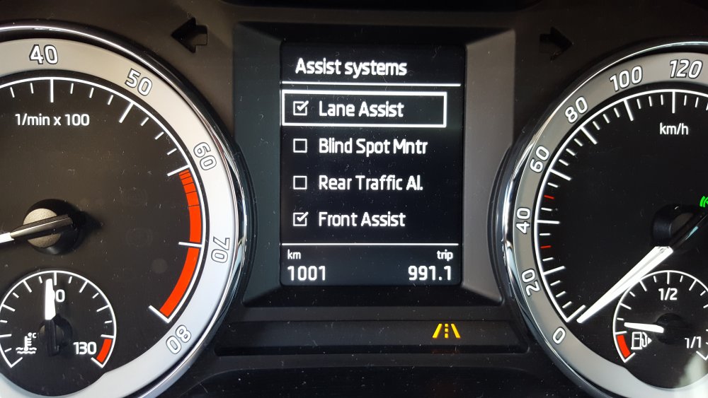

Hi, I do have lane assist (so I guess and hope also the camera exist? - see attached pls ;))
I think also that all Octavias 2017 selled here are equipped with lane assist.
Btw... You are so helpful, maybe you can tell me how do I constantly check on the Blind spot monitor and Rear traffic alarm (see picture attached) . It resets every trip, i don't know even why. Any idea?
