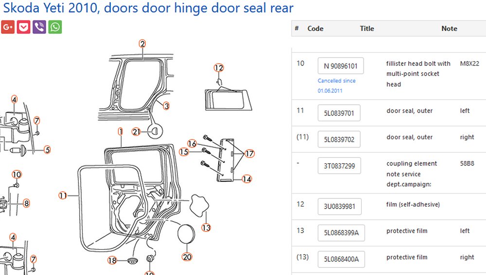

Is it part 11?
Unfortunately not, the part I need is included in part 6 from this diagram.
It is the vertical strip of rubber. I hope I managed to explain.
That looks to be the same fault my '12 Yeti has.In my case the seal is intact but the paintwork isn't. I've been told by the dealer that it's a known issue, and due to a design flaw with that seal. The rubber compound isn't soft enough, and causes wear on the trailing edge of the front door, particularly at the base. That in turn damages/removes the paint and introduces water, and in the UK at least, rust :(  The dealer is still chasing this with Skoda for me, but other than a recent phone call (to say it's not moving), I'm no closer to  a fix... The dealer has done resprays for others, only for the rust to come back, and the only permanent fix is replacing the doors! That would not be worth doing without a significant contribution from Skoda.
Here in Norway, this vertical rubber strip is routinely removed by the dealers. I have had all 4 sidedoors resparayed due to the zinkinclusion problem. At the workshop they told me there was also some wear to the paint caused by the runner strip. They removed the rubber strip on both sides leaving a gap between front and rear door. I have not experienced any problems with water ingress or increased noise after this fix.
