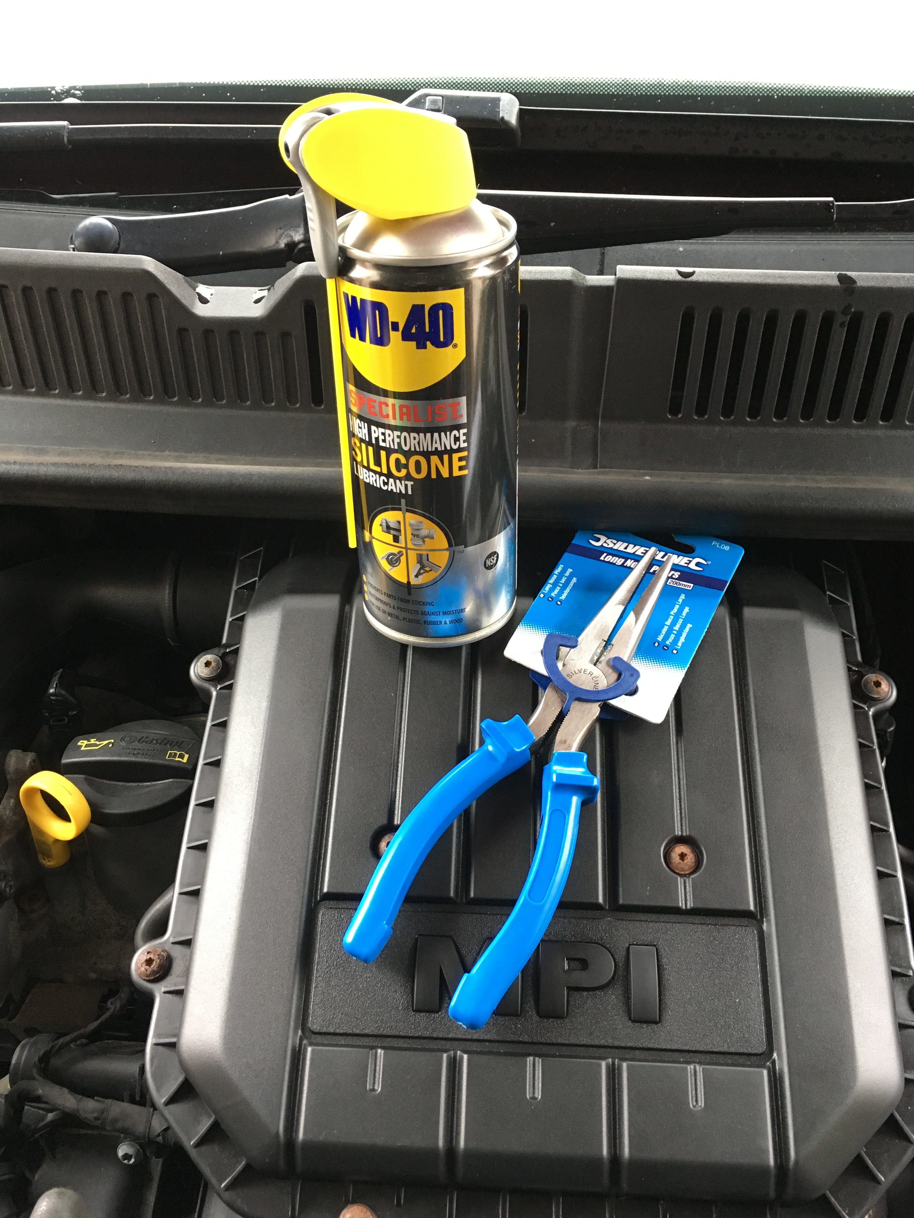

So everything started well.  I went to Tool Station and bought pliers and silicone spray.

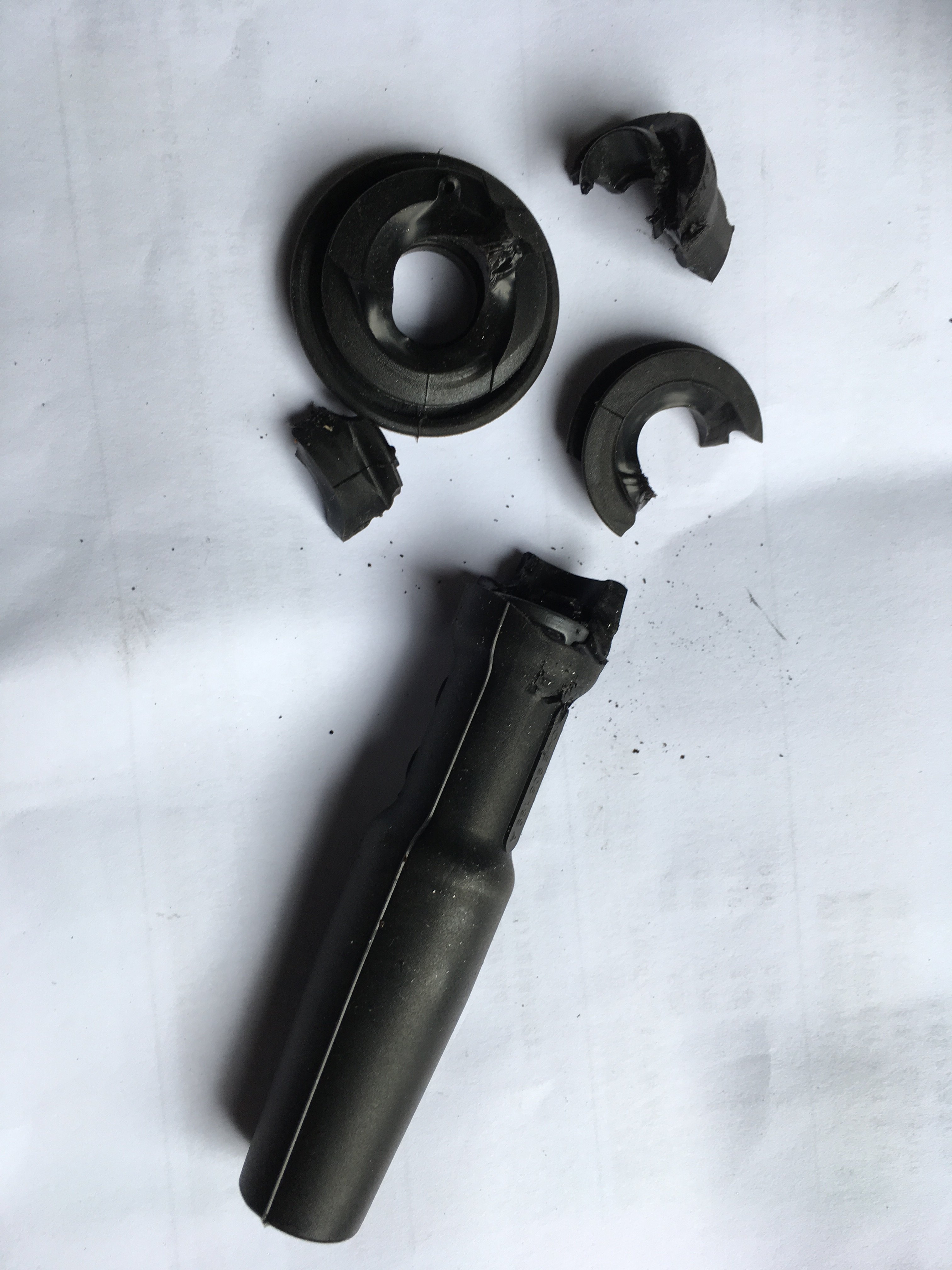

With the engine warmed up.  Spray applied, i pulled as hard as possible. Then disaster, the rubber part tore.
I have come up with a solution with might help others.
Compressed air! Put an air nozzle into the rubber boot this blows it up stretching the rubber off the spark plug.
