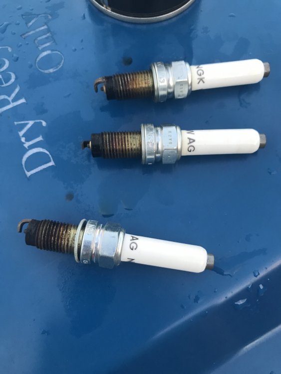

I managed to change my plugs yesterday just used generous helpings of WD-40 and some needle nosed pliers.
here's how mine looked IMG_0461.thumb.JPG.418a0a7e789cc98bc7d5089748412aa7.JPG
bit of wet fouling on 2 of the 3 cylinders. Nothing too serious I don't think
