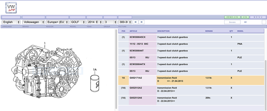

Did Skoda UK have your Reg No. / VIN to check your actual car to see if it required Service Campaign 34F7 (edit)  and the Synthetic Oil changed to Mineral & a Software update,
& were not just answering that there is 'No Service Schedule / Guidelines for a DQ200 and any need to change the oil?
The 7 Speed DSG DQ200 did not need any Oil Changes,
until 2012 when there was a WORLD WIDE RECALL and then 2014 when Skoda started a Service Campaign due to EUROPE not being in THE WORLD.
NZ got a proper SERVICE CAMPAIGN & new MCU's fitted.
http://skoda.co.nz/news/dsg-service-campaign
So service Campaign 34F7 to change the Synthetic Oil in the MCU to Mineral and a Software Update.
(So 2013 you might expect 2013 from the Factory to have Mineral OIl, not all did.)
2016 a Service Campaign starts on some DQ200 2013-2015,  34H5, Software Update. THIS IS DUE TO DSG Heat, Pressure, Failures, VW / Skoda are not saying...
So there is a Vin Checker which should show if 34F7 is outstanding, it does not always do.
http://master.skoda-auto.com/mini-apps/recall-actions
