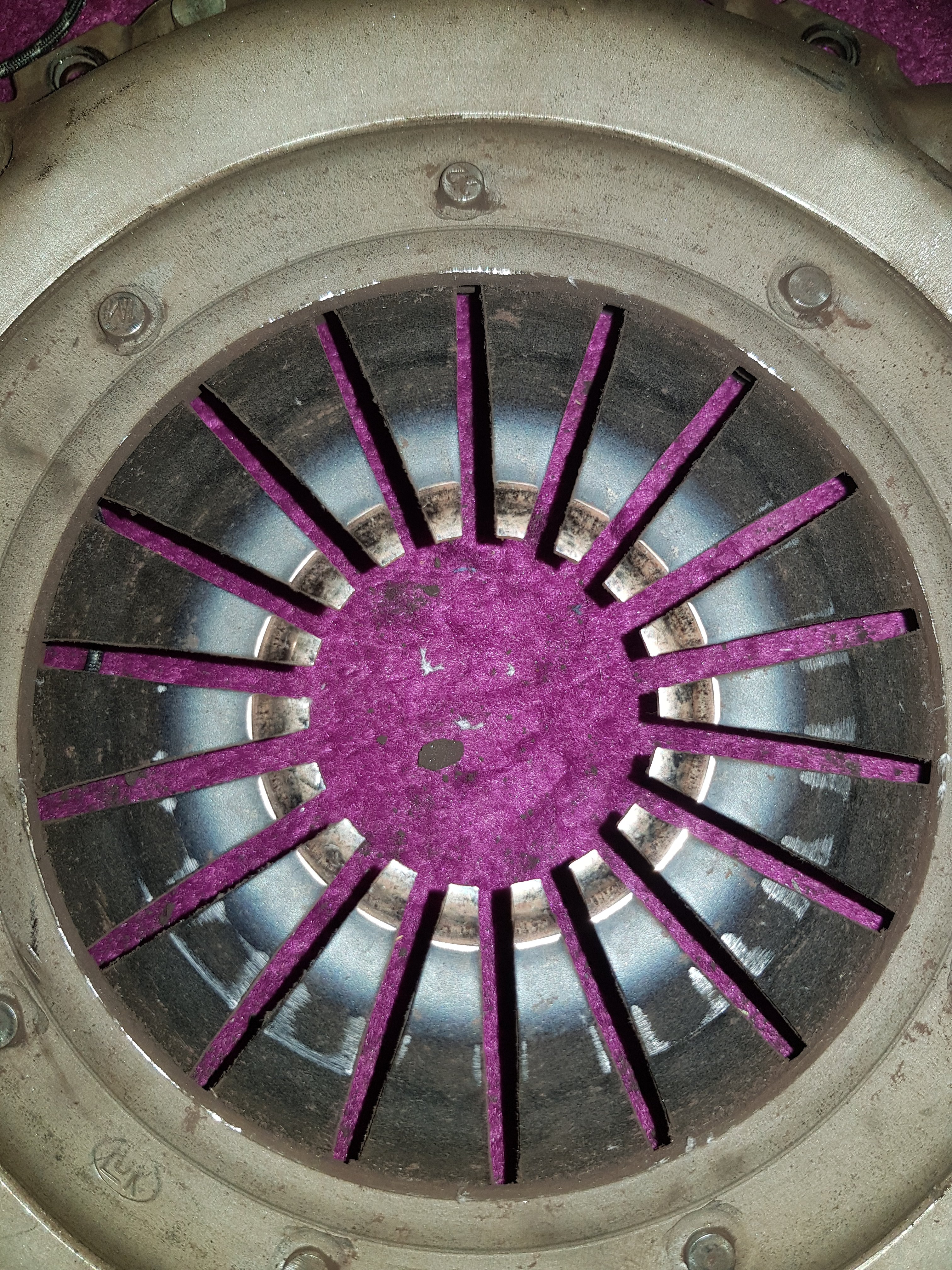

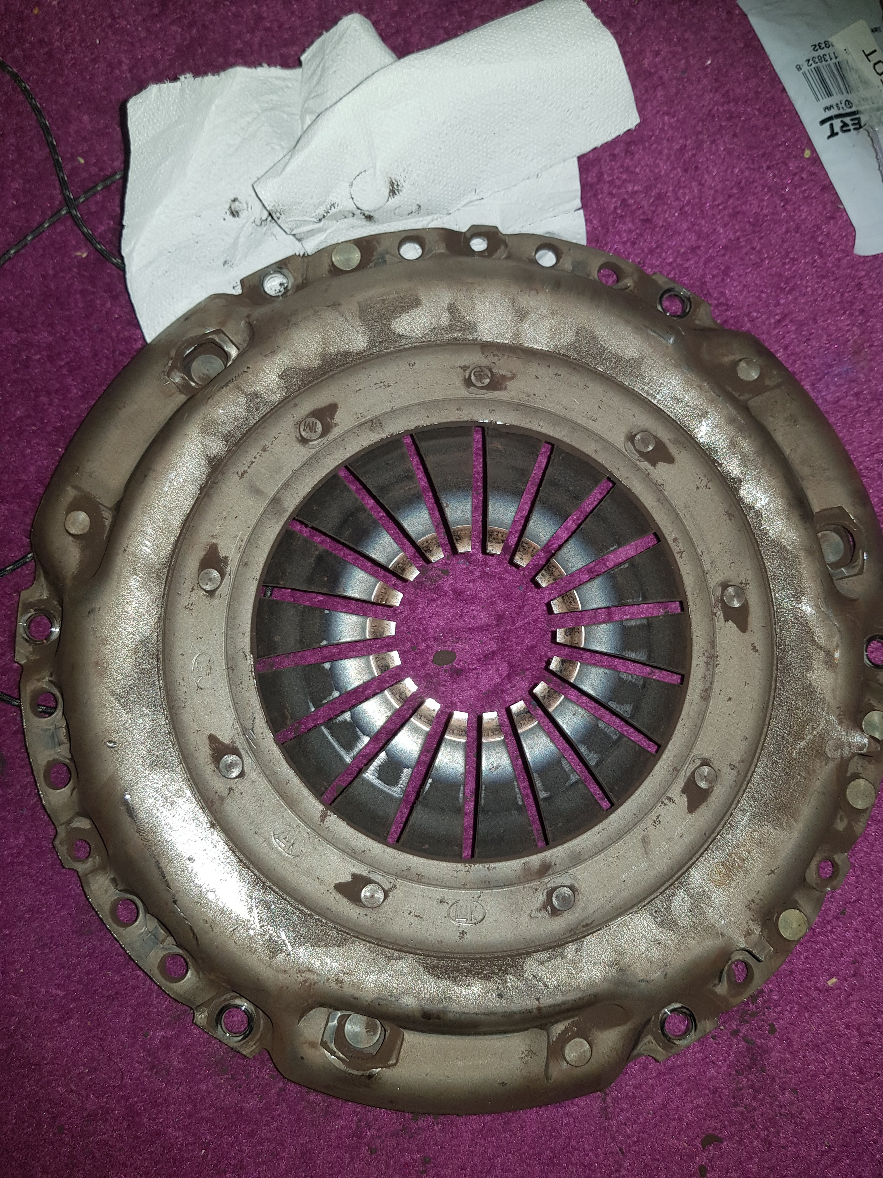

  • Photo of the gearbox side of the cover plate would be useful.

Added images

So pressure plate is faulty and could have caused the mark on the gearbox?
I can see scrape marks on the fingers and its not all the way round only on some fingers, again don't know what this points to.

As the friction plate wears, those fingers move away from the engine and towards the gearbox - I cannot see the 1st photo which I assume is the friction plate - but if the friction plate was below the minimum specified thickness could this allow the fingers to touch.
Is it the original clutch, and if possibly changed has the correct one been fitted - a thinner than design friction plate could incorrectly position those fingers - I know that generally all Fabia gearboxes (except the VRS) are the same but is the crankshaft to flywheel always in the same position on different engines - possibly one for you Sepulchrave.
 The markings on only a few of those fingers could be due to slight bending of individual fingers over time - if you put the pressure plate down on something very flat then put a flat plate on the spring fingers with a spirit level on top where is the bubble if you rotate the spirit level around.

If the engine was this cream crackered you'd be having other problems - I think this is a simple case of cover plate failure - especially considering the rubbing on (only)some of the springs

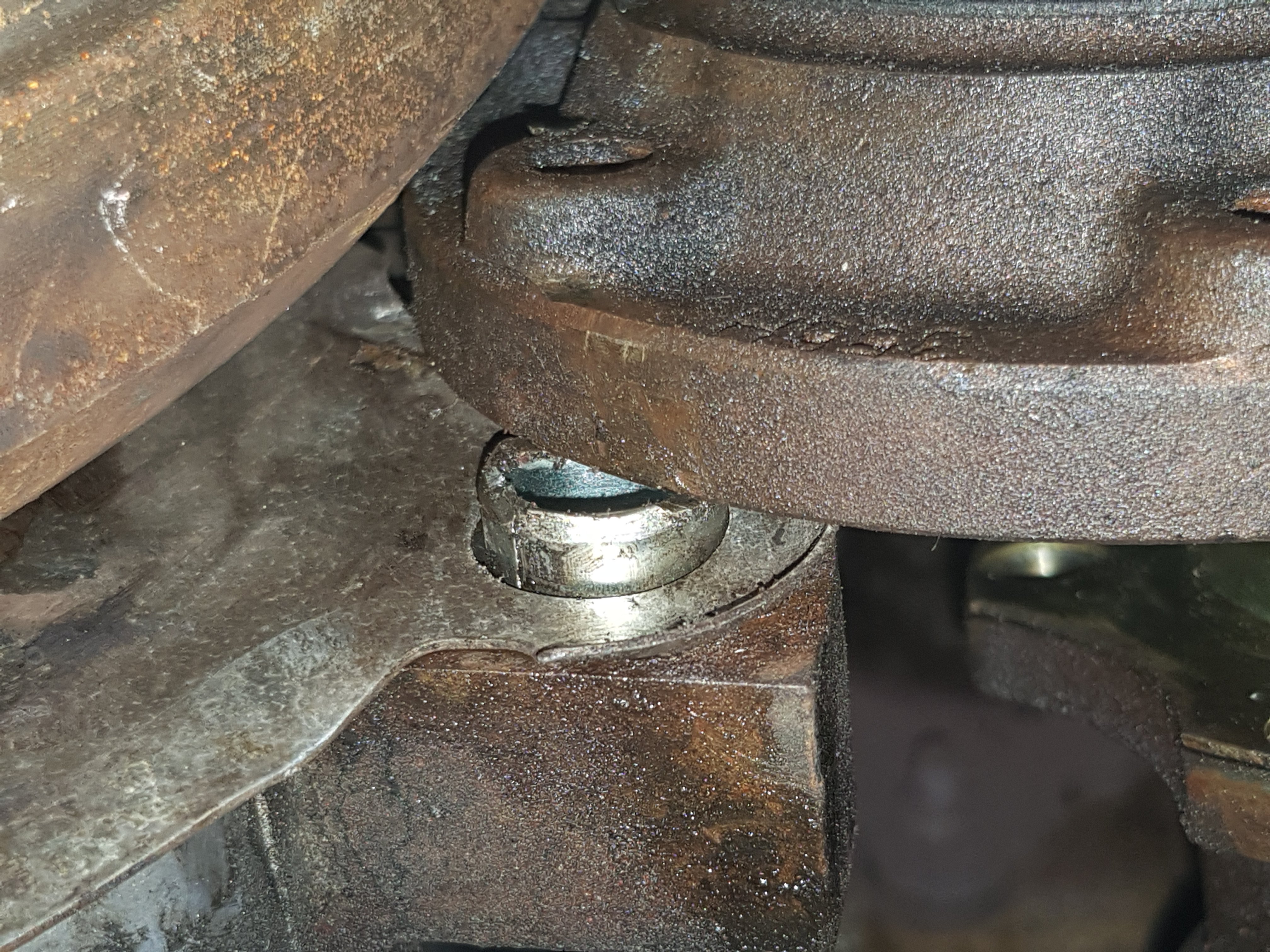

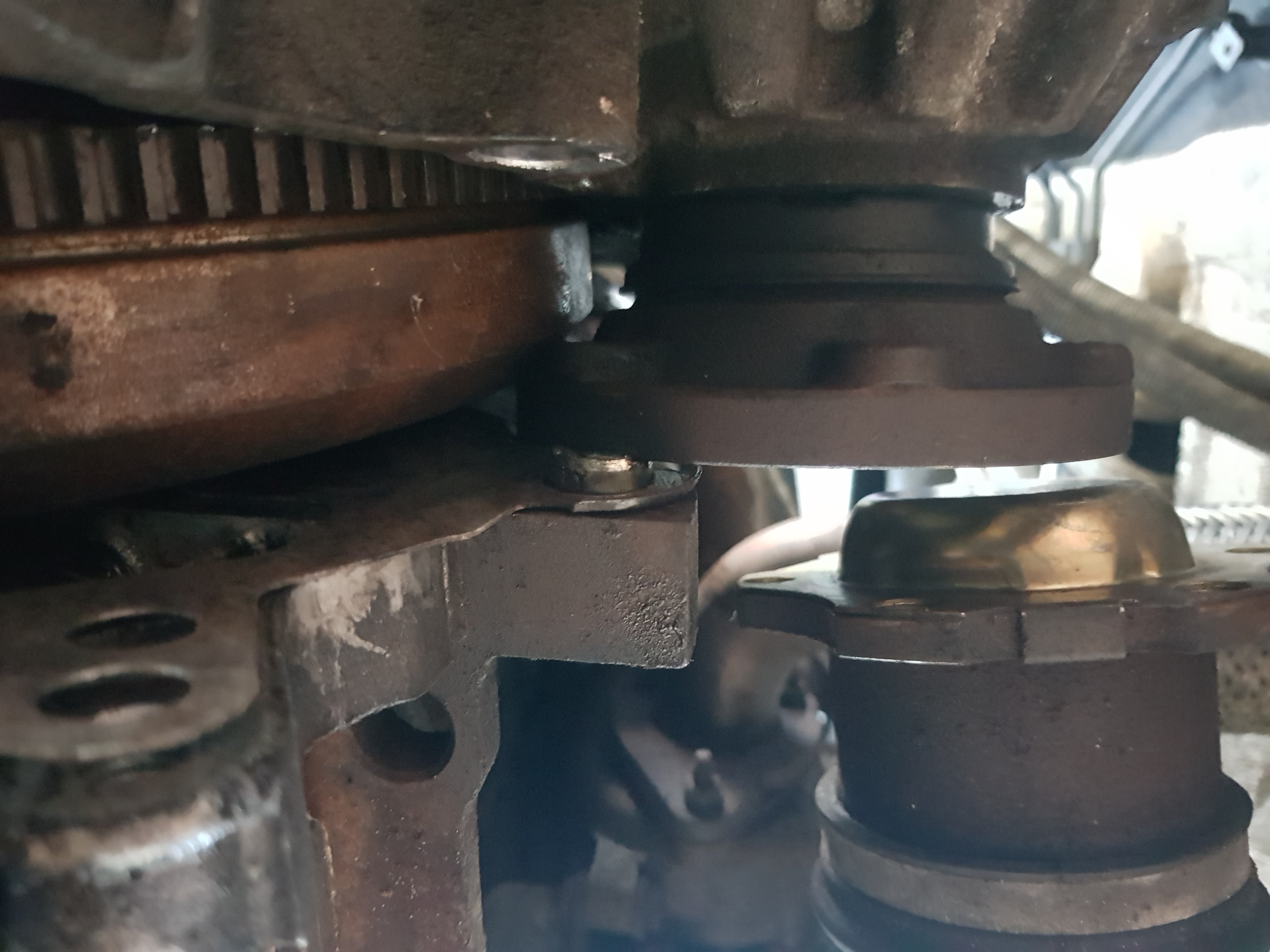

I would advise anyone doing a clutch change on there drive too remove the subframe, makes life a lot easier so I learned as i got the gearbox stuck on one of the dowels that line up the gearbox when I was putting it on.
In the end had to remove the subframe due to that.
Have a look at these pictures and you will see what i mean.
