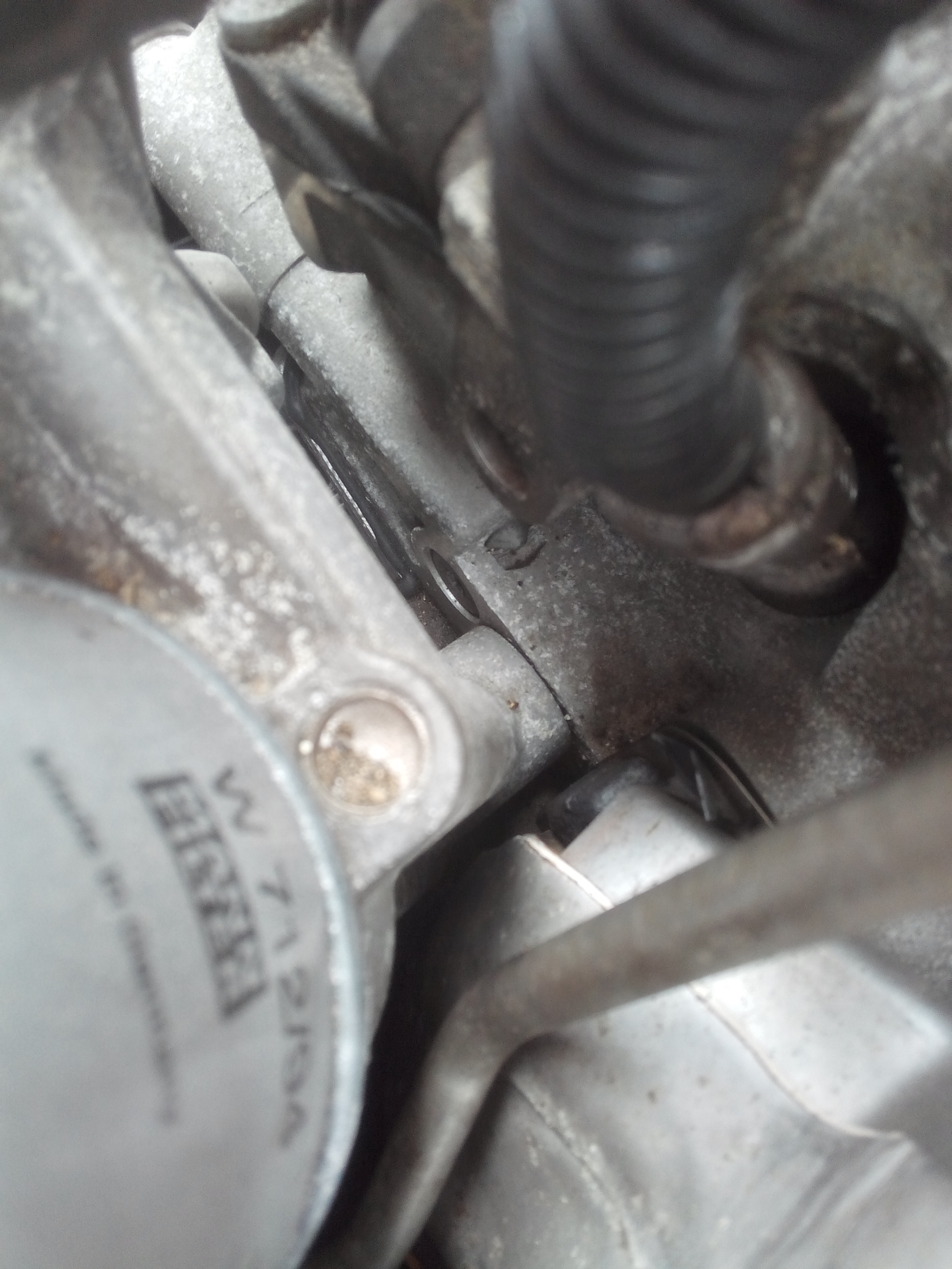

Just checked both our 1.2 tsi's (2011 and 2013) and that plug/washer is in fact a sunken plug with a torx head. You can just see it here to the left of the filter housing. Easy to access/tighten with a torx key. I'm inclined to think it may be the housing to head interface which is leaking. Maybe some ham fisted gorilla has been tightening filters. I've known then to be fitted ridiculously overtightened and needing a breaker bar to be removed.

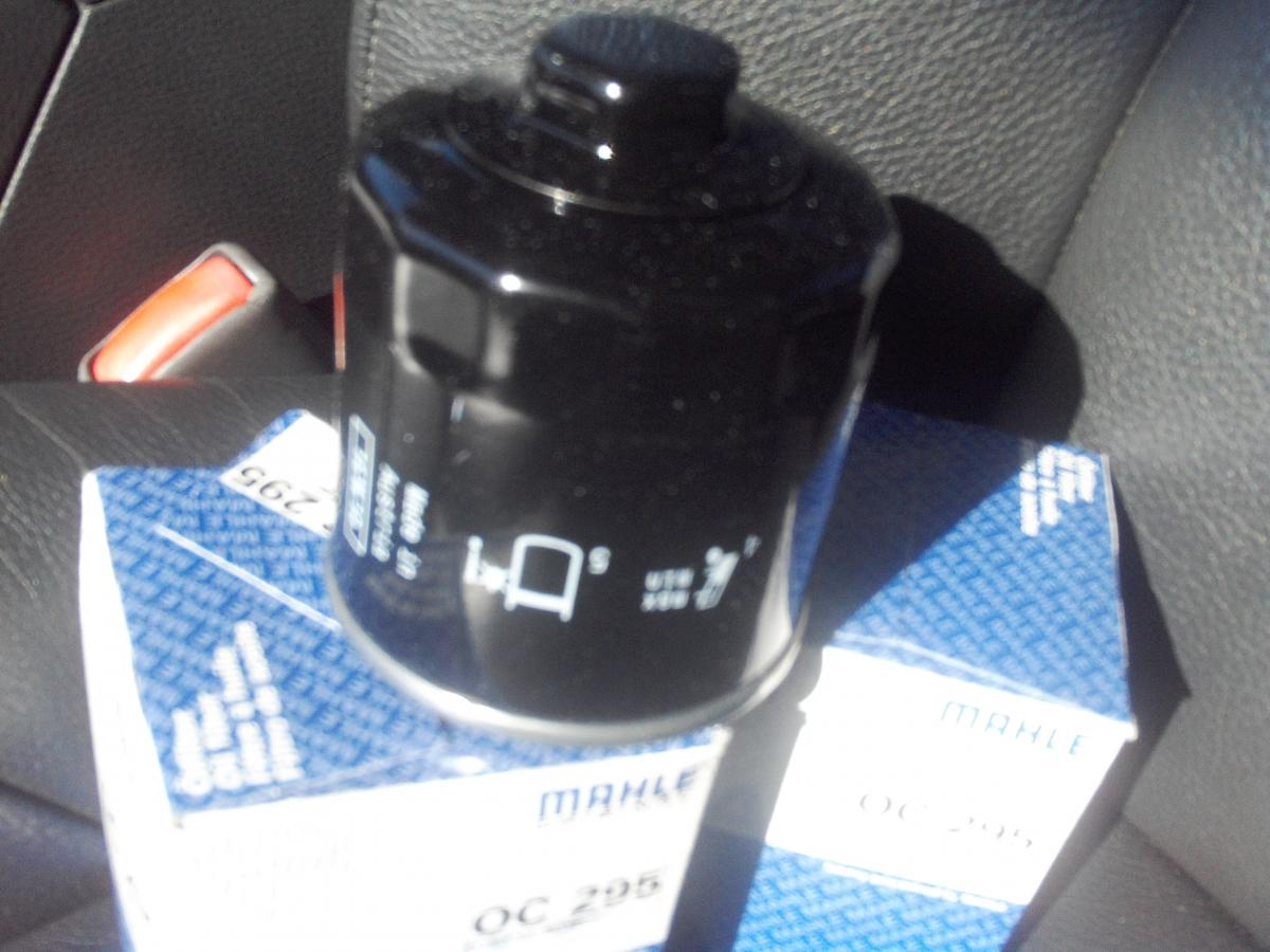

I like using Mahle Filters and not just because they are around £4.
Obviously not the Silver less messy ones that VW Group changed to, but easy on, easy off.

Sorry for delay, the blanking plug and o-ring were replaced and the leak is no more!
Total bill from independent garage = £56, just a small saving on the £1005 quoted by the dealer for a head gasket replacement (and we may still have had the leak).
Hopefully it really was this simple to fix. But nit a huge bill if we discover further leaks in a short while.

So did your car have a Silver Filter fitted, and is it 5w 30 FS Long Life oil the dealership uses for the servicing?
(Edit, i see on the picture it is a silver filter, pretty dirty, when was that new one fitted?)

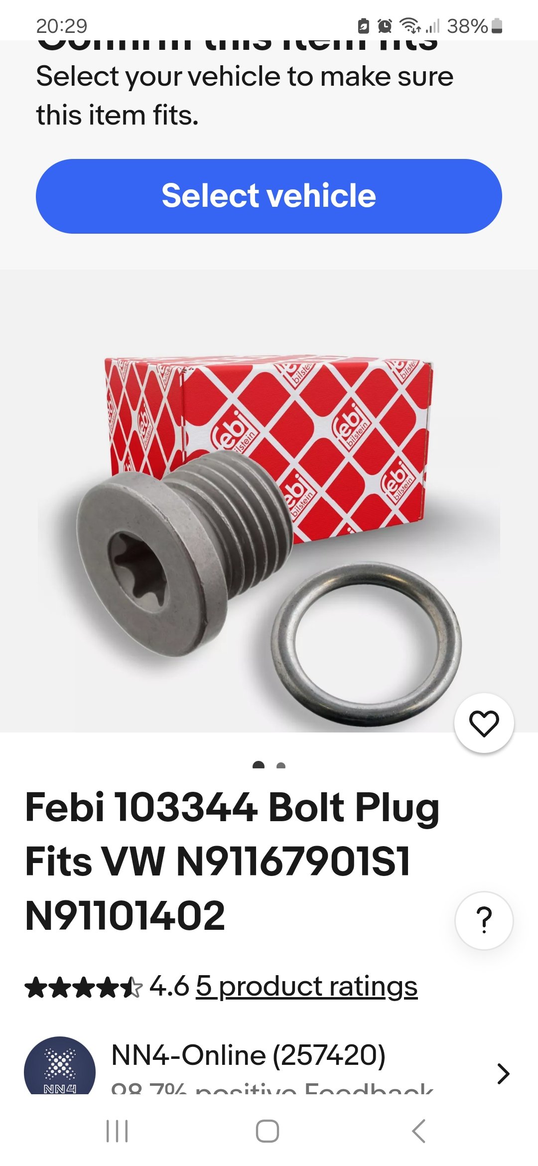

Having just bought a 2012 Roomster with a very oil-covered CBZB (1.2 TSI) engine, I started researching possible sources.
I think the OP's sealing plug leak may be relatively rare compared with the gasket shown being changed in this excellent video. YouTube has several other versions in various languages, which is what makes me think it's a common problem, but none I've tried are as thorough and well made as this one. This is in German, but the way the parts being undone are clearly shown and sometimes highlighted in red, makes it remarkably easy to follow.
I only skipped through it but I agree the presentation of that video is excellent for non German speakers, the red highlighting was very well done.
  • Sponsor
Since my parts catalogue link earlier in the thread is broken, and I struggled a bit to see the location @xman was pointing out in his photo, the blanking plug referred to by the OP is seen in the video I posted, just to the left of the coolant grommet at about 06:15 into the vid.
Plug and oring look like this:
I'll have to check mine, but I doubt I'm lucky enough for it to be as easy as that to fix.
