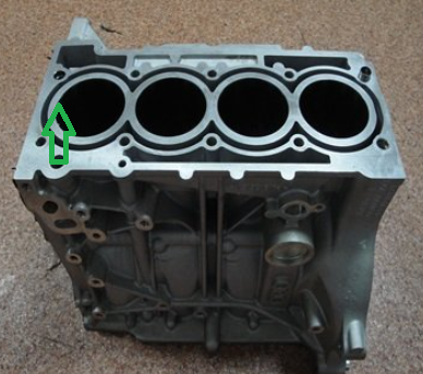

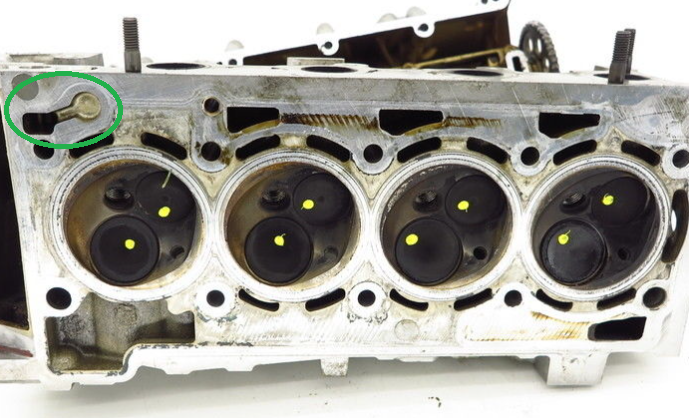

As far as I can tell by guessing at engine codes and viewing ebay/google pictures of head and block, the high pressure oil feed up into the head is as marked in these two pics.  See if that corner of the gasket/engine looks wet with oil, if you can see enough with all the clutter of a modern engine bay.

Great stuff Wino. So looking at those pictures, the oil feed is at the front of the engine around / behind the oil filter. Should be pretty easy to see from above if there is a leak around there. And whether its from the head or filter / housing.
Just be aware that this is exactly the place where a sloppy mechanic will spills load of oil if removing the oil filter too quickly.
