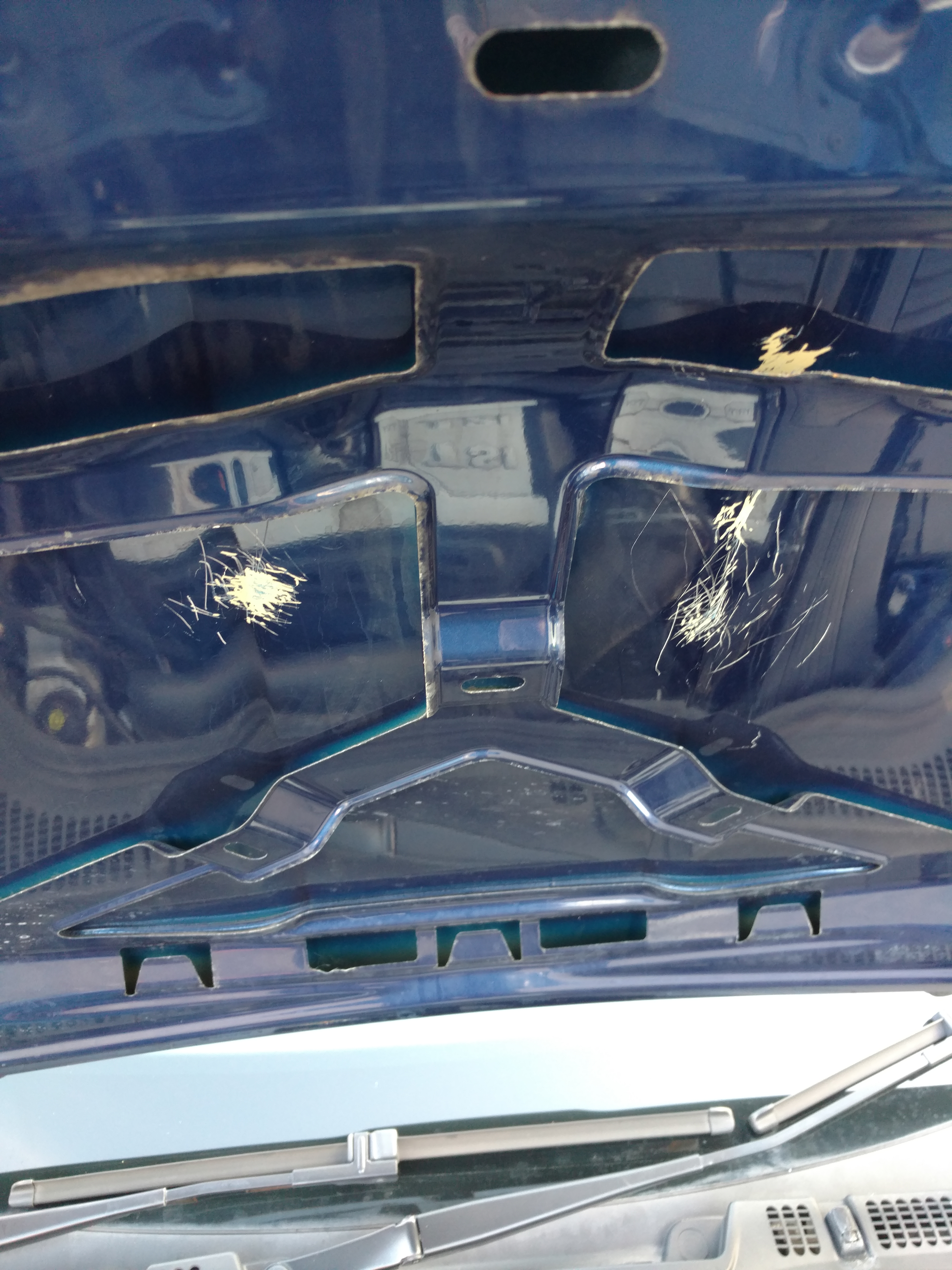

One question though, what's going on with the bottom of the bonnet? Should it have some sound deadening or something? Looks like something has been scraped off.
No sound insulation fitted to the underside of my bonnet, but as said in my previous post the 1.8TSi is very quite so does not need it, there is none on the tiny engine cover either. looking at the pic u posted something has scratched that bonnet, possibly tools left on the engine and the bonnet closed on top.

It's quite strange about the scrape marks, as lots of them are underneath the stiffening bars - no sign of any corresponding marks on the engine or anything, and no sign of dents or bulges to suggest that the bonnet had been closed on any tools or something.
If I'm still interested after a few days of mulling it over and due diligence reading up I'll be taking another look, and I'll make sure the engine is cold (I'll turn up unannounced!)
Those scratches are strange, can't think of anything that'll do that apart from a cat. I fitted a bonnet insulator to mine, only £25 or so and quietens an already quiet motor. Was the oil at max and a nice golden colour? Starting from cold is a must, I'd be a little bit dubious about a car pre warmed.
Those scratches, could they be where a dent removal specialist has 'pushed' dents out of the bonnet?
I'm glad everyone else is as mystified by the scratches as i am. Think it would have to be a very large, angry cat to do that sort of damage... That said, I think if I was a cut trapped under the bonnet I'd be pretty angry though :D

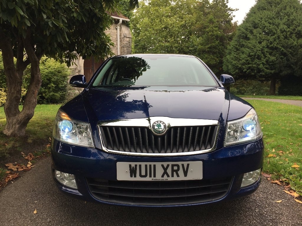

Possible I suppose, but it if it is then they did a bloody good job of it. I've attached a pic of the front of the car, bonnet looks flawless on the other side.

Those bonnet scratches. Could they have been made by someone using an engine hoist without removing the bonnet?
Interesting idea... Some of the marks are under the stiffener bars though so I'm not sure a hoist would do that sort of damage.

Nice colour... whats the asking price?

I wouldn't focus on the bonnet scratches instead other aspects of the car, engine. Someone else suggested dent removal levers and that would be my best guess too for the bonnet. My bonnet has a heat mark from shrinking a dent under one of the reinforcing bars.
