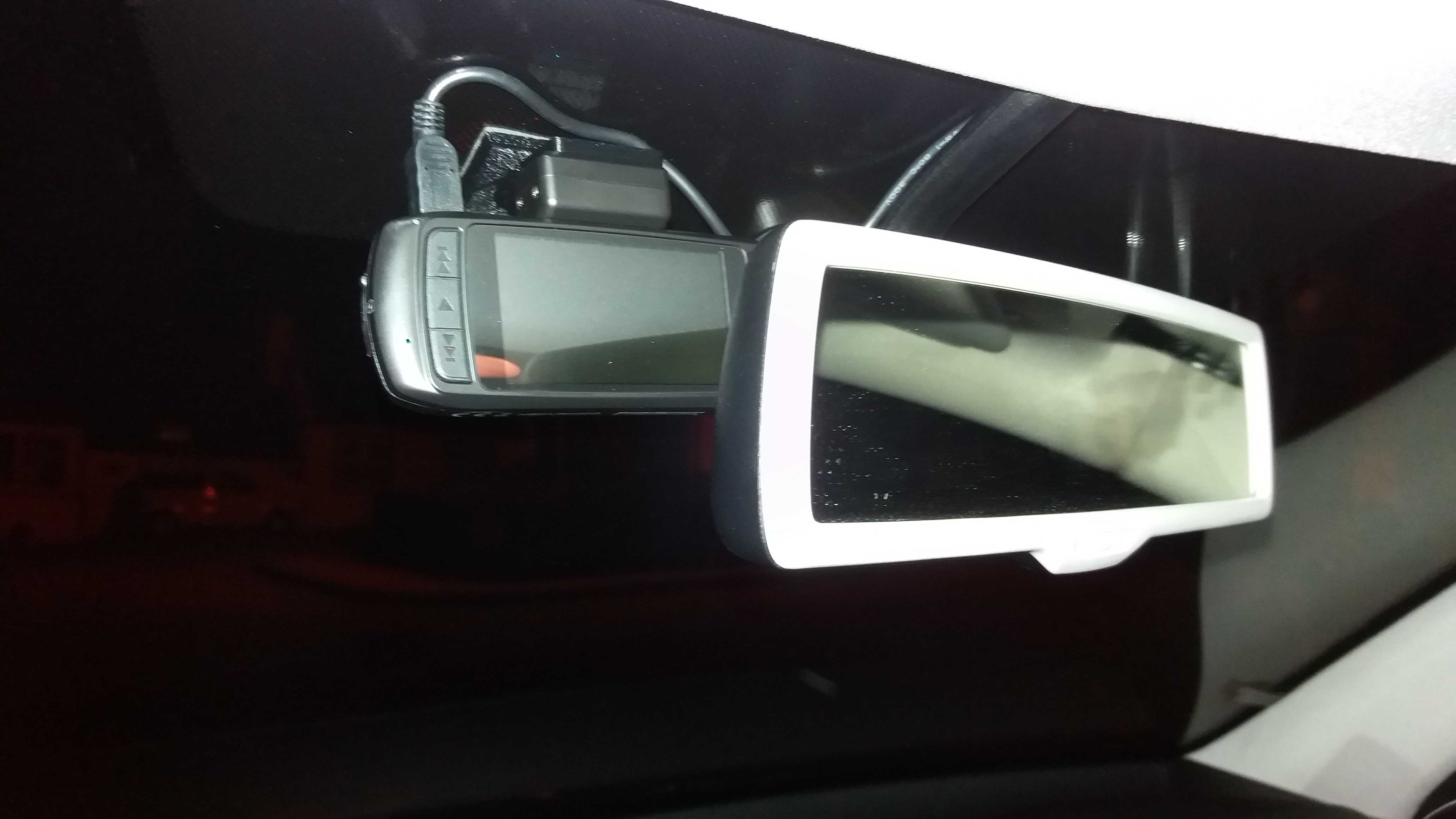

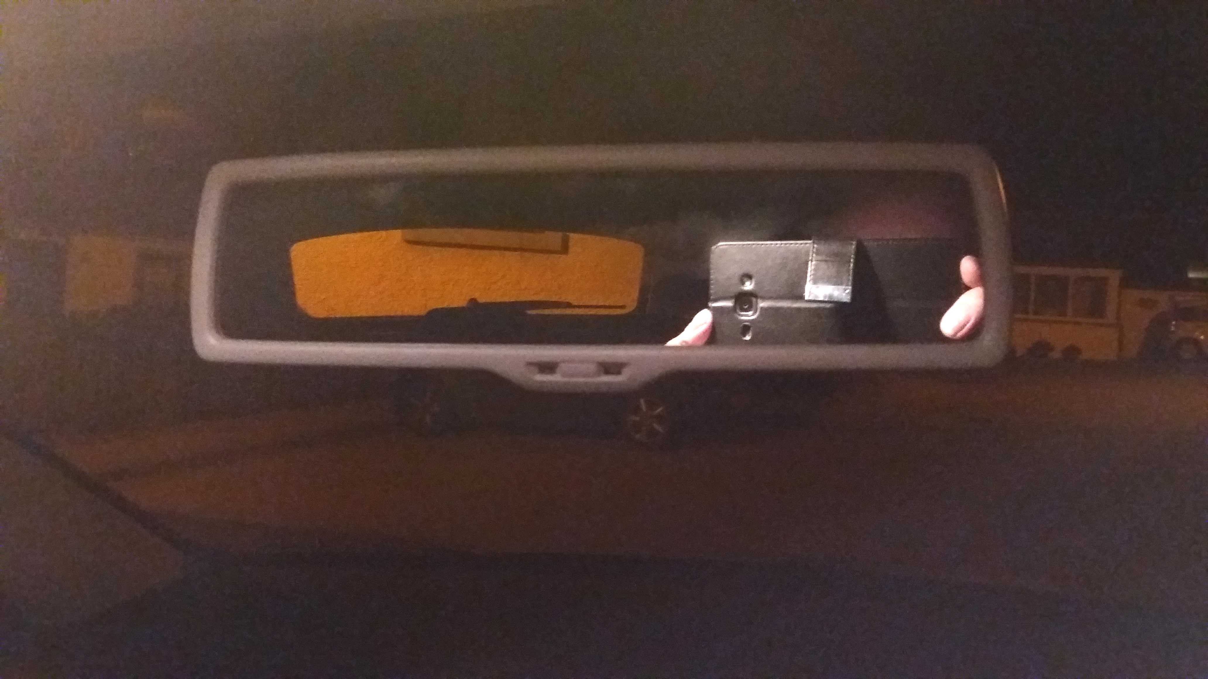

Yep, like everywhere else, no shortage of potholes up here in the Highlands. Not the best shots this time of night and obviously could not use flash in front of the mirror. The nextbase is hidden fully behind the mirror but with enough room to use the menu and settings if needed and enough room to unplug the mini isb to download to laptop if and when required. Need to just tidy up the free cable a little and I always tie the usb cable to the mount with a small cable tie to prevent it crashing about or damaging the socket should it ever break free of the screen. The DVR is completely out of view from the driver side.
Nige

I do like that mount very neat.
