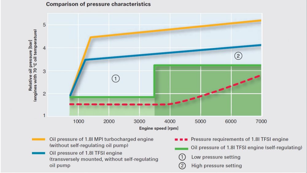

Which engine do you have? The older 1.8 seems to only have a fixed pressure switch that actuates at a set pressure. The newer engine has that same switch, plus another and an oil pressure regulating valve. Barring oil pump problems and clogged pickups there could be an electrical fault in those areas.

The engine is the later one with the 2 pressure switches. They changed both of them, but no luck.
Where is the regulating valve located?
