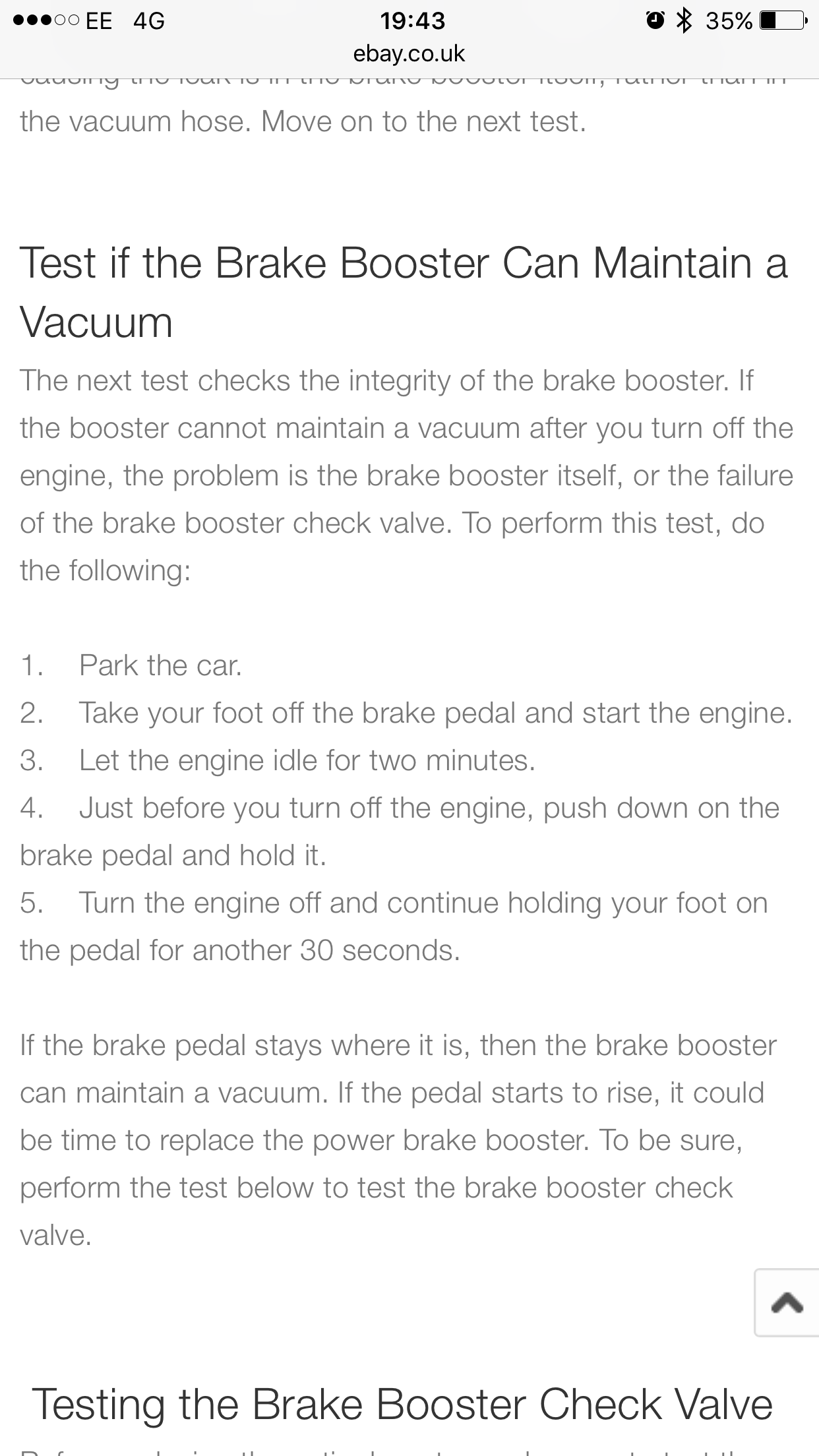

Found stuff about brake booster / servo online. Tried this test and pedal remains down and then when restarting engine returns again.
