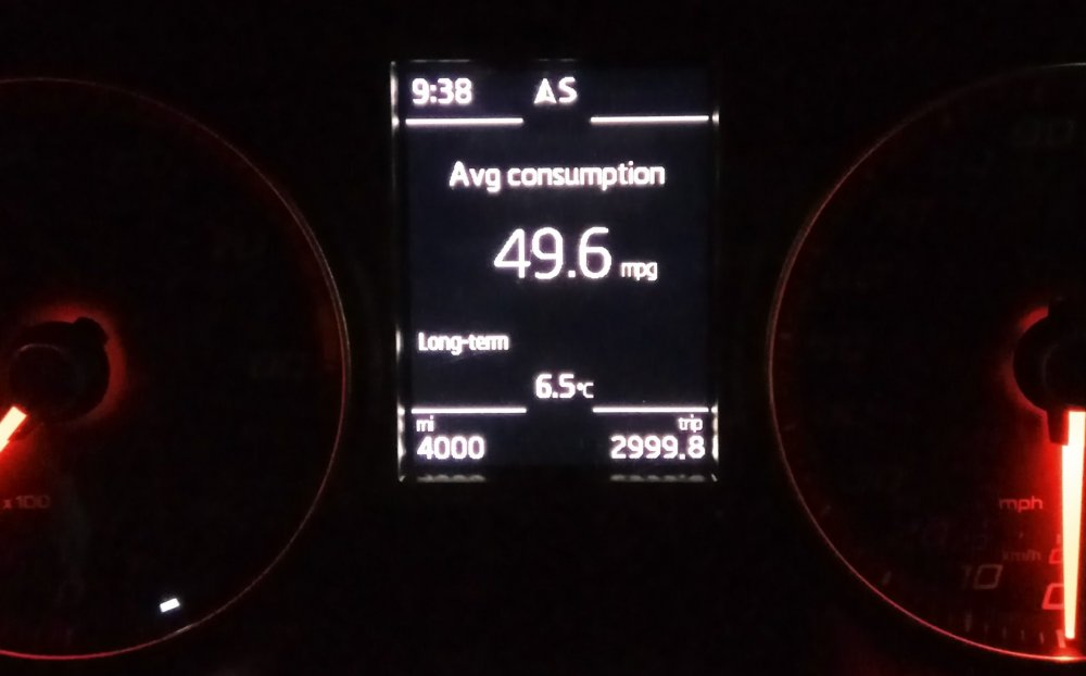

i have around 200k miles covered on Fuelly and have yet to document either a "running in" effect (improvement in MPG as the miles rise), or improvement in MPG on "super fuels".

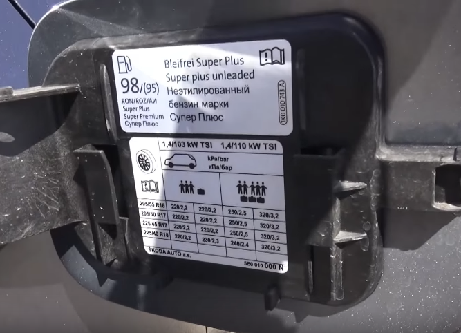

had a look at the filler and it says 95ron, but also says super unleaded. are they simply saying some markets have 95ron as super?

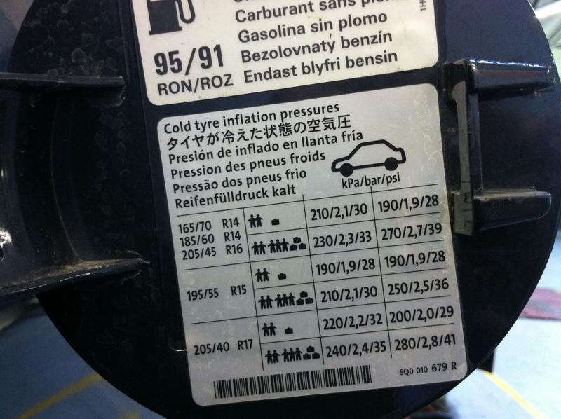

one question in the pics I noticed the last filler flap looks a lot like mine on the Toledo, but the tyre pressures are slightly different is it on a Rapid? also mine says 95ron will running it on 99ron cause any issues?
Read the page in the Owners Manual on Fuel.
Running a higher Octane will do no harm, the 95 ron is the minimum you should run and the minimum there is in the UK anyway.
Other world regions might and do have lower octanes and different Engine Management to suit.
The Red Filler Flap is from a Fabia mk2 vRS 1.4TSI 132-136kw,.  no idea what cars the others are from, just there as an example of the Super / Super plus having a different meaning in Continental Europe.
