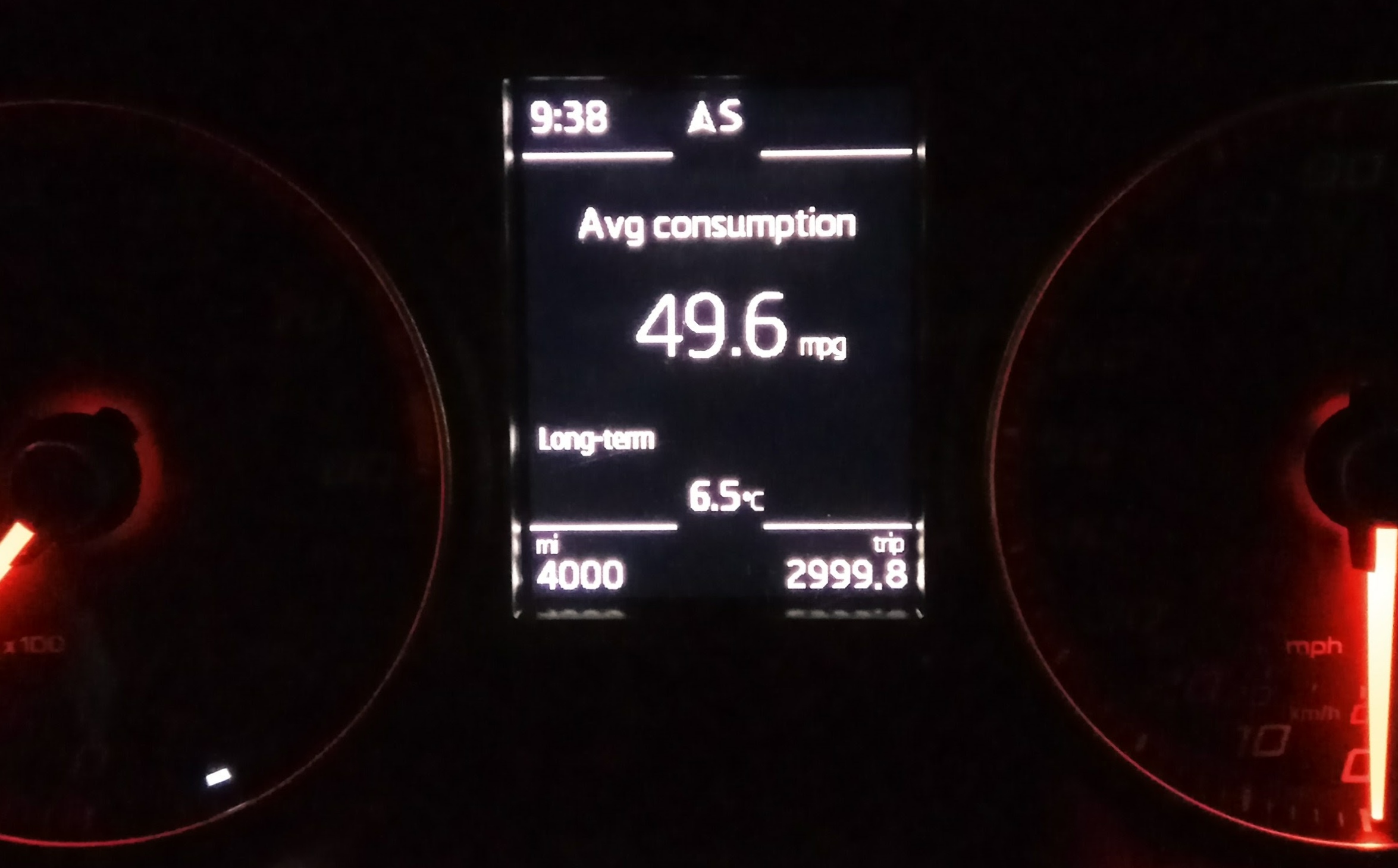

4000 miles in now and no reliability issues to report.
The car is currently running on a set of 15" steel rims / Continental TS850 winter tyres (185/60/15) and rides considerably better (smoother / quieter) than on the OEM 17" alloys / 215/40/17 Bridgestone Potenza RE050's. The speedo hasn't been appreciably affected by this change, given just a 0.4% difference in circumference between the 2 set-ups.
I also compared speed reported by the car to a Sat-nav driven speedo on my phone and found the car typically over-reads by 2-3 MPH, across a wide range of speeds. (20 - 70 MPH).
The car has averaged 46 MPG over the last 10 tanks of fuel (best = 52.3 MPG / worst = 43 MPG). The OBC typically over estimates MPG by 5-10%,  as below.
I've elected to stick with standard unleaded fuel (Esso, Shell and Cost-co), but may throw in a few tanks of Shell V-Power Nitro+ as the miles rise. This will be more for the detergent properties of the fuel, rather than any gain in performance / fuel economy.
