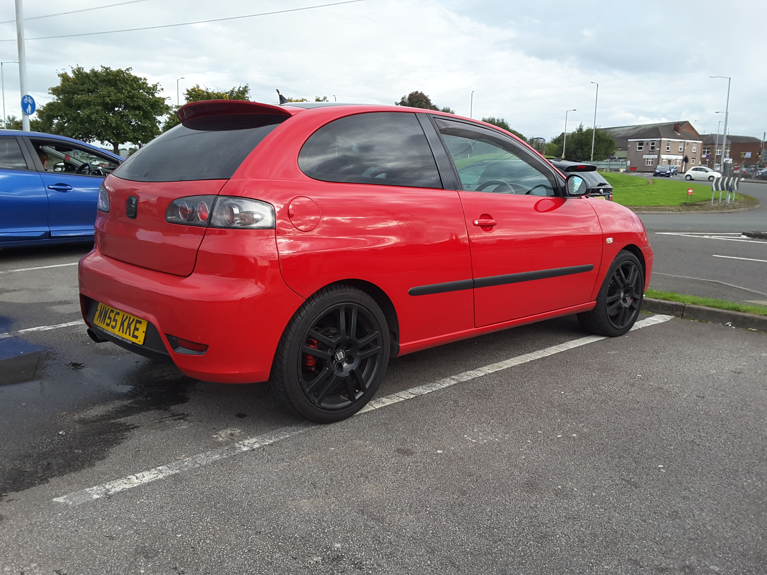

(A picture of the car is attached, it had a seatcupra.net sticker in the window so if anyone knows any history of the car id be very grateful)
