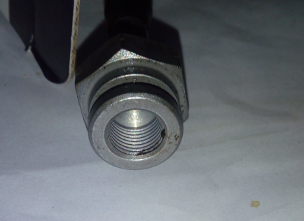

What I found out is that VAG apparently use two types of hose end where they fit to the clip in the body.....
In cross section they are as shown:
By removing the wheel and looking carefully at the end that fits in the clip, you can see the type that you have, either a round
which would normally use a 'C' clip
or one with a flat
that on mine uses a spring clip
that is held in place by the flare nut on the brake pipe, with the cutout on the 'D' preventing rotation of the flexible hose.
Hope this helps :)
