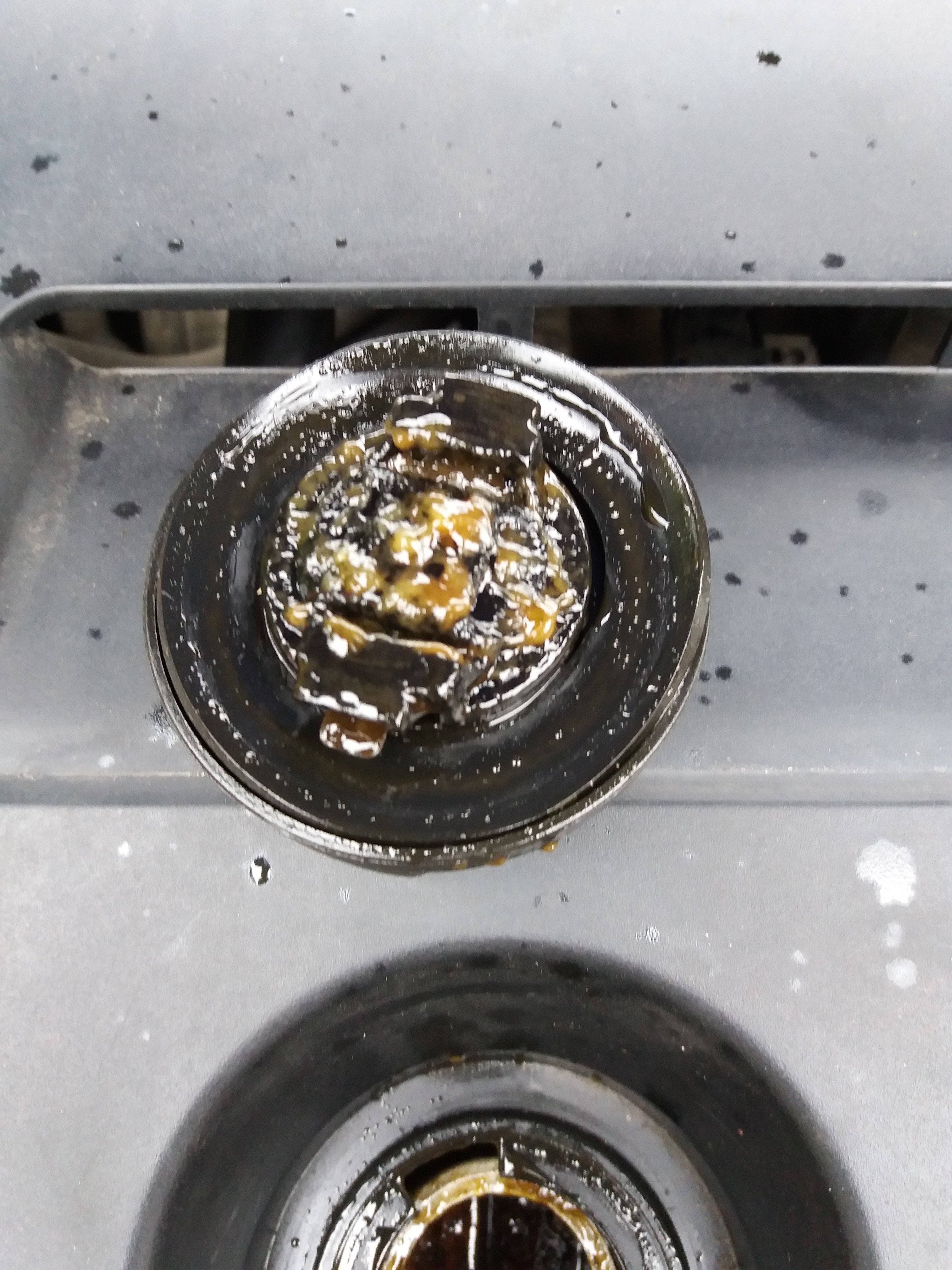

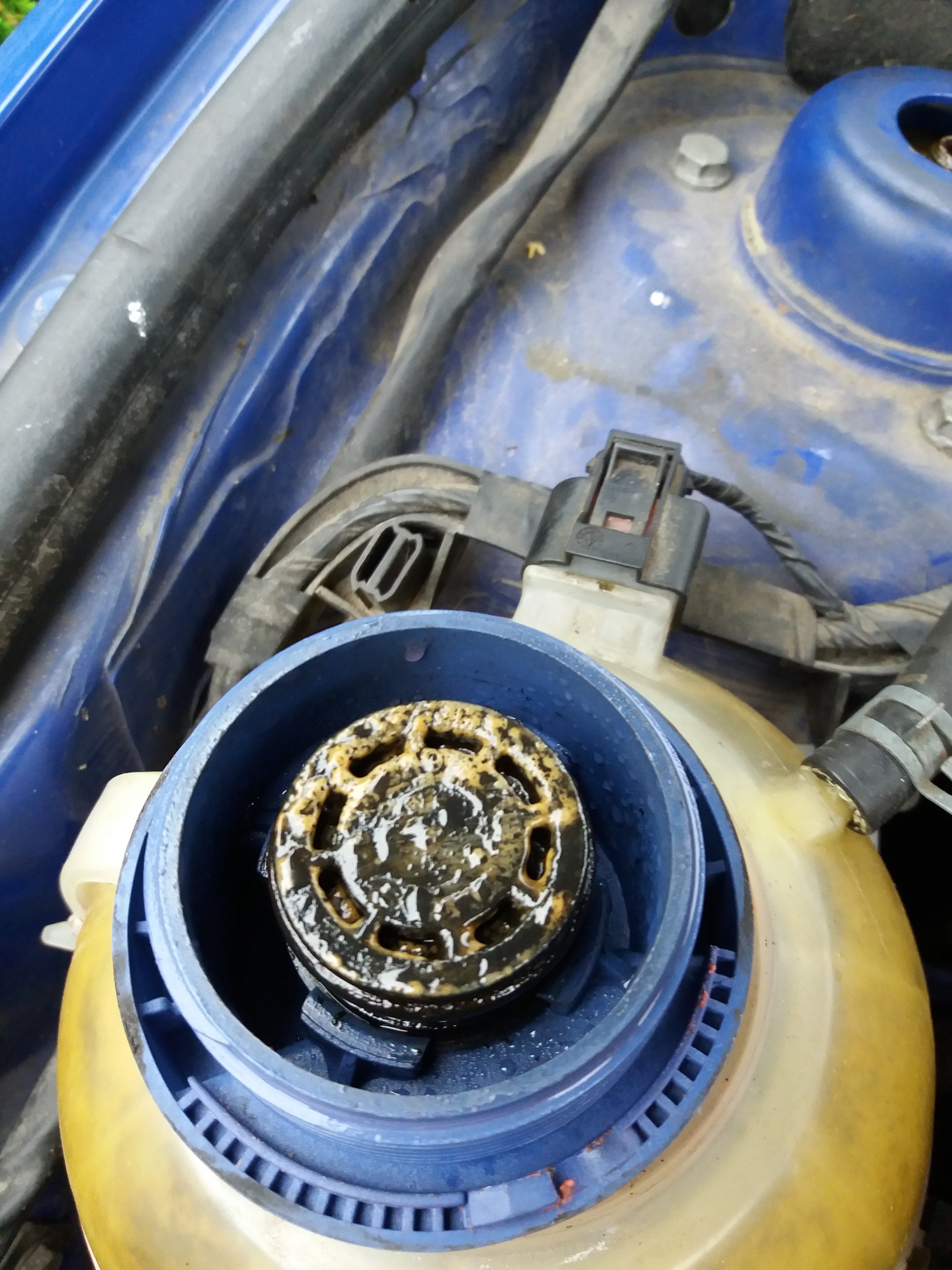

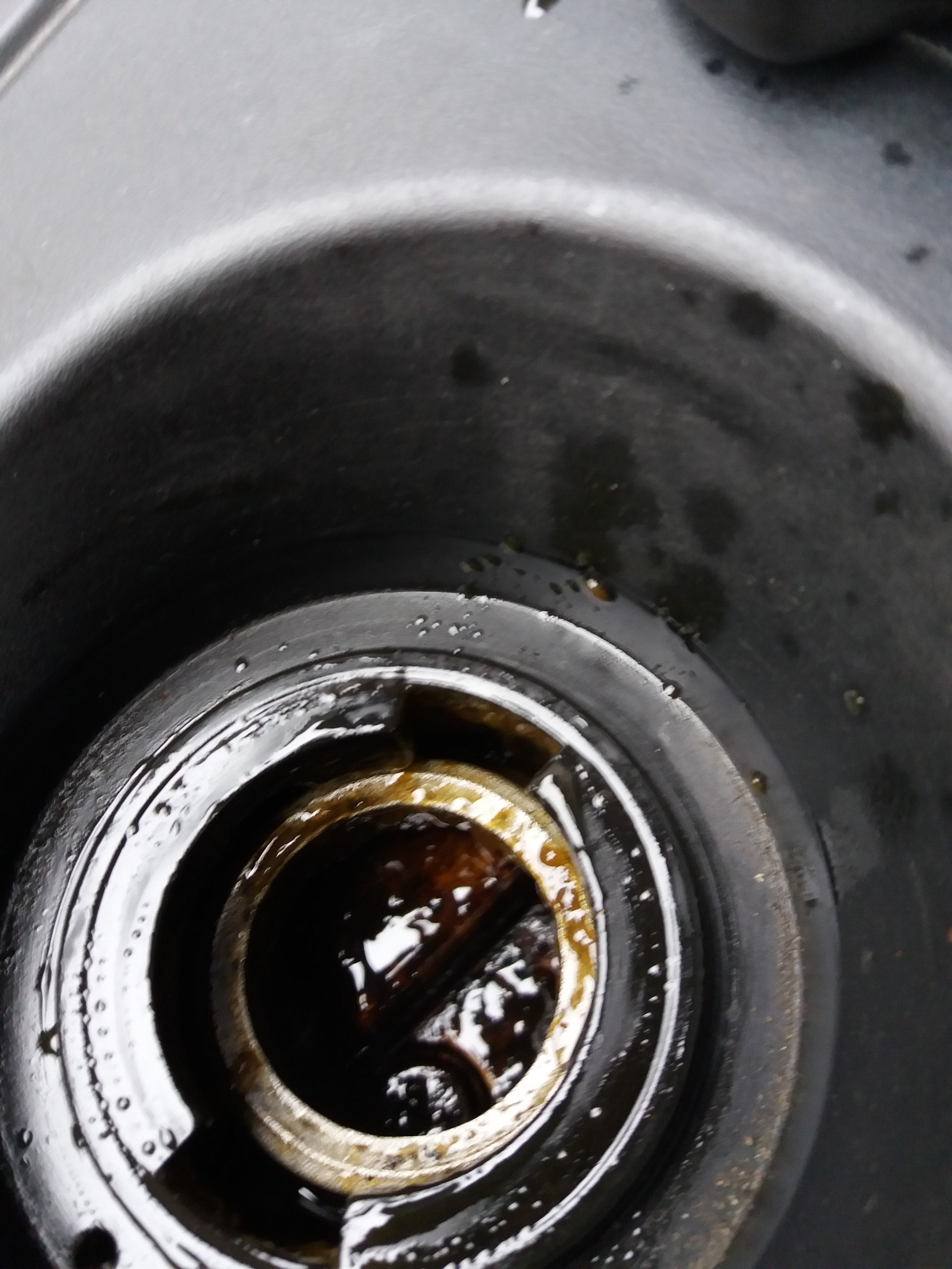

Fabia 1.4mpi 2001. Coolant leak somewhere. Im pretty sure, its head gasket. Yellowish stuff under oil and also coolant cap. I removed oil cap when engine running and a lot steam came out. Its not short cold trip condensation problem.
Oil level OK, coolant fluid pretty clean. No white smoke.
Car mileage is 260K. Worth to repair head gasket? Is it hard to DIY?
I added few pics too.
Yes, very likely to be HGF, not an expensive or difficult job so your call as to whether it's worth it or not, bear in mind you can just buy another one for a few hundred quid, they're not exactly endangered.

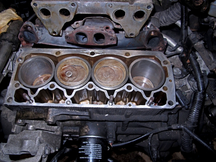

You don't have to take away the manifolds! Just push it backwards ... Easy job, but cheek the cylinder height se manuals. remember to unscrew the head bolts the opposite way than tighten. From each end successive.
