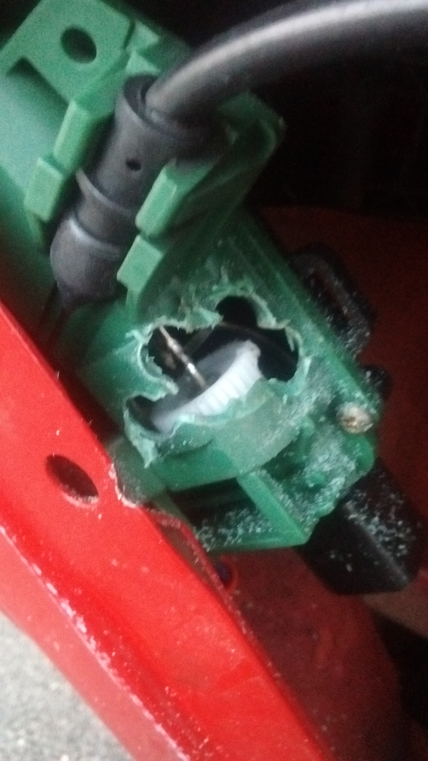

Thanks for advice from all. I removed the card as advised maybe damaging a few clips. I've attached an image of where in the casing you need to drill to expose the cog to turn to unlock. I assume this cog is normally driven by a motor when you click the central locking. Anyway it worked and opened the door.
One question. How did people attach the long arm to the casing? It's like it's too long and you have to put a lot of force and bend it to feed the new mechanism in.
