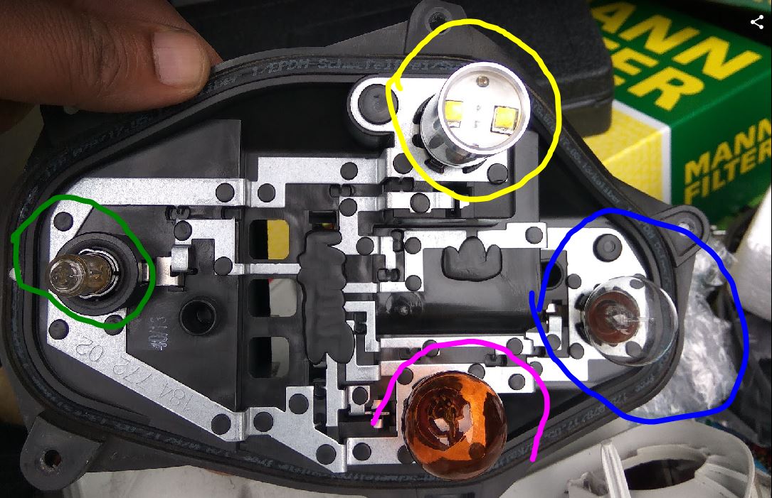

Please give me all the bulbs type for REAR and FRONT if anyone knows them correctly. it could be very useful to other people too. My car is Octavia Elegance (Hatchback) December 2013 1.6Tdi.
NB: I have taken the rear lamp off but couldn't figure out what bulbs is what? ..i can guess amber one is indicator, yellow circled one is reversing..what about others?

Blue circle will be brake light bulb & green circle will probably be the fog light bulb.
@automass - turn it over, you'll probably find each bulb type stamped in to the plastic casing on the other side.

At a guess....
P21W - blue
P21W - yellow
PY21W - purple
H21W - green
If you want confirmation, go and take a look at your car B)
Or RTFM :D ;)

Both the link posted by nige8021 and my earlier post answer that question.

Are you asking what function each has? Batvanvrs answered that for you in the first reply.
Indicator - purple
Brake - blue
Fog - green
So,which one is called tail light?
I think there are normally two W5W bulbs that are used as the tail light, these are not included on the carrier you pictured. It might also use the brake/fog lamps at a reduced brightness.
If you want to check, go to your car, turn the tail lights on and see which illuminate ;)
Thats right..it is specified on the body.
