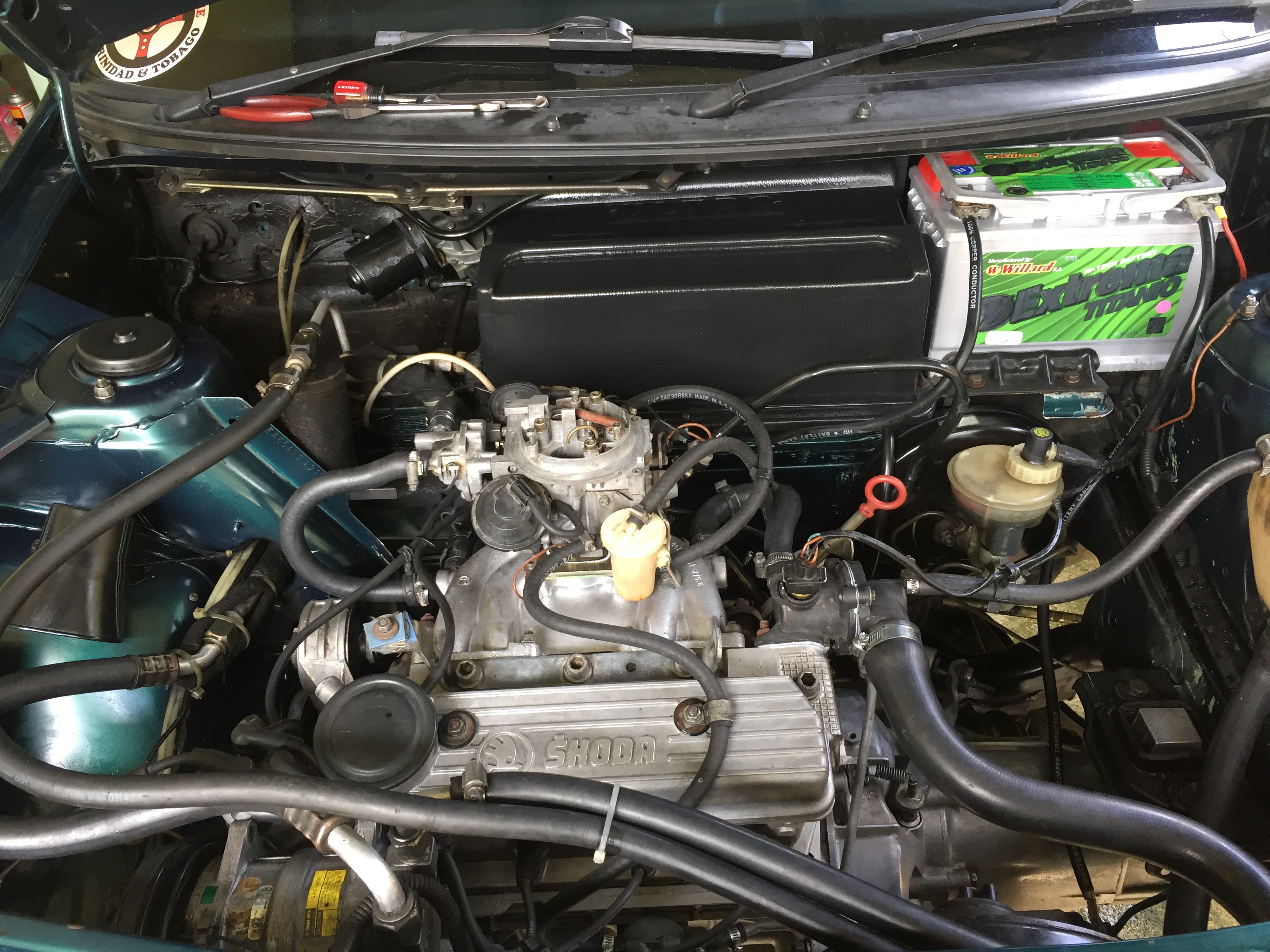

Where can i get a carburetor 48D18455-6E73-49C2-9FF2-46B313AEDA80.thumb.jpeg.01cbf1f8f086d0534fe7d98dfaa51b08.jpeg
What is wrong with your existing carburetor?
Every time i start the car it keeps cutting off im from trinidad where that vehicle doesn't exist anymore so im not getting any parts
Are all electrical wires connected properly to carburetor? I'm referring mainly to the wire that feeds 12V to electromagnetic shutoff valve. You should hear a click inside it when ignition key is to on.

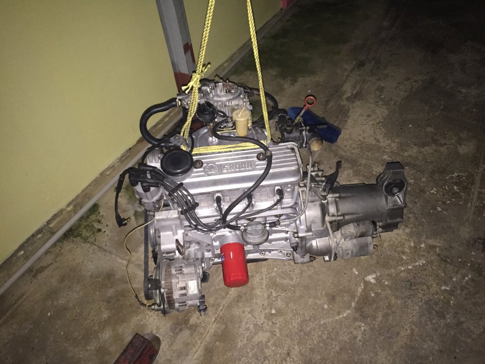

Well it started off when i was driving in traffic about a year ago in traffic it cut off an i have to throw gas into d carb for it to start
I would check the fuel pump first.
Well since i put back the engine an change all the hoses an thing i didn't get that problem

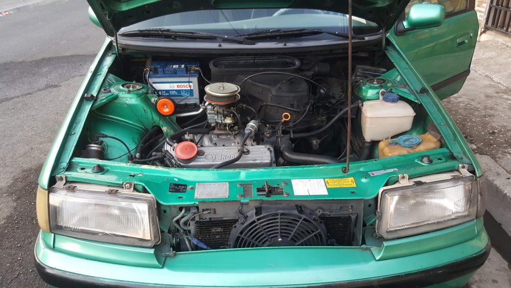

I had a lot of problems with that carburetor, I had it repaired a few times but it was damaged again. In the mornings I didn't catch it drowned, it covered. What I did was adapt a Datsun 1,200 carburetor and it works great. I have a skoda Felicia 1.3 year 1999 with air conditioning
