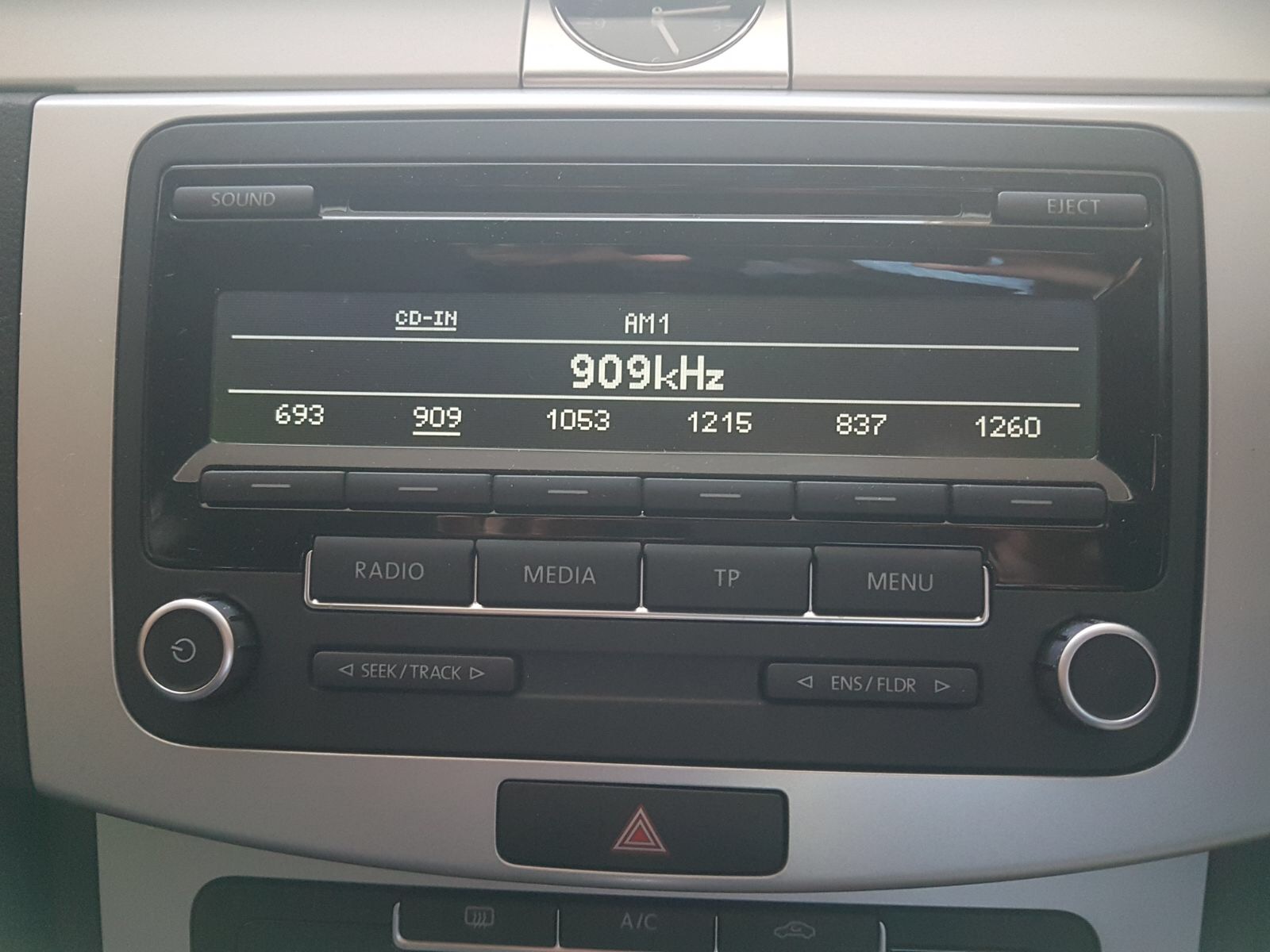

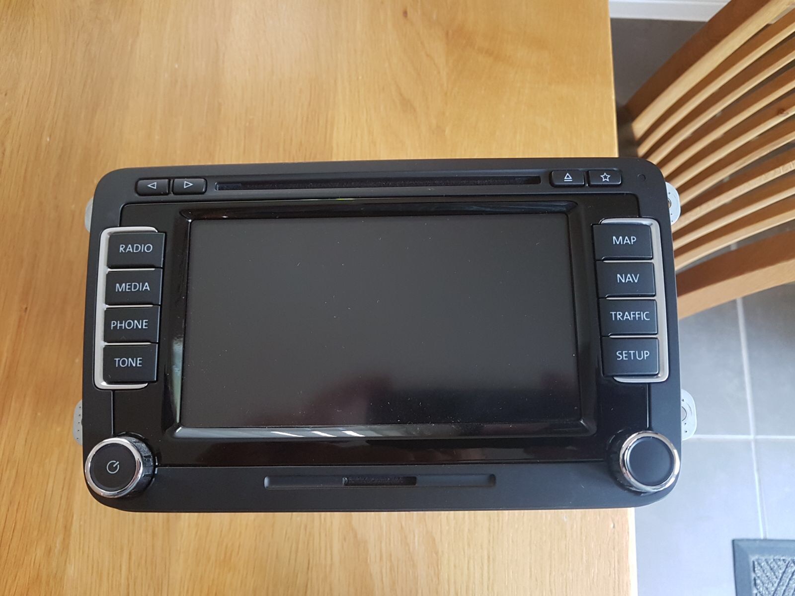

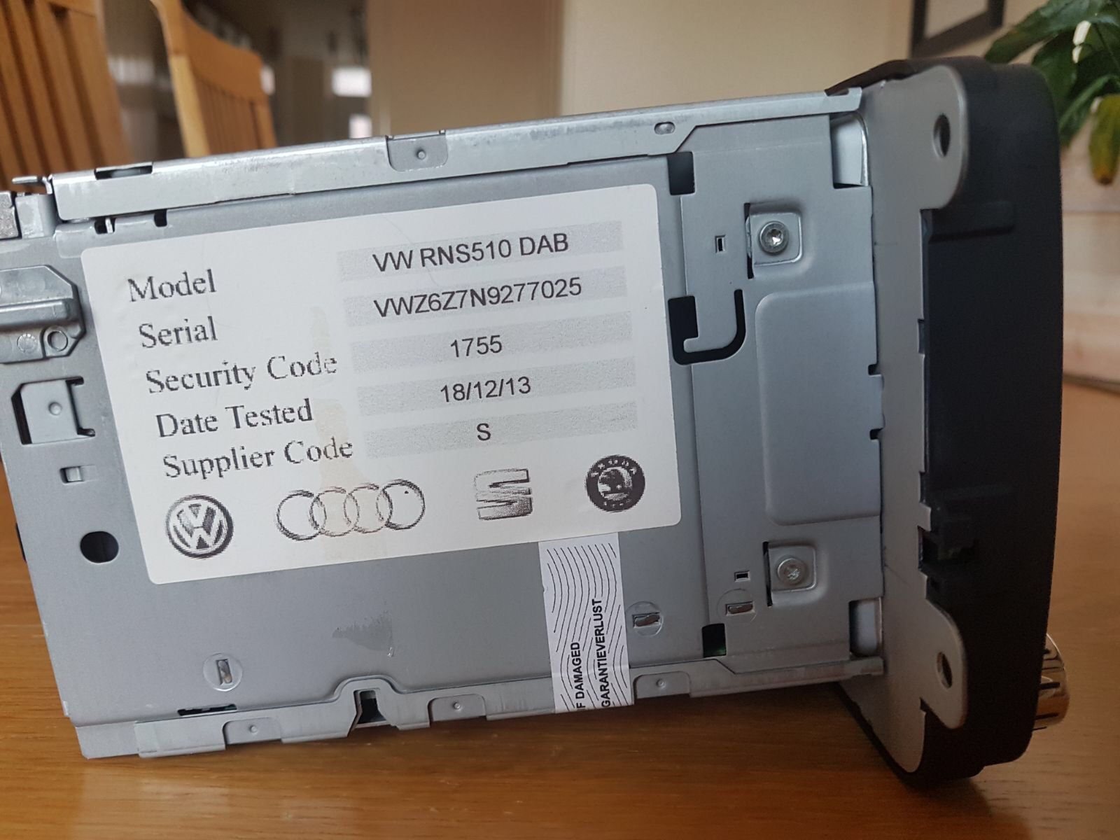

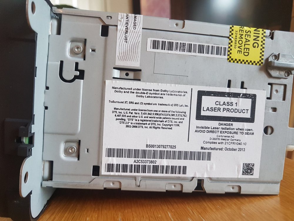

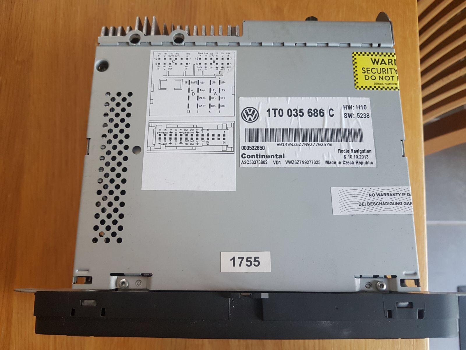

New unit pictures and old one also shown for reference.
The current unit is a RCD310 if it helps
