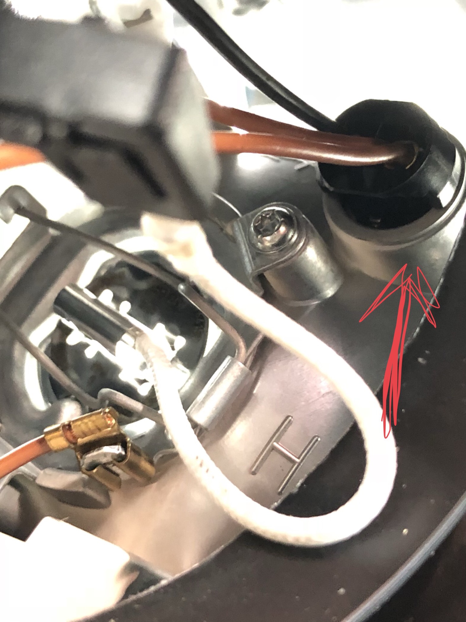

Ohh deer, i cant change this small lamp, my hand is too big.... should i look for a child that can change this or can You plz tell me if i should simply pull or rotate before pulling?
many thx for hints : )
it's very hard to dislodge. I ended up using a flathead screwdriver to lever it out.
