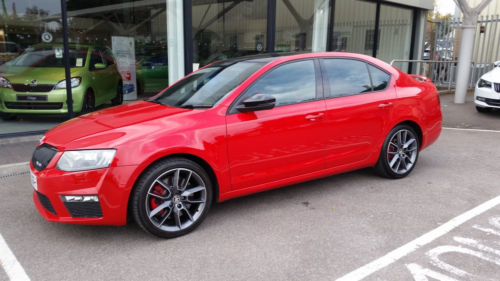

I'm not complaining about the hard suspension - it's fine when I'm in the car on my own but passengers in the back complain quite a bit - mainly my daughter. Really miffed as I always ask "is everyone happy with the car? Is there anything to stop me buying it?" But no-one says a thing. So, what I'm asking is are there any good adjustable shocks out there - soft for family trips but then hard again when on my own?
I must admit my other car - a Mazda mx5 handles fantastically but still has a MUCH softer ride than the VRS. Any advice appreciated

Looks great.
Must assume the transit blocks have been removed, check incase not.
