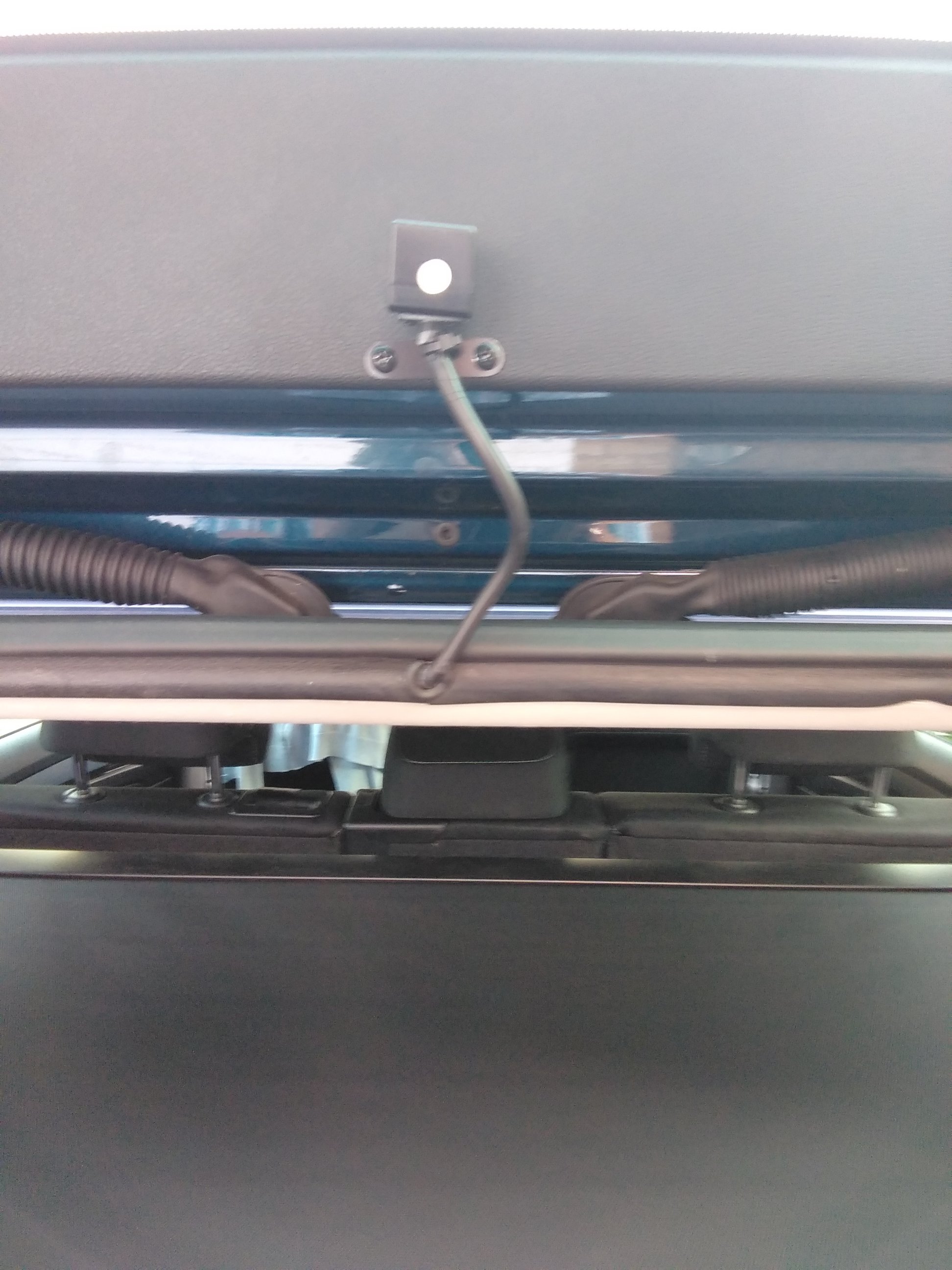

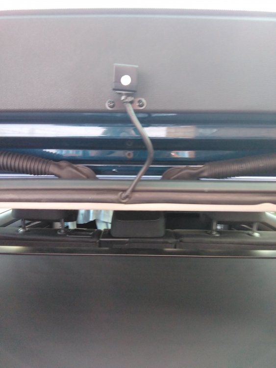

@Badge - i'm toying with fitting front and rear cams on my scout. out of interest where have you placed the rear cam?
I put it at the top of the window close to the washer jet corrugated hose, the metal lip that holds the boot seal was relieved to allow the wire to fit to the camera. Its a cheap £30 full HD camera from eBay, seems to work fine, and the tiny cube rear camera is inconspicuous.IMG_20180726_173620.thumb.jpg.3c8efe470a0e939606327f73ae4f0238.jpg

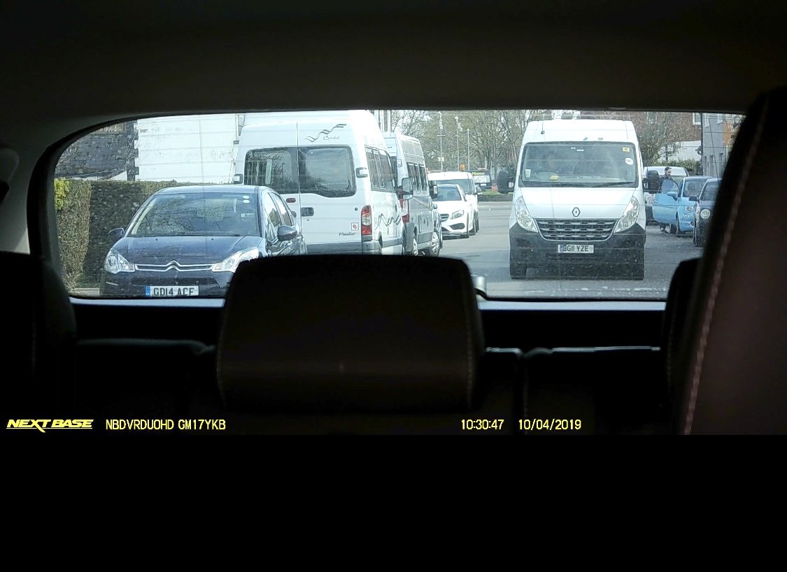

Hi, here’s a screen shot from the rear camera view a few days ago, yes it’s not perfect but for me good enough.
THANKS
No worries - it just saves the hassle of another unit plus wiring etc in the rear.
B.

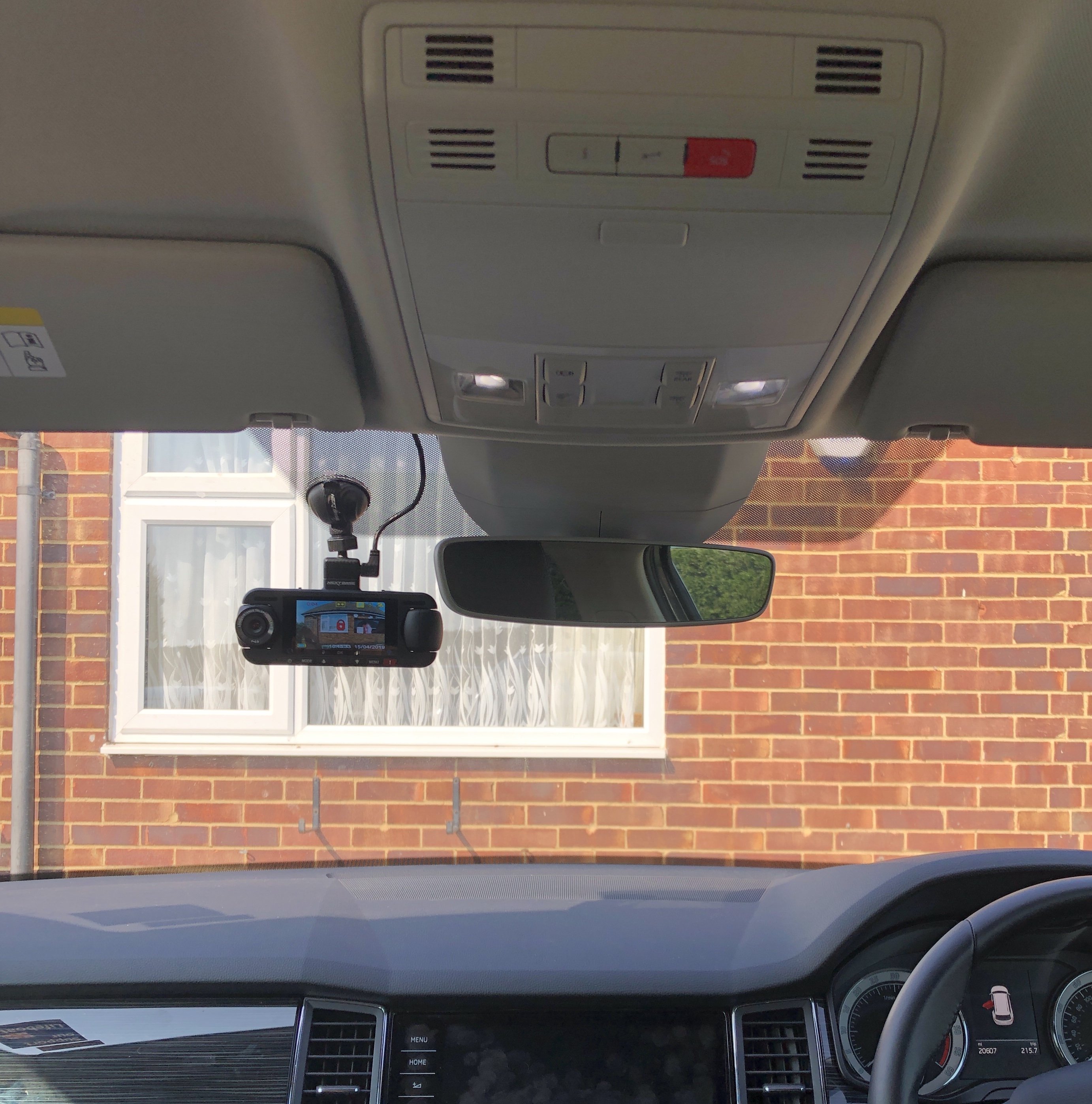

How did you mount it?
To LHS mirror - at top? or RHS Mirror?
Any mounted photo?
THANKS
Left of the mirror.
