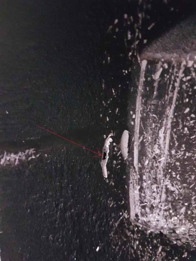

I the flying steel parts caused a small 3 x 2mm slot on the house of gearbox side which common with clutch.
I noticed some oil leaking, a small oil spill under the car.
I went to the service center, maybe should replace some seal, but I surprised when show me the what is the result of the small leaking.

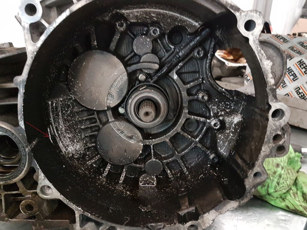

Here are two image one of the slot on clutch house the another is the clutch house.
Maybe this slot can be welded.
Edited by ujtordai

That was like mine but without the hole.
you can get second hand boxes cheap or liquid metal it :) . i changed a DMF on a 306 hdi and that had the stops broken off and was causing the whole assembly to wind out the spring and start rubbing the housing like this

i used JB weld on my 6 speed where the rubbish cast filler port of the gearbox was cracked after tightening a small hair line crack appeared, so i filed a v along the crack,  then used brake cleaner to remove all the oily residue and has not leaked a drop since then. the alluminium on my 02m box is horrible, threads pull out of cast like butter, thankfully recoils are cheap. but anyway i got it from a scrap dealer for 100 bucks with transfer box.
