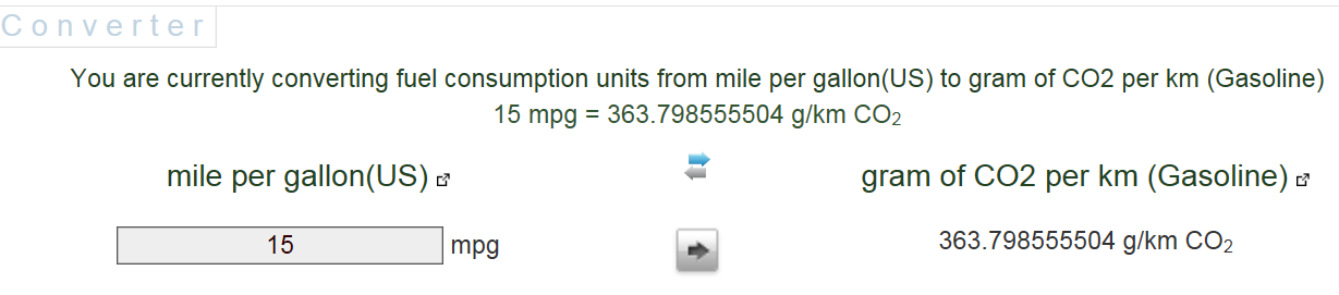

Just tried again to work it out.. I cant figure it out

Not as bad as I thought then !

Pretty good considering the size of the thing, and the size of its engine. :D

I understood this to mean what you actually experienced from driving it, either by displayed mpg or calculated from pump quantities versus distance travelled?
The unit converter I suggested worked directly off that to give the g CO2/km figure.
Nothing to do with official figures, offski?

Measured fuel consumption tells you exactly the quantity of fuel consumed by the vehicle. It's a figure that can be directly compared between two vehicles: if they both have the same measured fuel consumption over the same distance, they both used the same total quantity of fuel.
OP's measured average for the trip was 15 mpg (we'll assume US gallons since it was in the US), over a distance of 850 miles. Divide 15 miles/gallon into 850 miles and we get 56.67 gallons; multiply this by 3.78 litres/gallon and we get 214.2 L of fuel used for the trip.
From here it gets a little murky since petrol's allowable density varies, as well as its chemical composition. For the sake of the calculation, I'll use a density of 0.755 kg/L and assume it's entirely composed of octane (C8H18).
214.2 L multiplied by 0.755 kg/L gives 161.7 kg of fuel. With the molecular weight of octane being 0.114 kg/mol, we have 152.1 / 0.114 = 1419 mol of fuel consumed.
Now for the chemistry bit: C8H18 + 12.5O2 -> 8CO2 + 9H2O. So for every mole of octane burned, 8 moles of CO2 are formed. Burning 1419 mol of fuel results in the production of 11348 mol of CO2.
CO2 has a molecular weight of 0.044 kg/mol, so 11348 mol equates to 499 kg of CO2 emitted over the total distance. 850 miles = 1368 km, so average CO2 emitted over the trip is 365 g/km. Close enough to the value given by that website converter: given the assumptions being made that's pretty ok.
Consider though that petrol engines tend to operate richer than stoichiometric i.e. not all of the fuel that is consumed is burned, some of it exits the tailpipe unburned. A further portion of the carbon in the fuel exits as soot. These losses are tricky to estimate since they depend on operating conditions such as load, ambient temperature, etc. and these conditions are likely to have varied during the 850 miles travelled.
I've also made assumptions about the density and composition of the fuel which are going to affect the result, but right now it's more effort than I can be bothered making to see whether that pushes the estimate up or down.
